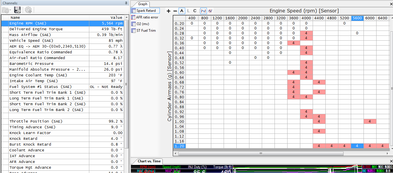

Old Jun 8, 2020 | 05:58 PM

Oh if you're on E there's no way that's real. Have you tried logging all the other spark pids to confirm there isn't something else pulling timing? Burst knock disabled? How do the plugs look? Something else you should do in the tune is crank up the recovery rate. It stops a single instance of knock from pulling timing for a long period of time and narrows down where it's actually seeing knock. You can also chop the knock attack rate to minimize the intrusiveness.
I will look into what have you have mentioned here.
While looking at my logs, I noticed, as soon as my A/F commanded goes from 10.45 to my PE A/F of 8.17, that's exactly when I get the 4 degrees of knock retard.
The scan reads like this as I click :
3393rpms, 10.45 a/f, 0 KR
3420rpms, 10.45 a/f, 1.4 KR
3460rpms, 8.17 a/f, 3.6 KR
3502rpms, 8.17 a/f, 4.0. KR
And continued with 4 degrees of KR up 6000 rpm.
