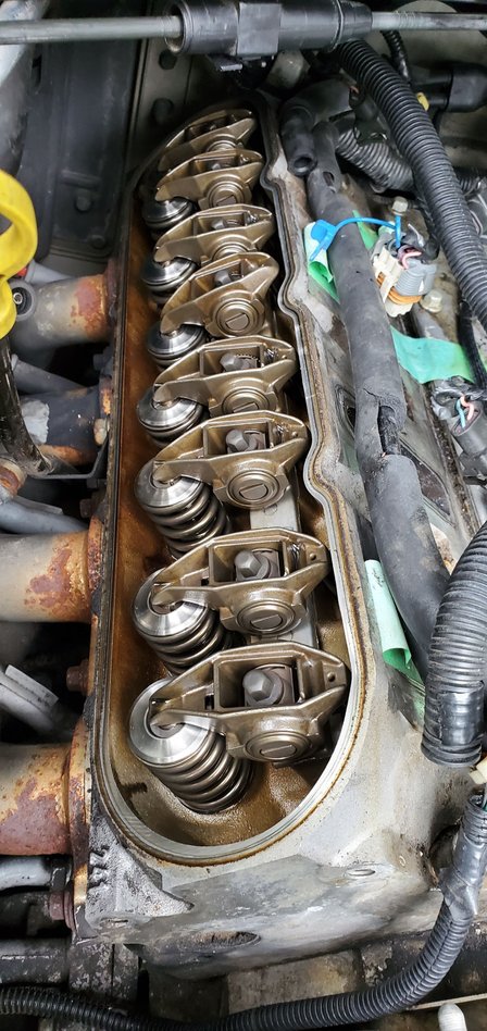

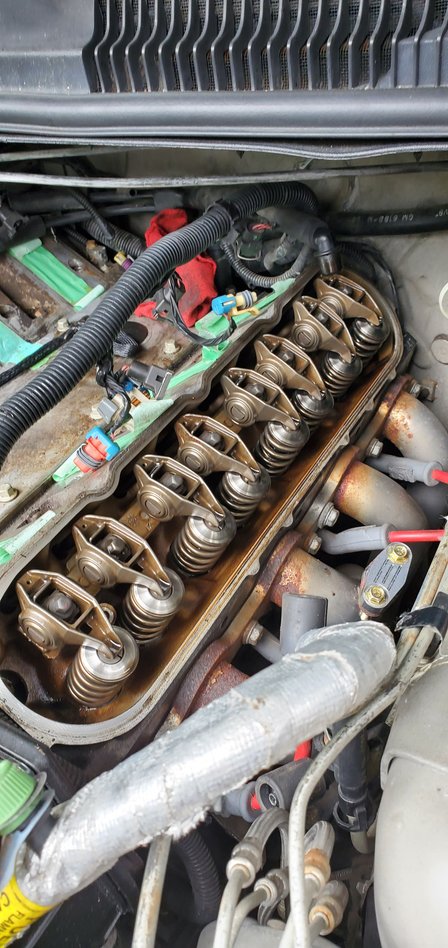

I think I forgot to mention, but it smokes like nobody's business! A very white smoke at that. I'm at a loss guys. It ran (rough) when I bought it, I drove it home, and haven't really been able to drive it sense. I did find out that the guy I bought it from was driving on a "start" tune. It was wired for Nitrous, but It looked like my 6 yo wired it, so I removed it all. I've been working with Casey from Texas Speed, but he can't really help me if I can't get the car to run long enough to get a read. I've replaced the PCM and loaded the previous tune sent by Casey (based on mods completed) and it still does the same thing. A friend told me to remove the valve covers and check the rockers and springs and as far as I could tell, everything was kosher. All of them were tight and nothing was loose. I'll keep you all updated. I'm going to check the coils soon. Thanks!
