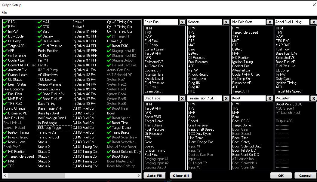

Have you gotten anywhere? Are all the lights green on the unit while cranking? I believe you can do a cranking log on it to help troubleshoot it. Just make sure your logging the correct stuff, and post up a log.

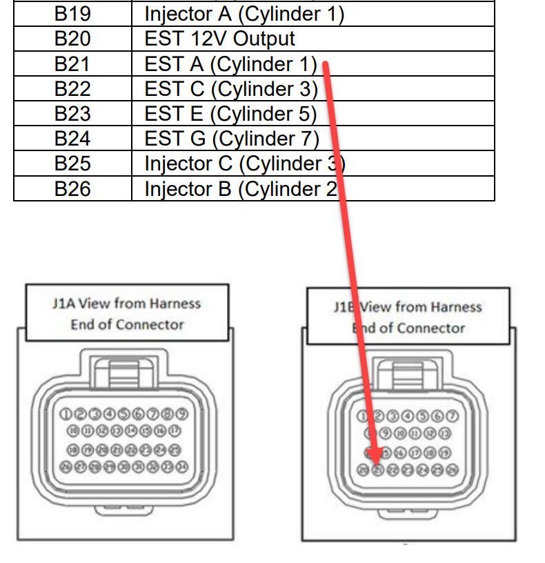

Still having the issue. Just continuity checked according to the document below and everything seems to be in the correct order. Also check power on cam an crank sensor. I believe the crank sensor is good because that's how the holley software/LS engine derives the rpm?
Great idea about the data log! I'll check try it out sometime this week. Thanks!

Didn't find anything too obvious that would help me diagnose this problem from the data logger.
