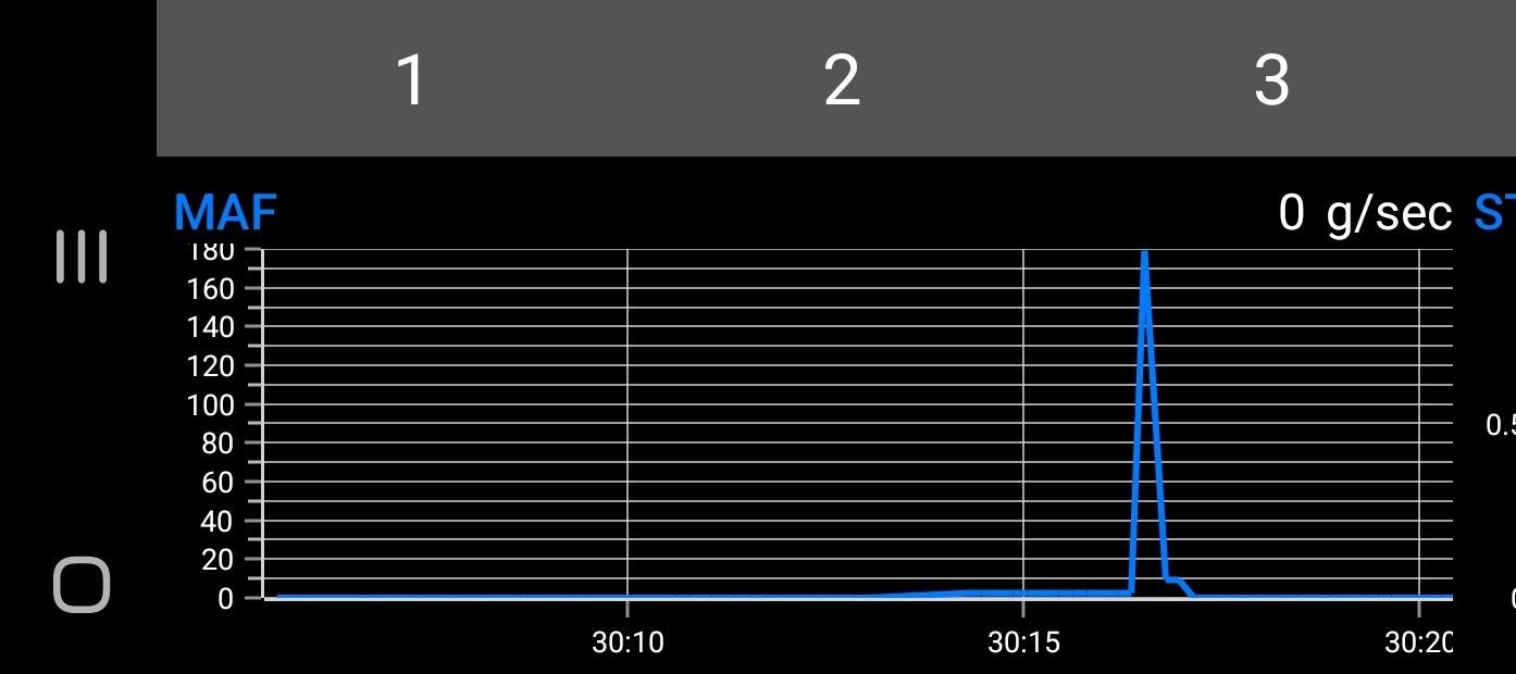

Ok, I can attach this graph - not sure how helpful it is. Just shows the MAF spike

Would be interesting to see your system voltage when cranking. Can you log that?
Old Jul 18, 2022 | 09:55 AM
Posts: 22,291
Likes: 3,616
A spike like that looks like an electrical fault somewhere, like an intermittent bad connection.

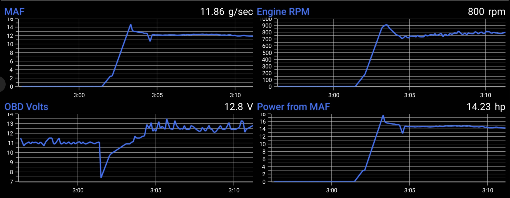

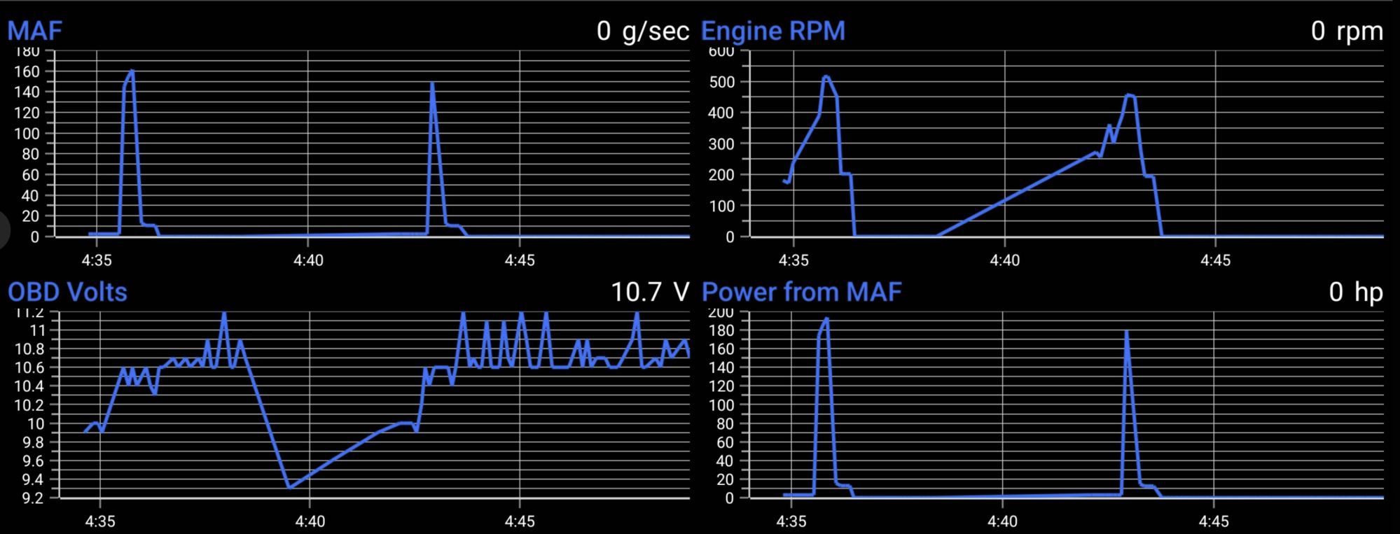

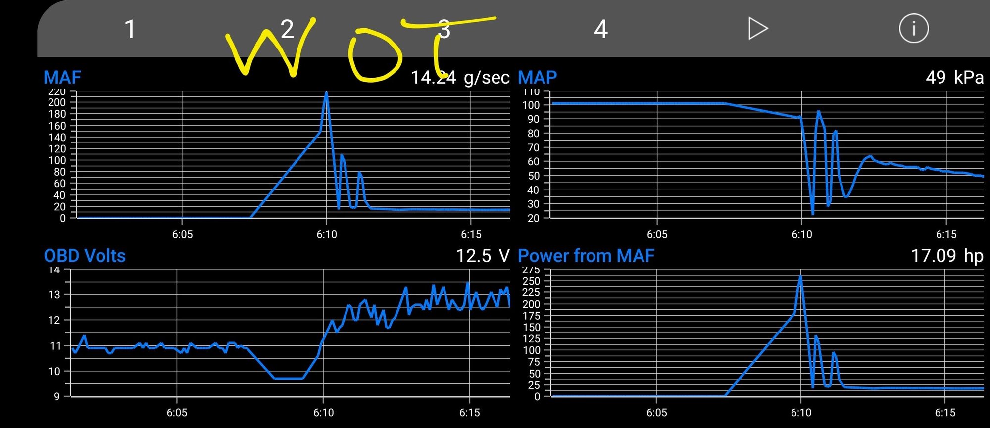

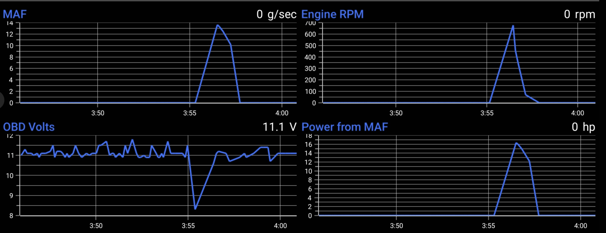

Here's some graphs:
MAF plugged in (no start)
Back to back no starts
This is after it sat for 24hrs - randomly cranked right up (MAF connected)
This is the WOT start technique (MAF connected)
