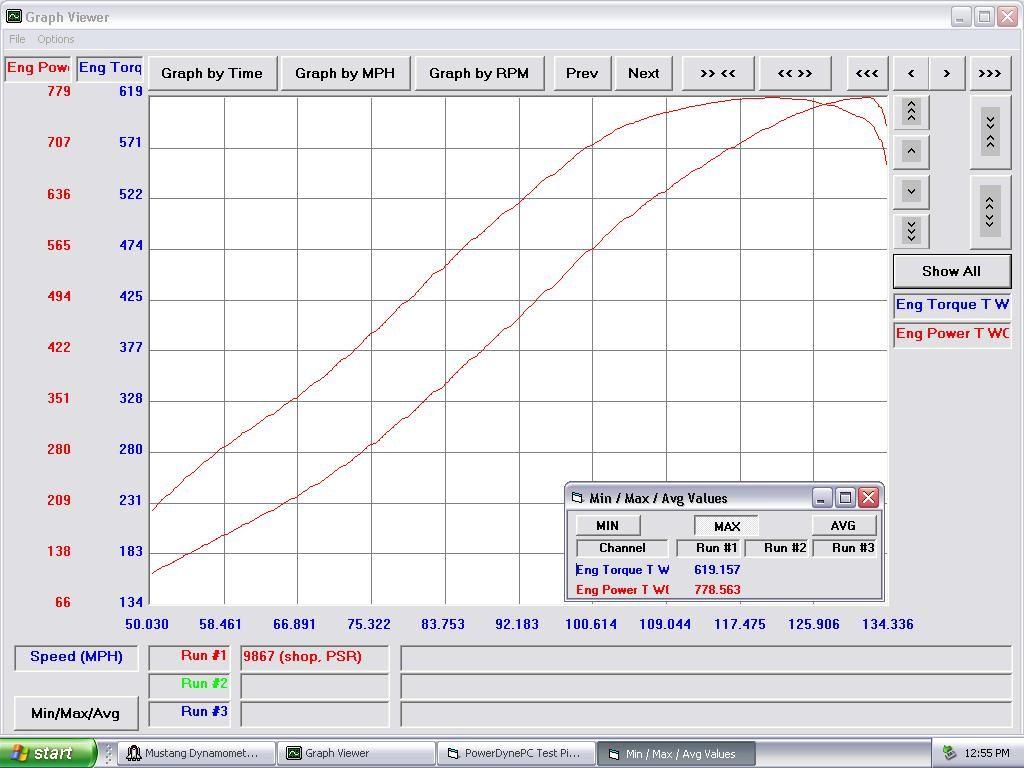

This is the dyno curve he sent me. It just confused me that both are in red lol

That dyno graph is in MPH. It would be alot easier if it were in RPM.

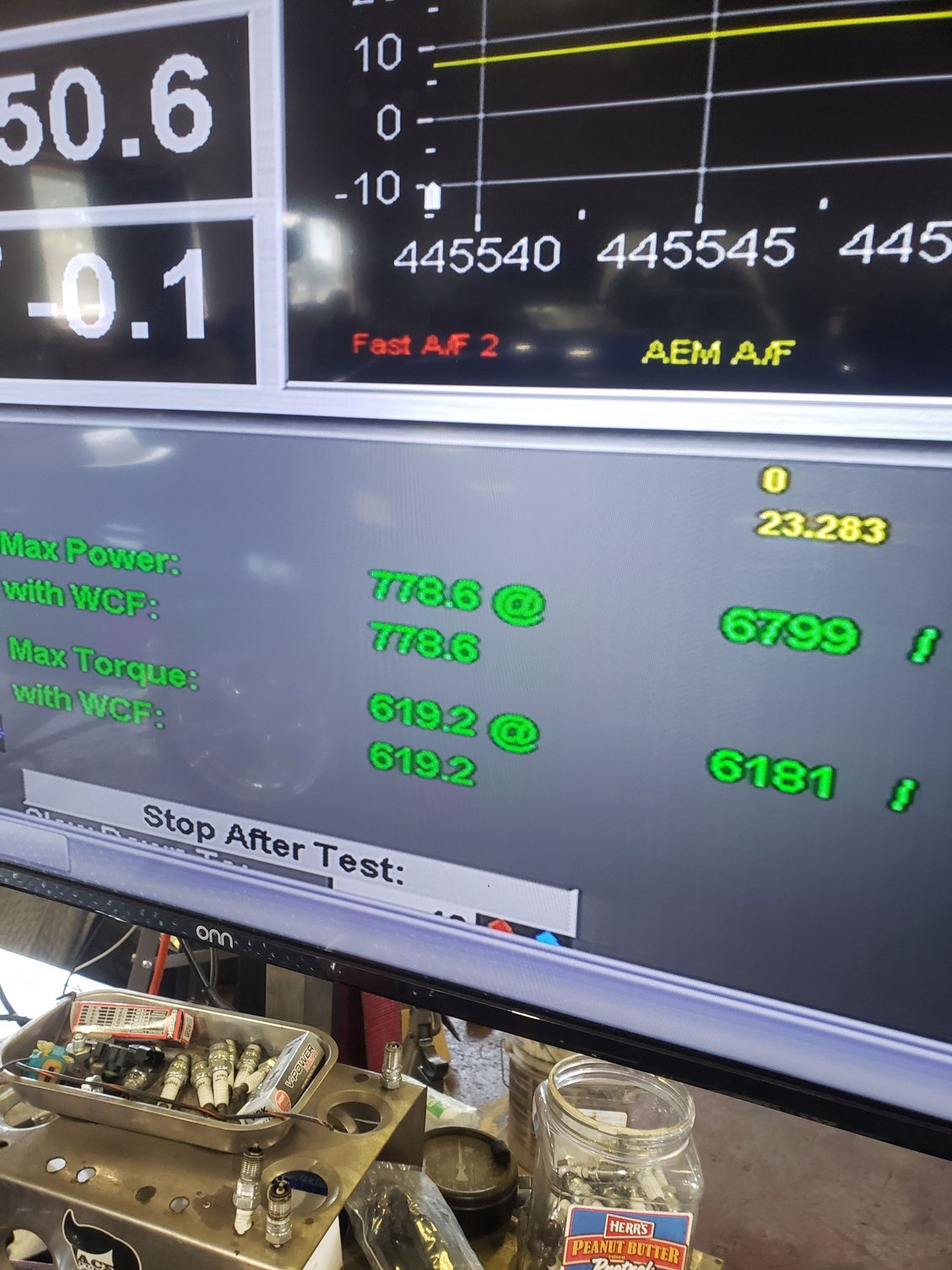

Agreed, thats why I posted the first picture, because it's all I had with RPM in it.
The pic showed power and torque at a given rpm. We need the whole rpm curve.

I know lol but those are the only two pics I got from the dyno. So best guess and SOL on more actual data lol.
The tuner sent you a pic of the dyno run in mph and there's literally a button that says graph in RPM. Tell him to click the button and take a pic. lol.
