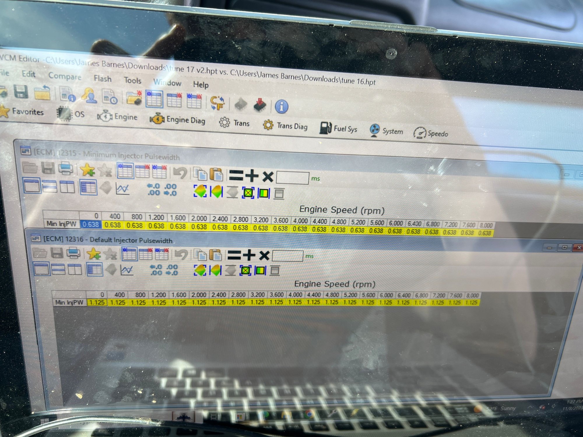

I MAY HAVE FIXED IT! Woohoo. I took 20% out of the min and def pulse tables. I’m now seeing 1.3ms on decel. Obviously +20% lean now as I butchered my ve going on the bad data. Haha. What’s really odd to me, however, is on my logs as soon as I would open the throttle up it would allow my min ejector pulse to bottom to 1.6ms and thus making me stupid lean under any throttle. For anyone else, I’ll post my min/default values here, this fixed my issue. I’m running 60PSI base on a 1:1. 8AN feed, 6an return dead headed setup

Im not super sure on it, since it basically locked me rich and caused a severe lean tip in, however it may be worthwhile to tune it in to help transients if you have a big cam running SD like my prior one. It had really shitty VE resolution in low rpm so when i got the MAF out of there it was a nightmare between idling and 20% throttle I only saw a kpa change of 2-5 until i got to 1600ish rpm lol. But other than that, im not sure what it would be for, all it did for me was **** up my VE table and prevent my O2 sensors from doing their job. Oddly enough that was widely posted injector data that has been posted on this forum multiple times, I never could get the decel to lean out on my prior cam but my dfco covered it usually. glad I figured it out, also this is my tune and logs that go with it. First time ive really pushed the car up into higher rpm for stft tuning, glad it was kind of close.
