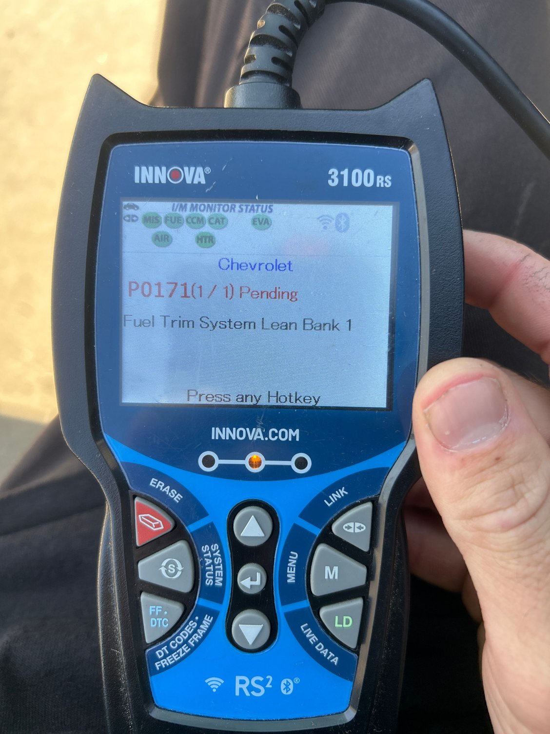

Does your tuner agree with the way off fuel trims that the dealer saw?
Old Dec 12, 2025 | 05:57 PM
JoeRJr's Avatar
Joined: Jul 2018
Posts: 76
That'd be the first place I looked too. If your fuel trims are that far off, it's probably not going to run well.

My understanding on the trims is its throwing too much fuel but this code says its lean? Let me know what you guys think.. ill double check any exhaust header leaks today as well

Your taking an engine/trans swapped vehicle to a dealership?
Have you verified you dont have any vacuum leaks?
what maf are you running?
have you verified injector data in tune is correct?
do you habe 58 psi fuel pressure?
are you o2 sensors reading correctly?
Your tuner should be able to help you with things of this sort, if he cant then you need a new tuner.

Old Feb 24, 2026 | 05:28 PM
626Foo's Avatar
Joined: Dec 2021
Posts: 50
From: LA
Forgot to wrap up the thread but ended up tuning the car to run in open loop for the time being the wiring in the 02s is messed up hence why once it got hot it started dumping a crazy amount of extra fuel stalling the car out
