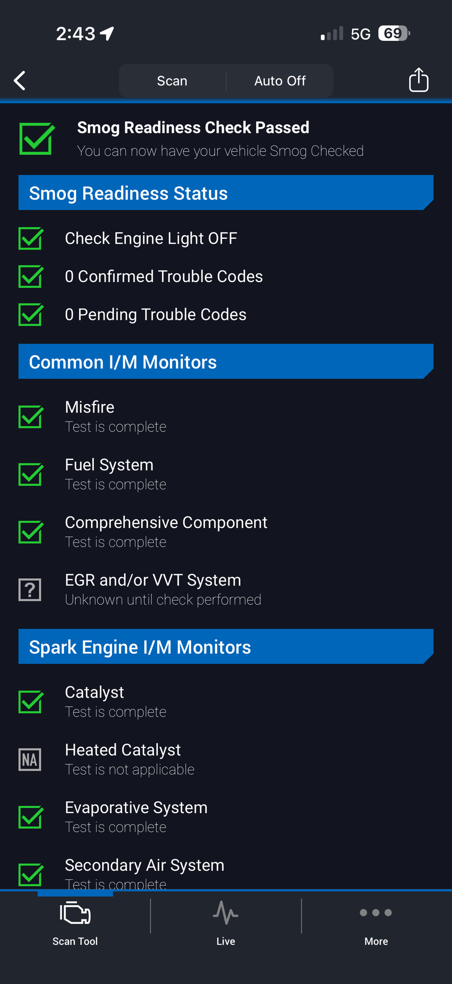

LTFT were at 0 as it was learning still (cars running fine). Had maybe 120,130KM on it. I did the EVAP service bay test to push monitor to ready - passed, and went ready.
