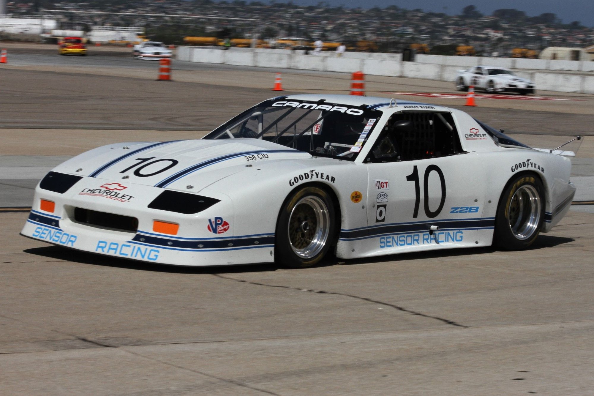

Just entered this Camaro in the 2022 Monterey Reunion.
Then picked up this fresh 358 with only dyno time.
It is period correct and makes a little over 600hp like they did back in the day.
This Camaro was built and campaigned out of New Jersey by Jerry Kuhn.
Jerry raced in 15 IMSA GTO and Trans Am races in '88 and '89.
That history of professional racing qualifies this Camaro for historic racing at the Reunion.

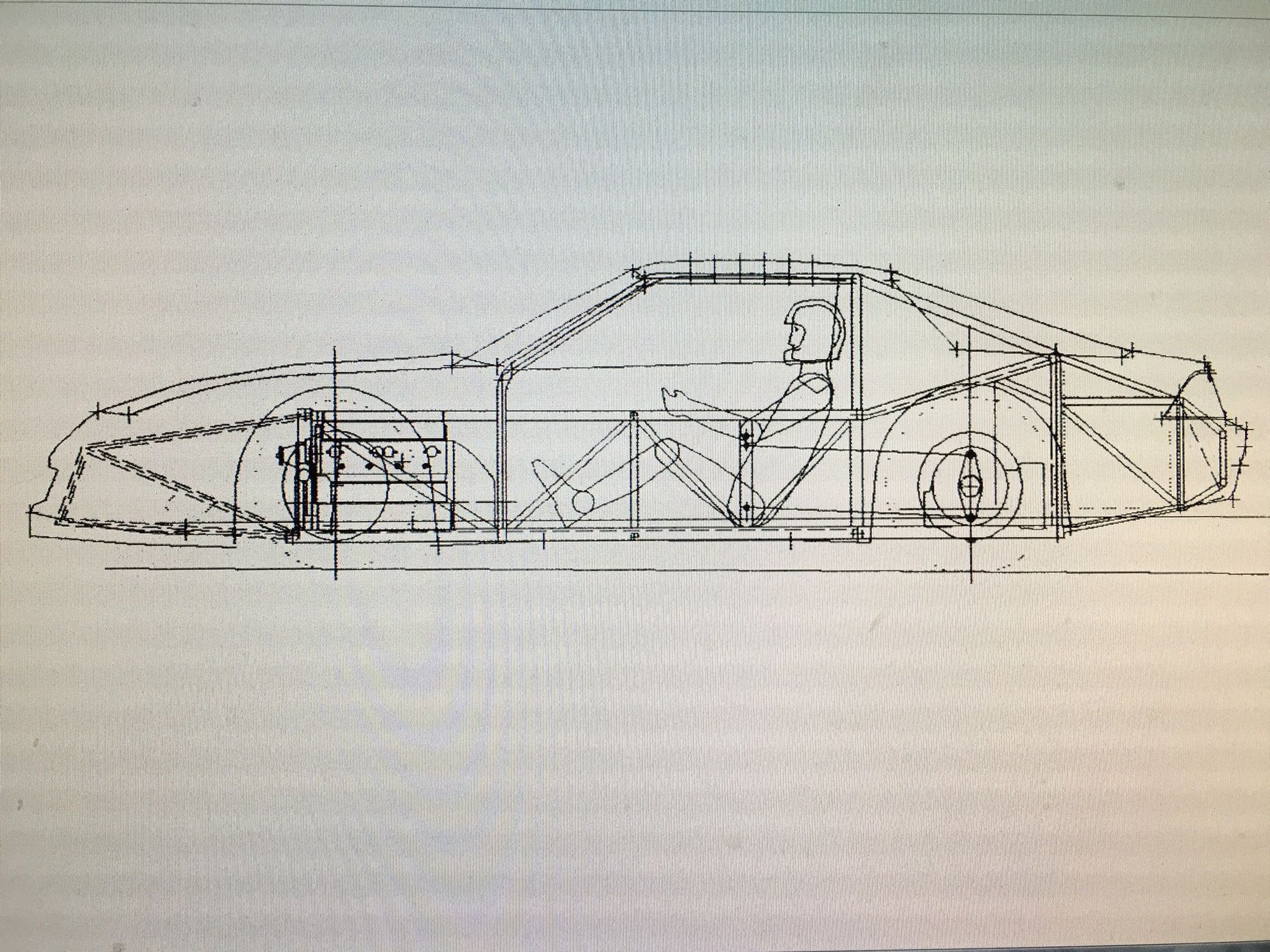

Jerry Kuhn the original owner gave me his blueprints from the when he built the car in '87.

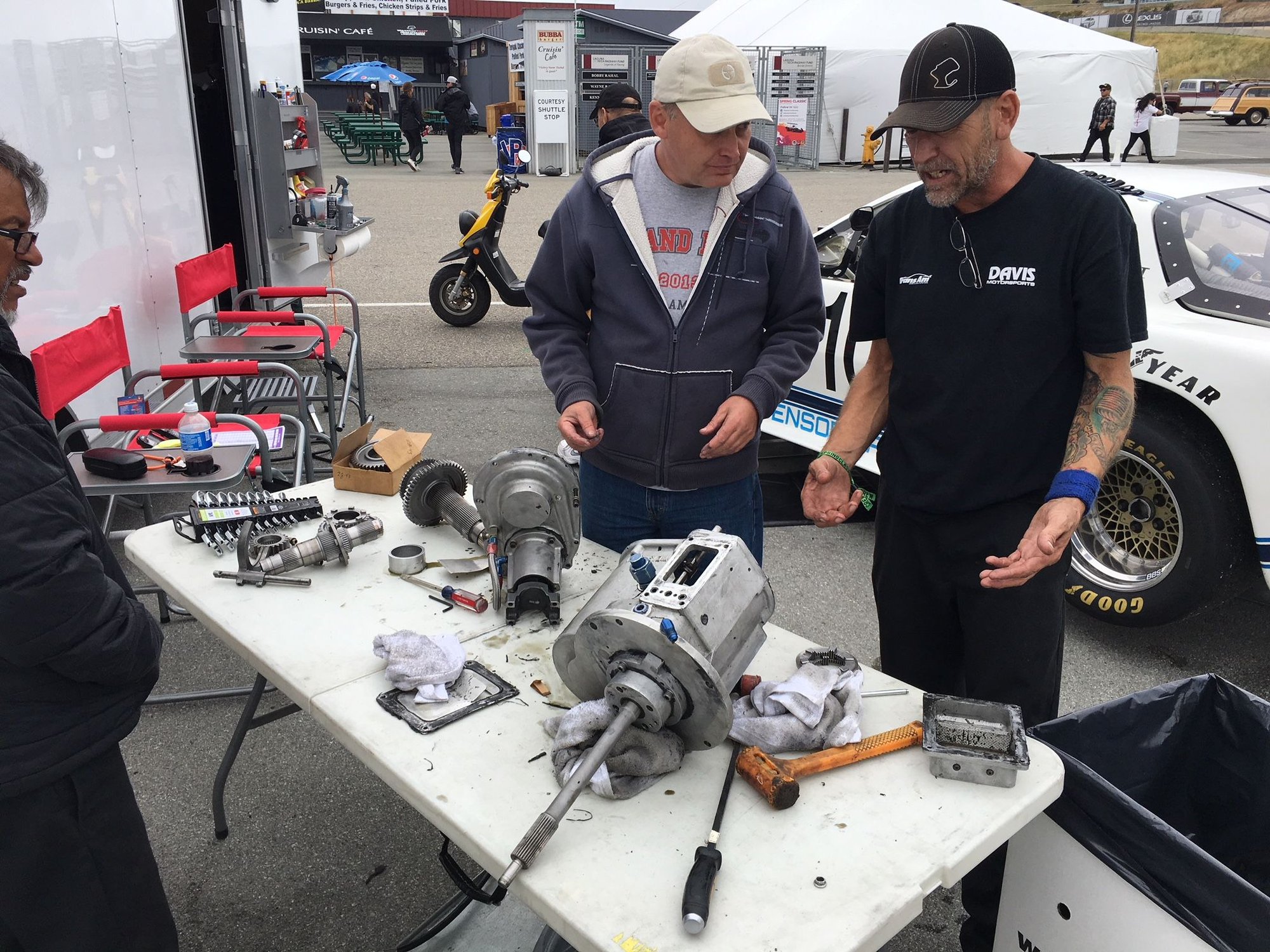

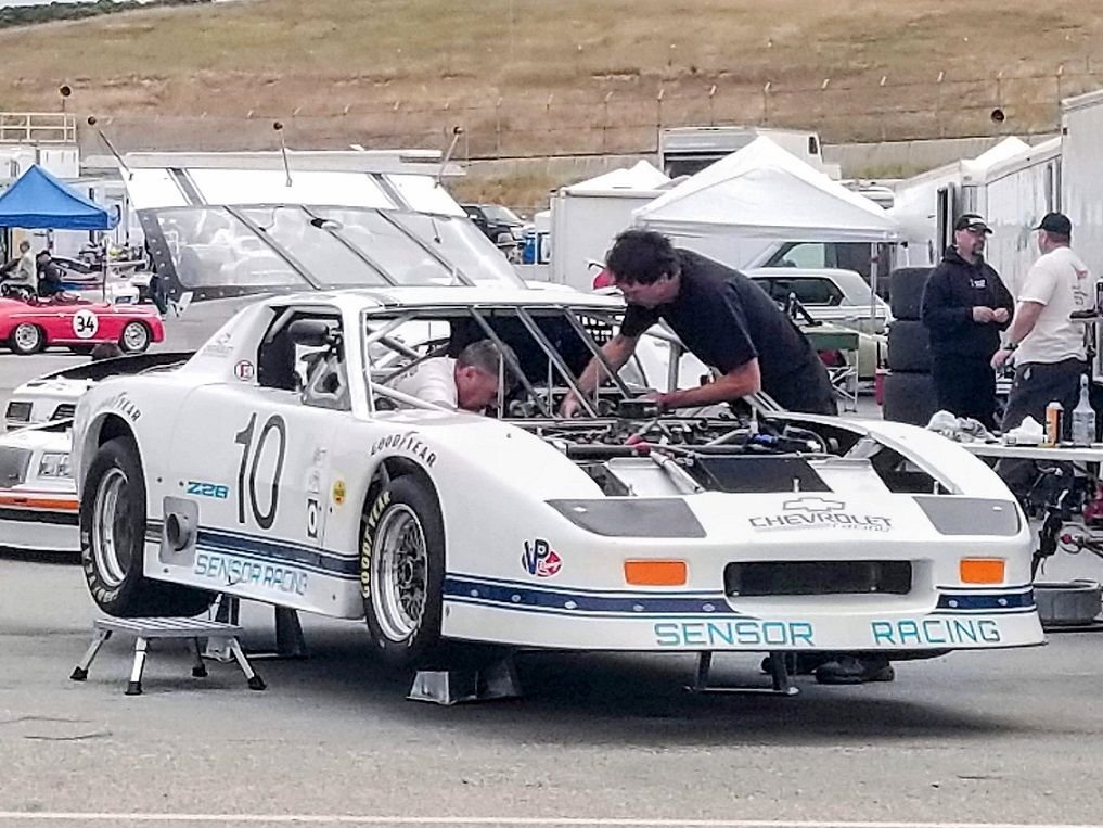

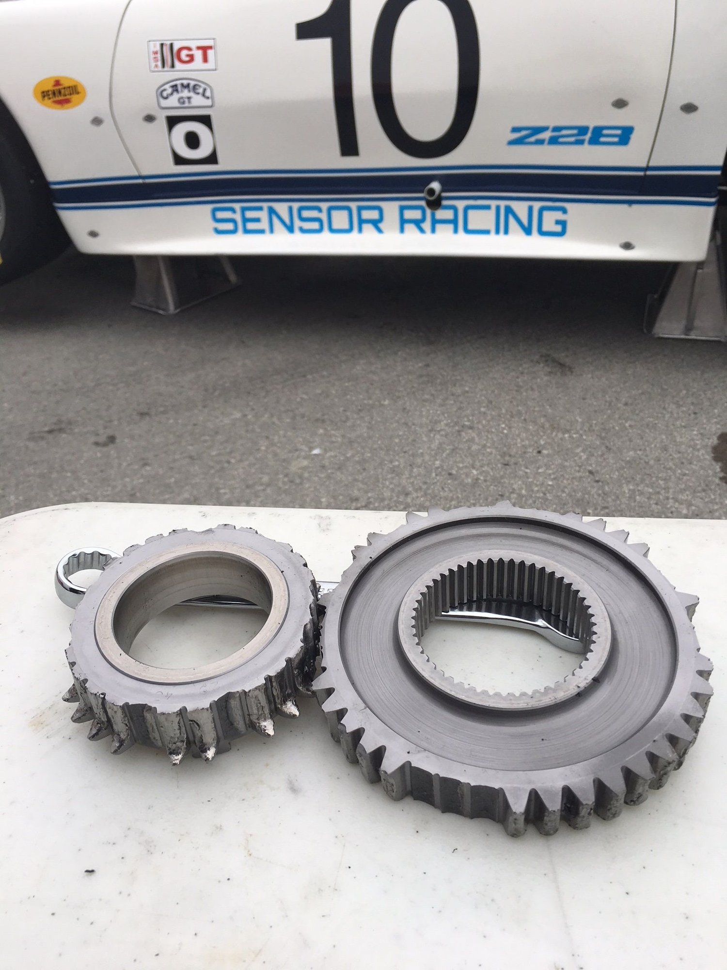

Photos of us rebuilding the transmission in the Laguna Seca pits a few years ago.
Wife spraying simple green to clean the grease our of my hair.

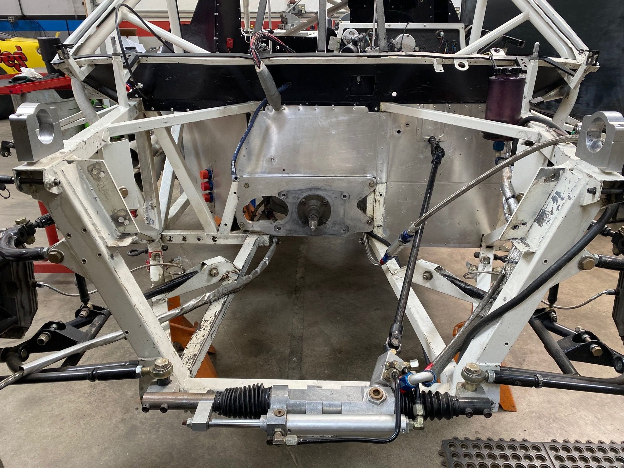

Much to do, before and after, down to bare chassis bones.
Under the old patched firewall heat barrier material are nice original 1987 aluminum firewall panels.
Just rebuilt the rack and pinion, new brake whips, rebuilt brake calipers, new master cylinders and a collapsible steering column.
Most of the parts were on the car already, steel header, original aluminum valve covers, steel air box, pretty sure original windshield wiper motor and defroster too.
I can't wait to drive it again.
On the lower left you can see the 3 red capped 1 inch bulkhead dry sump oil line fittings.
Couple trans cooler lines.
While you're in there, 7 inch dual disc clutch and throw out bearing.

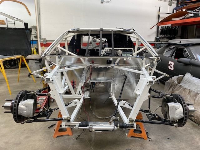

Making it look nice.
Firewall and front chassis restoration.
  • Front suspension back on the car
  • Firewall heat protection installed
  • New Master cylinders installed including remote reservoir mounting and lines

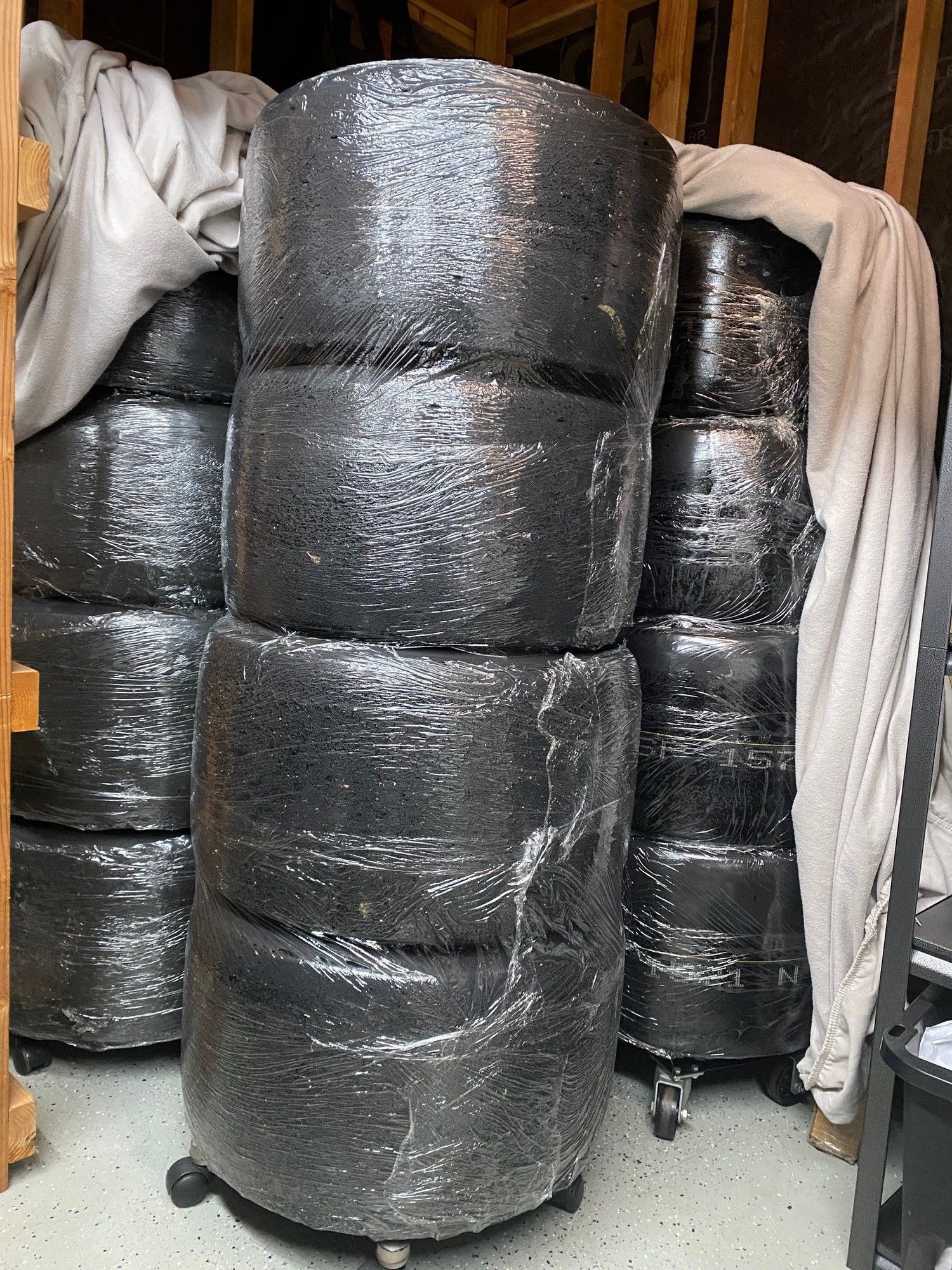

Test in July, race in August.
New and used Slicks sprayed with WD-40 and plastic wrapped kept in a cool corner under a car cover.

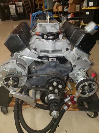

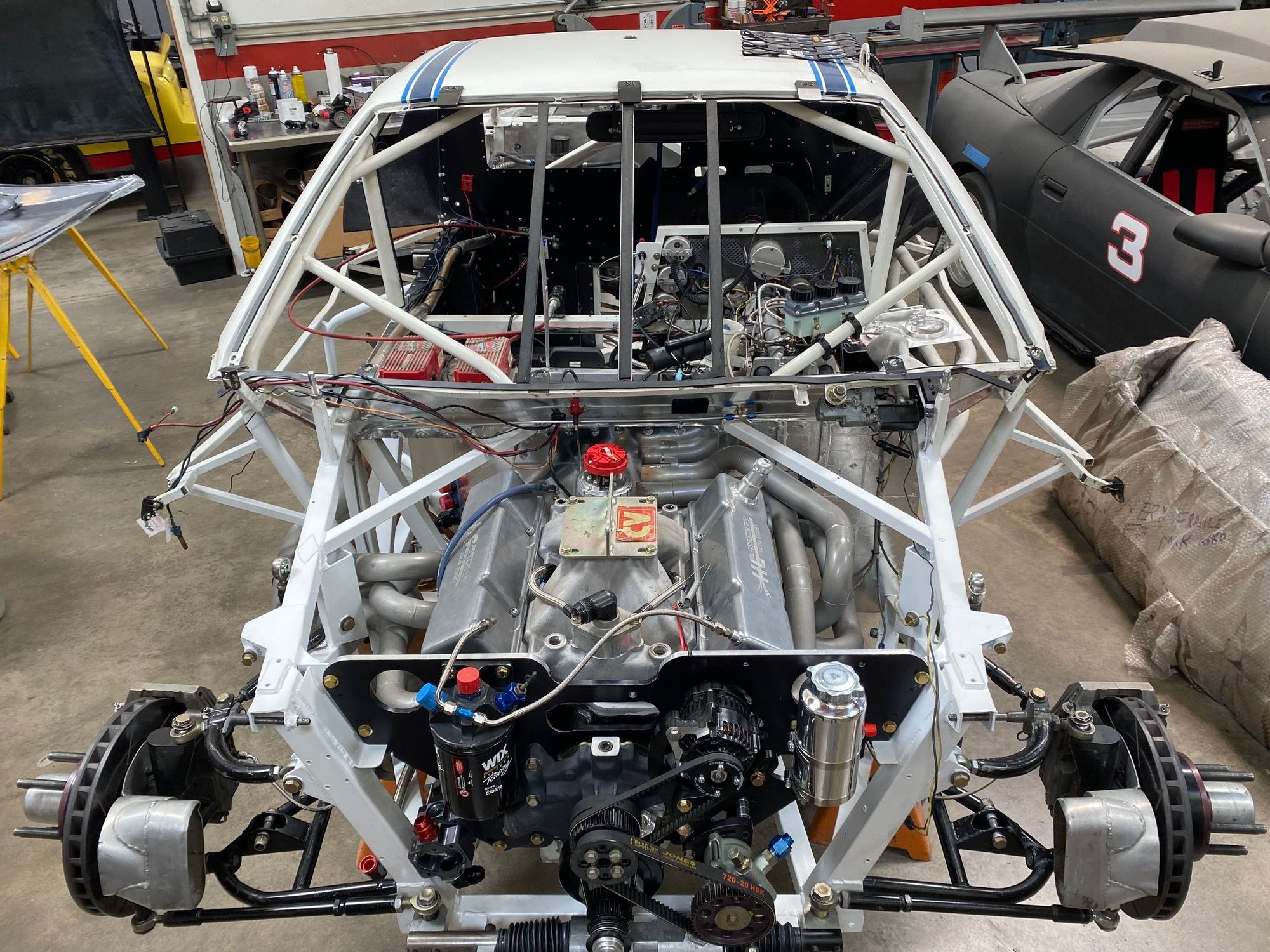

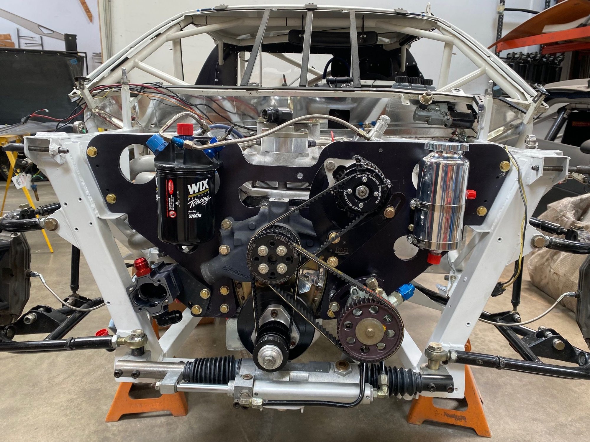

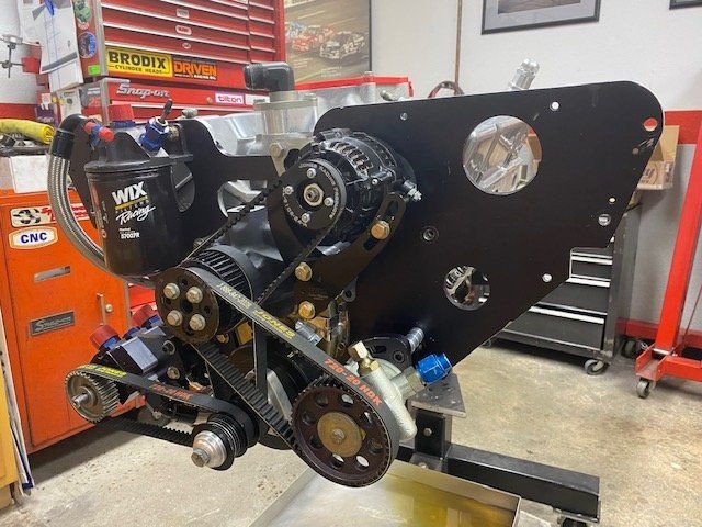

Ready to install a little over 600hp period correct 23 degree 358 trimmed with engine plate and accessories.
That's about the correct HP that the car would of had back in the late 80s.
Remember in historic racing no changes are allowed to improve performance.
Some changes to improve safety are allowed, like the on board thermal switch activated 4 nozzle fire system we recently installed.
The original 5 stage dry sump oil pump with swedged and pressure tested lines.
This belt driven oil pump is plumbed to the 4 gallon oil tank in the back of the car.
From the oil tank it requires a single 1 inch line to feed the engine and two 1 inch lines to scavenge the oil back to the tank.
All of this so the engine always maintains oil pressure during high rpm and high G cornering.

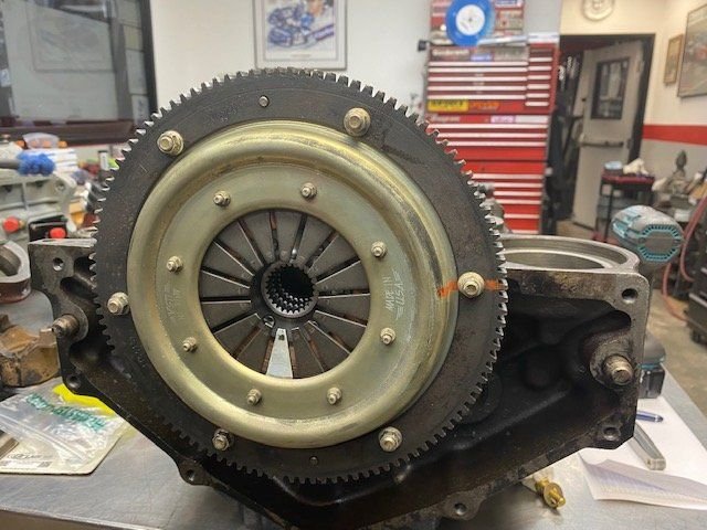

A new 7 inch dual disc clutch and T/O bearing.
The Clutch is only used in the pits and during heal toe downshifts, mine was only half worn out but we replaced it now while we had the engine out.
With the dog ring (no syncro) H pattern 5 speed the clutch is not used on upshifts.
My old T/O bearing was getting noisy so it was definitely time to install a new T/O bearing.
