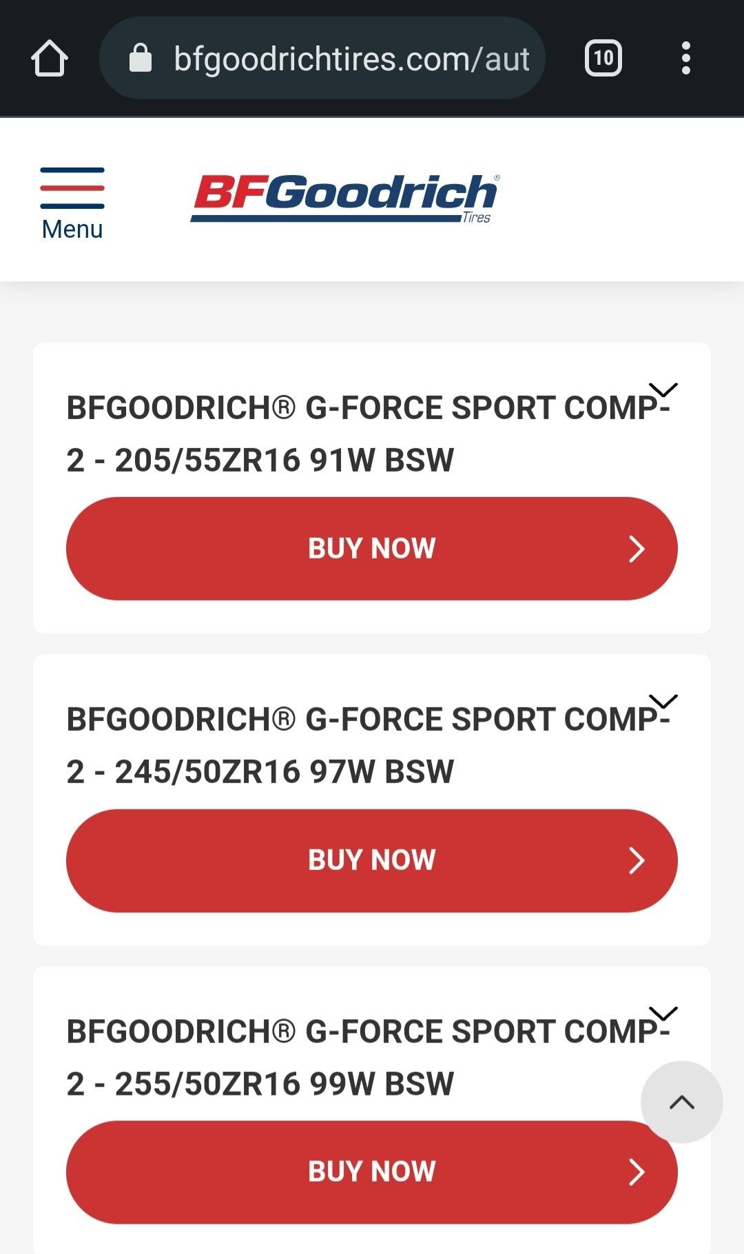

Not really sure if these are still available, BF Goodrich still lists the Comp 2's in three sizes for 16 inch wheels.
Have Comp 2 255/50R16's on my 91 RS, they are pretty good for what they are. They aren't quite as good as the Toyo Proxy +4.
