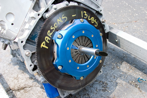

Busy morning and early afternoon so far.

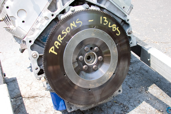

Install the flywheel and torque to 107 lb/ft in a star pattern:

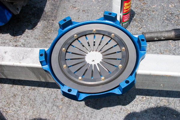

Clutch cover, flipped upside down:

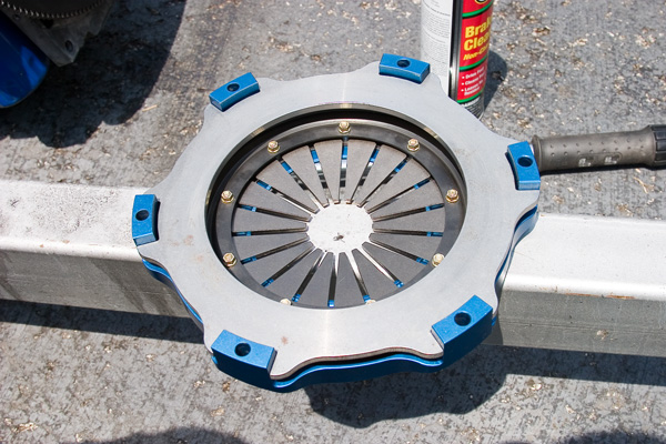

Pressure plate added making sure everything is ultra clean:
Then the disk:

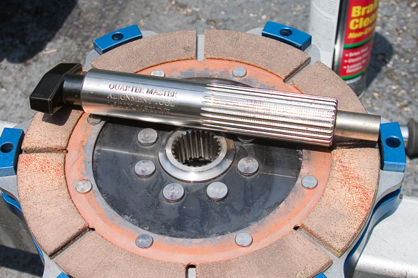

This is what a real clutch alignment tool looks like:

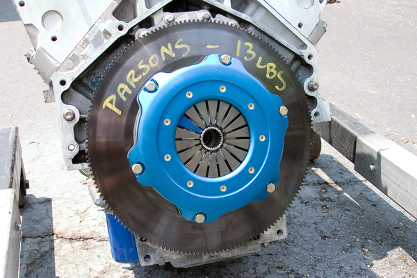

Alignment tool inserted. Disk lined up. Clutch cover tightened to 24 lb/ft with a dab or red locktite:

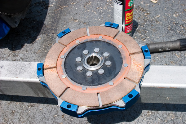

All done. The whole assembly with the flywheel and clutch is about 22 pounds:
After installing the clutch I double checked my setup height to make sure that the throw out bearing was in the proper position. Everything looked great. Transmission was attached to the engine and the engine is in the car. I will take more pics later.

Today I bled the system. Couldn't be much easier. Connected a clear hose to the bleeder. Cracked the bleeder and let it drip into a container. Kept filing up the MC until there were no more bubble showing in the clear line. With the 5/8" MC I can press the pedal with my hand. Double checked for full release, all good.
Andrew

I think the setup for Goldberg was a 2 disk 8.5". These clutches are not for the faint hearted. If your even thinking about "streetability" than this is not a clutch for you. If you understand what this clutch is all about and how it works, then it would make a great setup in a track day or autocross car.

All that stuff is pretty tame. When you swap to a light weight clutch you will have to learn to drive your car over again. It will want to stall on take off, so more gas need to be given. The other thing about these clutches is that they do not tolerate a great deal of wear on the disk. So you have a situation where in order to take off from a stop smoothly and not stall you have to give it gas and slip the clutch. Slipping these clutches is bad. They will wear quickly. The disk can wear only .030" before the spring pressure is out of spec. To keep wear to a minimum you will have to sort of pop the clutch at take off.
It all comes down to how much maintenance you are willing to do. For me taking the trans out, inspecting the clutch, replacing the disk, etc...., is not a huge deal. For others its a major hassle that they do not want to bother with.
Is it streetable? In my opinion yes, but only as long as you do not expect a very long life from the clutch.

Question...will that QM alignment tool above work with all LS1/T-56 clutches? From what I've found, the standard input shaft is 1-1/8", whereas that tool is 1-5/32"...I really like that tool though.
Old May 31, 2007 | 07:44 PM
  #73
Project GatTagO's Avatar
Joined: Mar 2003
Posts: 10,604
Likes: 1,881
From: Little Austin
Everyone calls it 1 1/8". In reality it has always been 1 5/32" x 26. So yes, it will work.
Andrew
