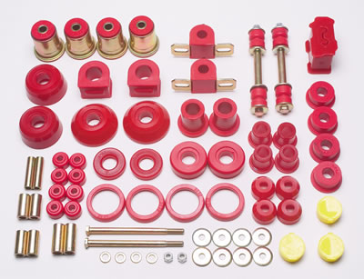

If you are looking for smoothing your car .. you will not need something like aftermarket K-member or torque arms !! ..
I'm suggesting these parts for anyone wants to renew his car and let it feels as new
Prothane Motor & Transmission Mounts, Red
Your car is about 10 years old .. you need to change your Motor and Transmission mounts ..
Energy Suspension HYPER-FLEX SYSTEM Complete Master Bushing Set, Red
This is a useful kit from Energy Suspension .. it contains all the bushings you need
SLP Bilstein Shock Package
I suggest these shocks with your stock springs ..
Thanks,

As a note, I do NOT recommended in poly bushings in any of the control arms (front upper, front lower, and rear lowers), especially the front lowers. Way too many problems that I and others have encountered with them, especially the caster bushing.
Replacement rubber is more than good enough for the control arms.
AFA the mounts, swaybar endlinks, and swaybar "D" bushings, I highly recommend Poly in those places. Poly transmission mounts may need some modification as some can introduce some crazy noise.

Yes do not put poly in the control arms if you want a "smooth" ride.
