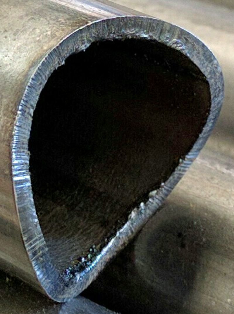

I have been around metal working and fabrication processes a long time. Many years before working here. My point in my original post was the tubes pictured were not laser cut as they were claimed to be. I don't care who posted it, I would have called it out the same. There are several identifying facts to point out on the tubes. You can tell just by comparing the first picture that was post to the second. The second is indeed laser cut
First, laser cutting leaves a trace line of discoloration from the heat. The first picture, the color is even all the way to the end of the tube and through the cut.
Second, laser leaves a very smooth, clean cut with minimal to no slag. The first picture shows large burrs, and the cut shows striations characteristic of a mill or hole saw cut.
To me, it's not so much about what process was used. We use the mill/hole saw notching methods here ourselves. There's nothing wrong with it. My point was just don't claim it's laser cut when it clearly isn't. Maybe someone just posted the wrong picture, I don't know.

Originally Posted by BMR Suspension
The tubes in the second image were definitely cut with a laser. The tubes in the previous image were not cut with a laser.
This is where the statement "you are talking out your *** because your mouth knows better" comes into play. Attached is a close up of the same laser cut tube in the first image. Yes the shop had a lens out of alignment, running the part to fast, or needed to replace the lens but non the less it was cut by a laser. You can clearly see the laser marks and the slag on the back side of the cut on this photo. If it was cut with an iron worker the shear marks would be going in one direction. If it was cut by a mill or hole saw again the direction of the cutting marks would be going in one direction. These laser marks are clearly coming directly from the outside of the tube in a 90 degree direction toward the center of the tube.
