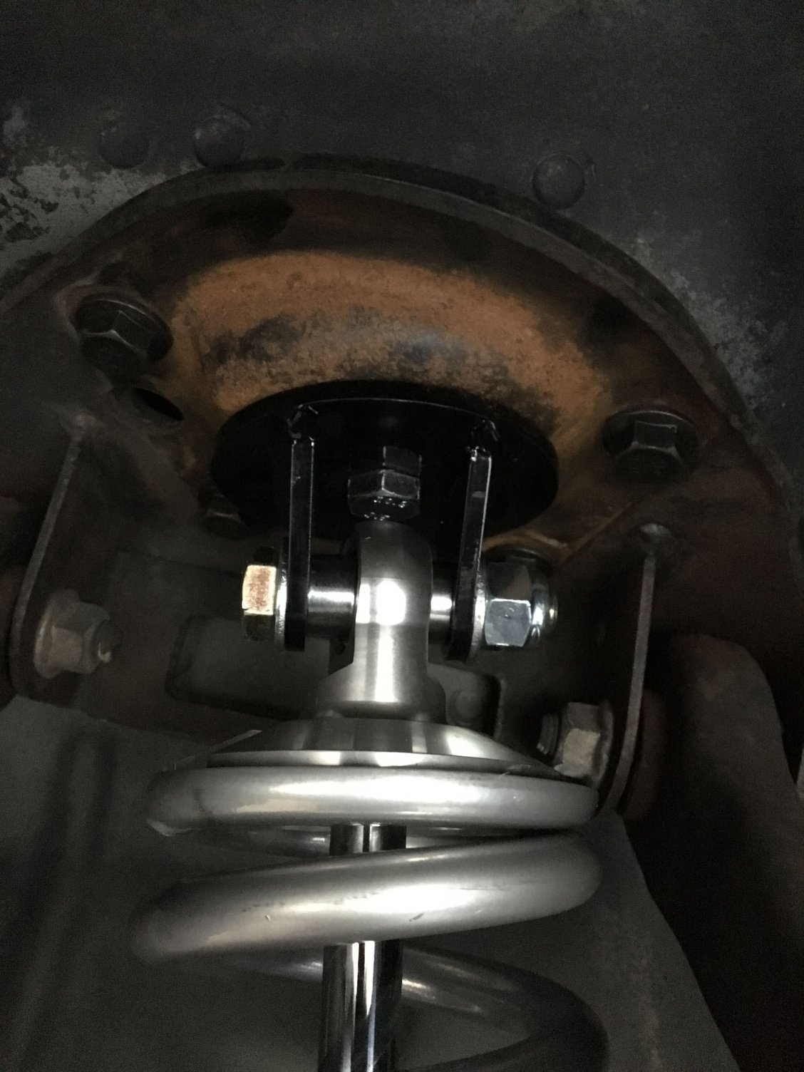

It was literally a bolt-in affair. The only drilling required is when mounting the double shear bracket on the rear axle. There are two bolts to hold it in place. One bolt uses the stock shock mounting hole, and the other uses the drilled hole, which I believe was slightly larger than, or exactly 3/8 of an inch. The rear was extremely easy to do.

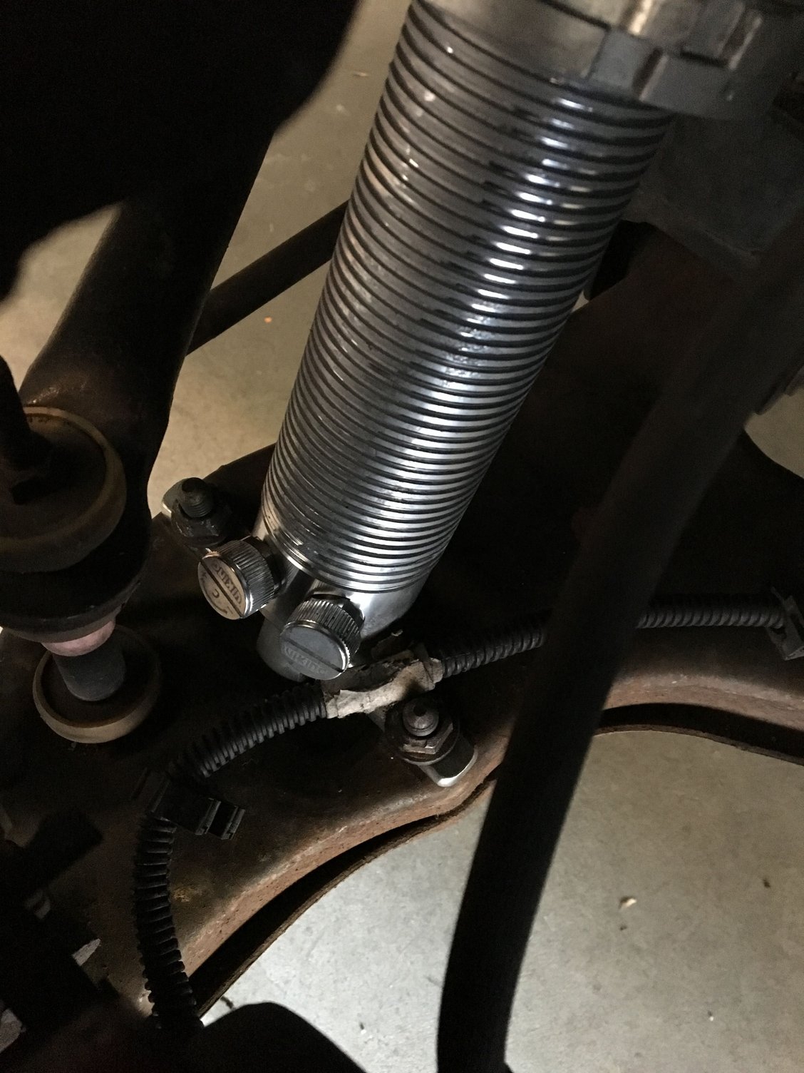

The front required us to drop the swaybar and disconnect the spindles from the A-arm on each side. We didn't have to use a spring compressor at all. The old spring/shock assembly came right out. Once the top shock mount/a arm and all of the rubber isolators were removed from the shock, I cleaned up the mount/a arm quickly. I regret not painting it now, but time was short here at the end of my college semester. The new UMI mount bolted to the stock mount, which was then bolted up to the car, and the coilover was bolted in.
I got the ride height where I want it now, and I love it! On low compression/rebound settings, the car rides as nice or nicer than stock, and with just a few (3-5) clicks more of the adjuster ****, the car transforms into a whole new animal. I haven't even come near the limit of this setup yet. There is much more room to adjust.
