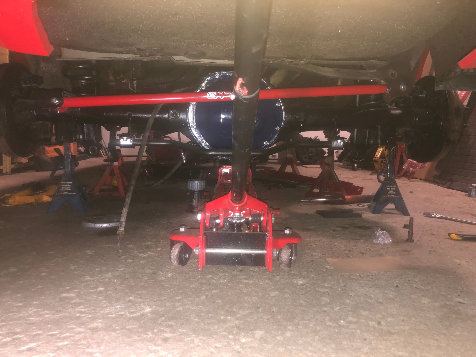

Hello all not sure where this thread is going not too savvy here, but I was wondering is there any info on how to raise the rear suspension instead of lowering or making it not so stiff? For my 95 trans am 5.7 litre 6 speed manual.

First understand that height and spring rate are 2 separate things.
For example on a coil over shock with an adjustable spring perch. You do not change to a longer or stronger spring to raise the car. You move the seat higher.
In your case. A spacer under the coil spring will raise the car and not change the spring rate.

Hello apparently the driver side is higher by about 1 inch compared to the passenger side, which I have noticed with the new oem coil springs.

Do the springs have tails on them?
1" is alot. That should not be hard to find.

Hello the springs are oem stock original. I spoke to another trans am owner and his car is also 1 inch taller on drivers side like mine.

I want to say I’ve heard they were designed to sit a little higher on the driver’s side so they’ll level out some with a driver in the car. No idea if that’s actually true.

I am guessing you are trying to raise it to make it ride better? Well, that won't help much bases on those photo's. BIG rear axle is unsprung weight increase, the shocks look like parts store ones, maybe KYB Excel G, which can't deal with big unsprung weight, and no bumpstops.
Not to mention the springs don't look like lowering springs to me either. What are they?
