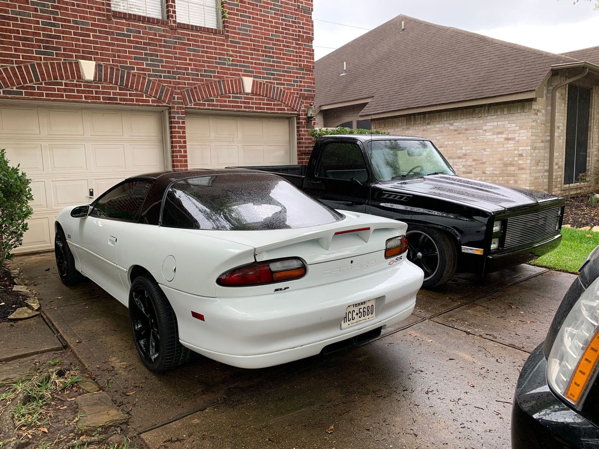

Wow, I think I just finished my crazy job. Time to get back to work on my car. I had enough energy today to wash my car and truck. They where both green from all of the crazy pollen. I have been researching the LS7 this last week while they try and get the plant started up. It seems that the titanium rods will eventually fail and wipe out the bearings. I really can’t go with the 441 kit because the cylinder liners are to thin. So I am going to talk with a shop in Houston next weekend to get some ideas. For now, if I get some time tonight, I will pull the heads off and pull out the rotating assembly. For now all I have is a picture of a clean car and truck. More to come this week.

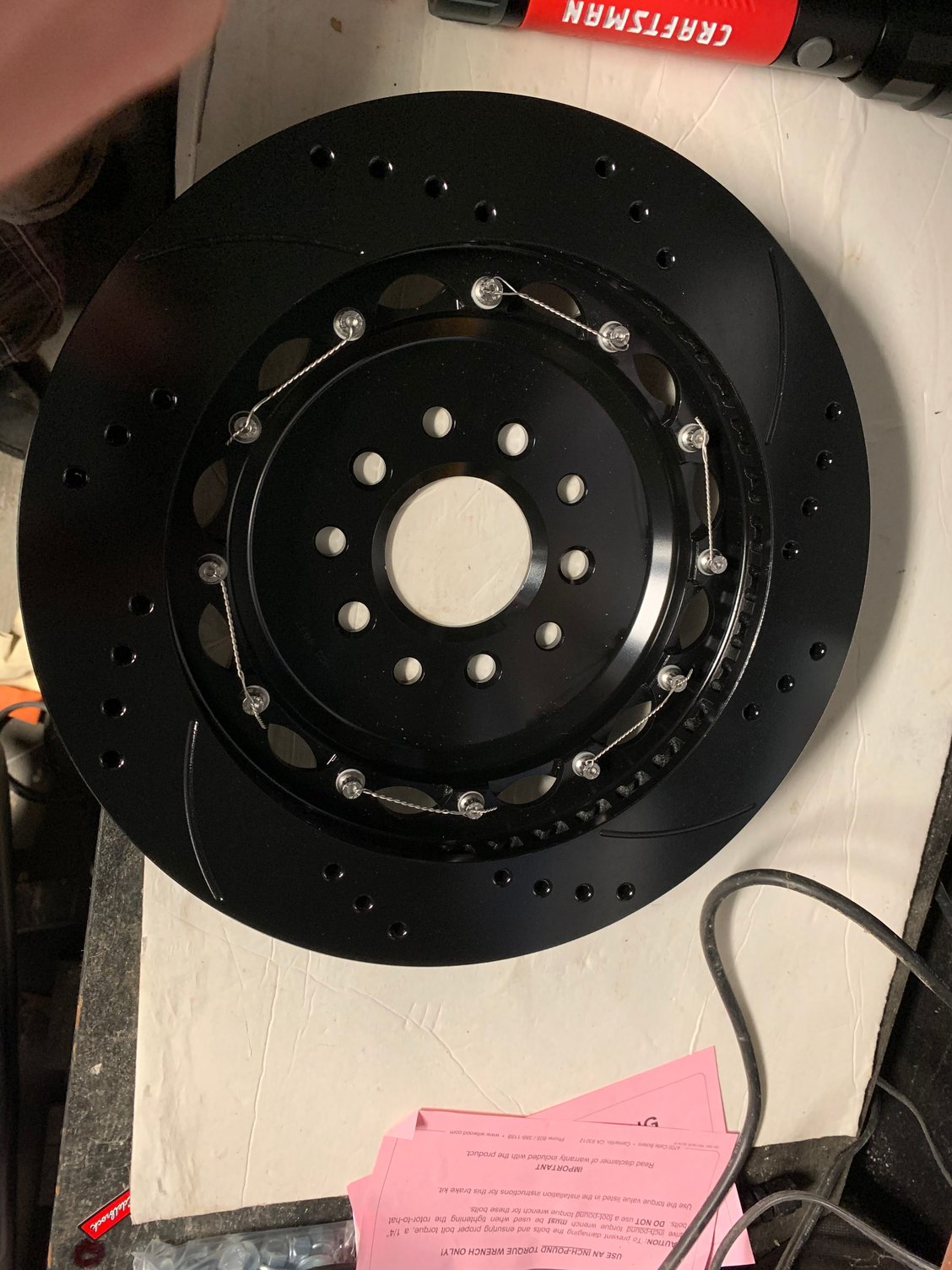

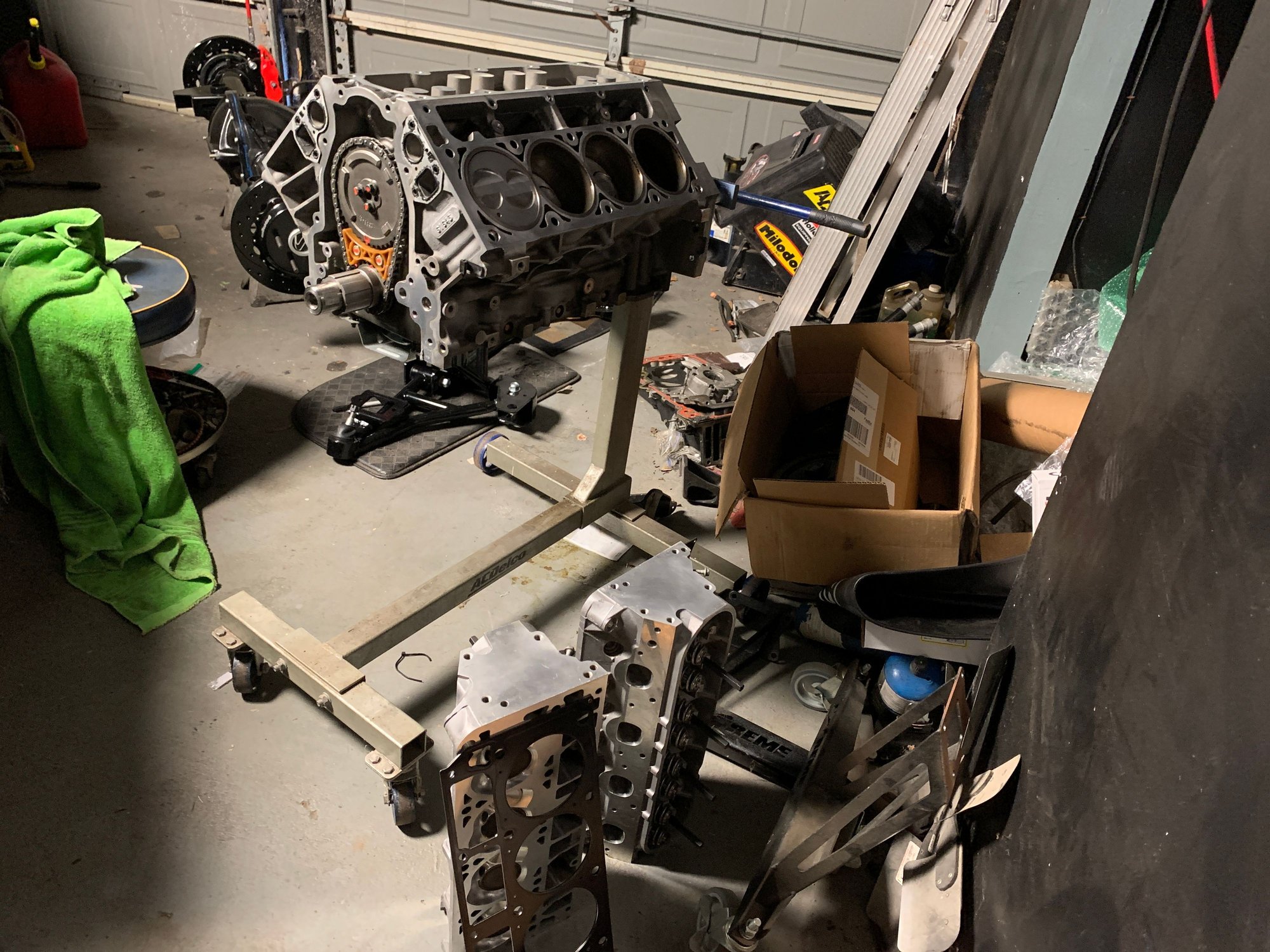

I was able to get the engine down to just the short block last night. I want to take it to the machine shop with the rotating assembly and cam in place. The lifters looked good so I can sell them. I just finished torquing and safety wiring the front brakes. I LOVE being locked down during the pandemic. I just went from working 91+ hours a week to being locked up in my garage. What a transition.

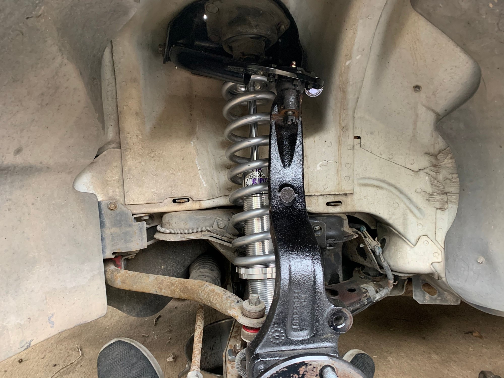

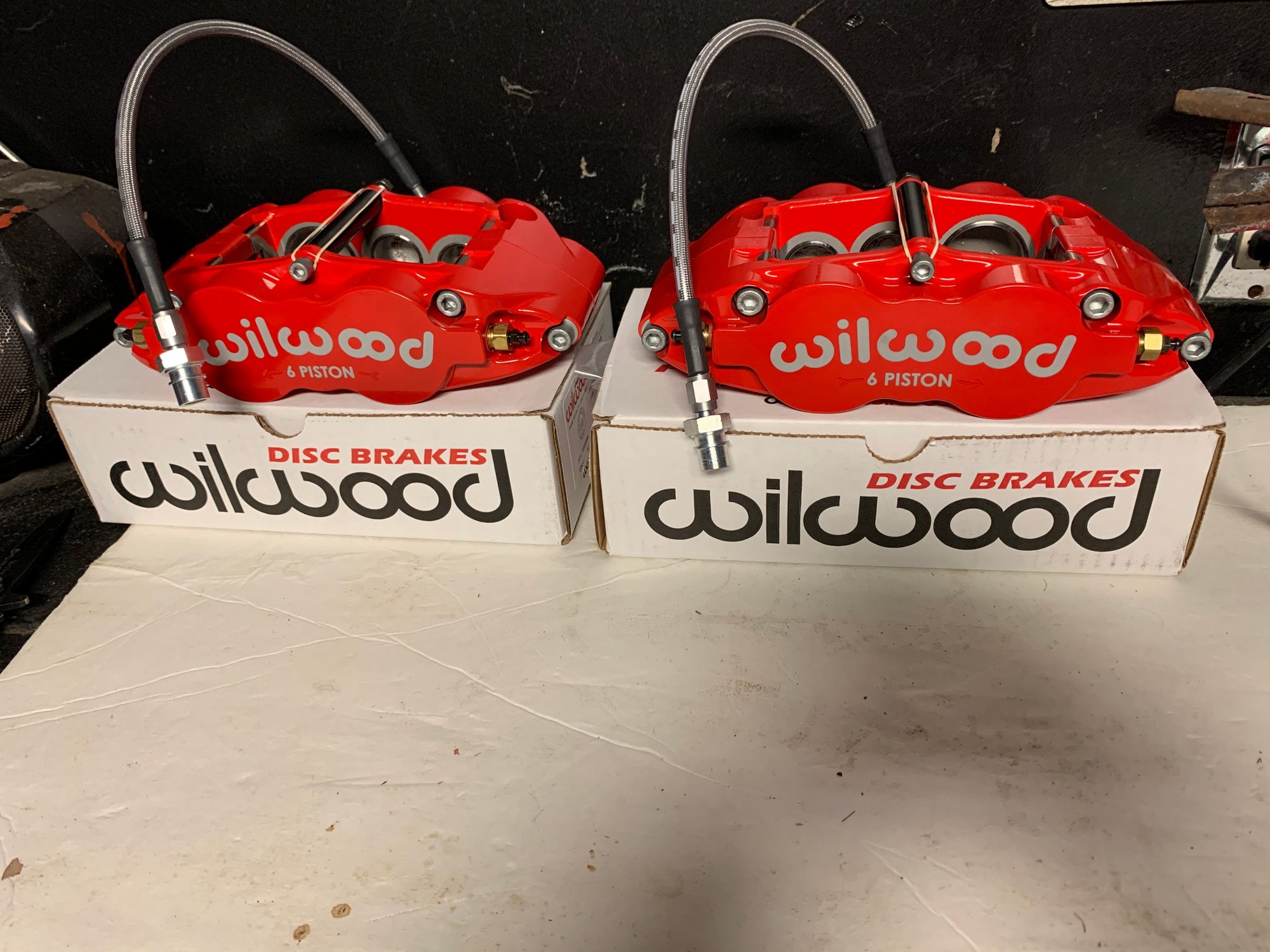

Hey. I had a chance to work on the car some today. I was going to put the front brake kit on, but when I took the front tire off I said, just do the upper control arms, coil overs, and brake kit. I have a friend stopping by tomorrow and we will do the other side and maybe put the rear end and torque arm in as well.

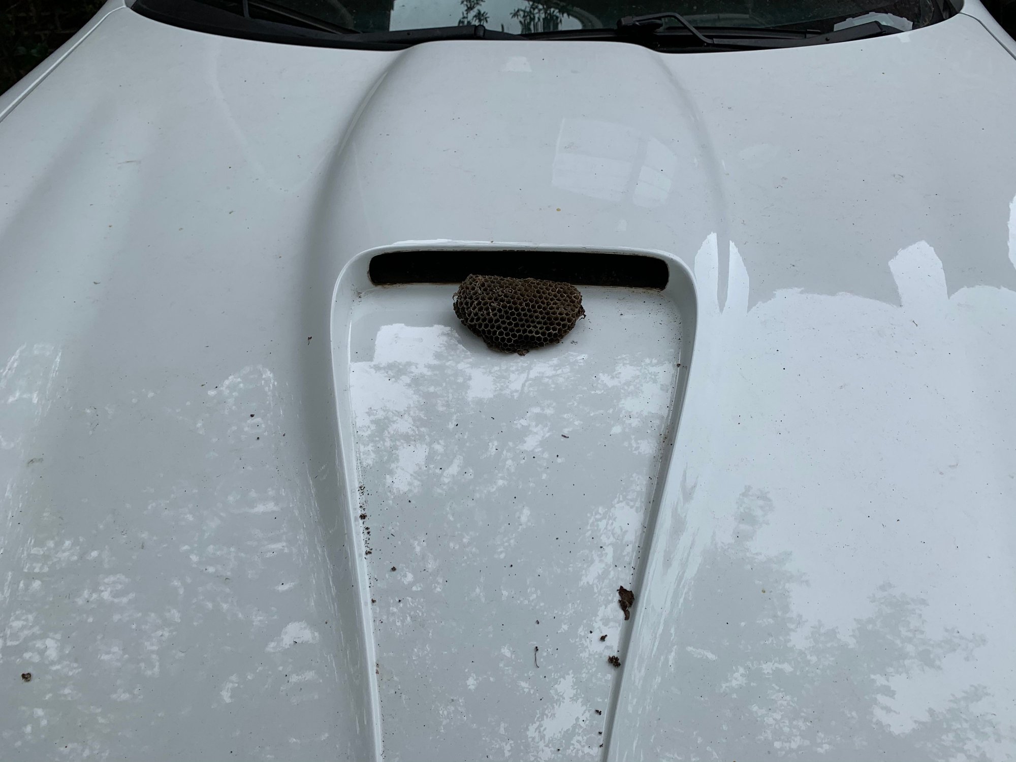

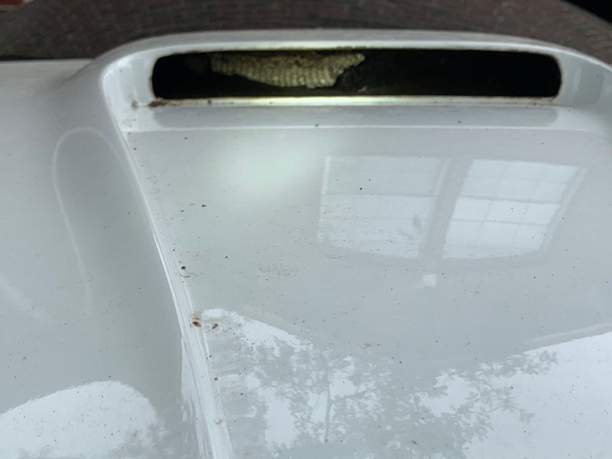

I found an easy 5 HP upgrade. Just take the wasp nest out of your hood scoop.

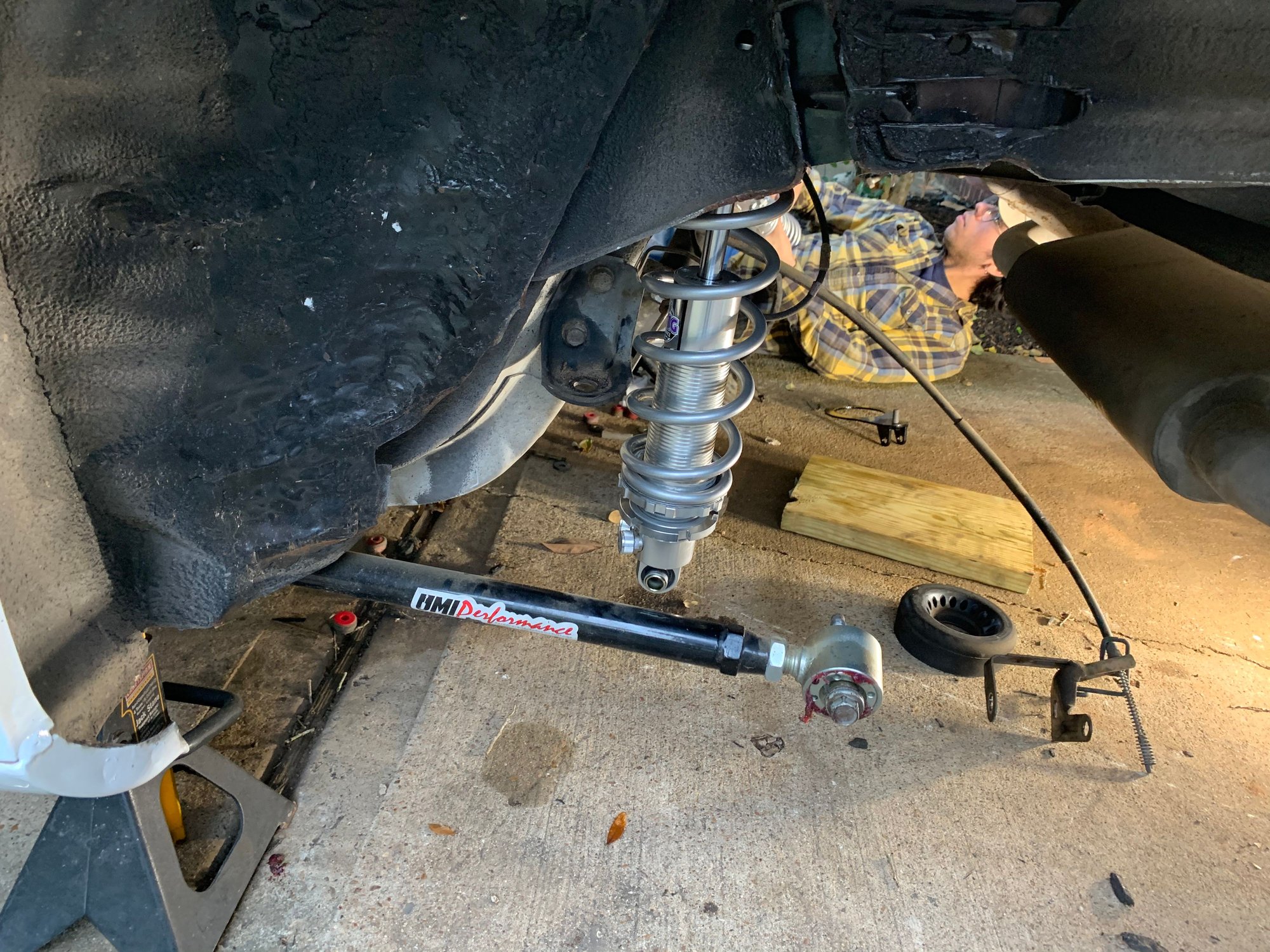

Today we finished up the front brakes, coil overs, and upper control arms. We took the rear end and torque arm out. Installed the driveshaft loop and Strange driveshaft. Had to stop for the day.
Dang!!
That's crazy!!!
