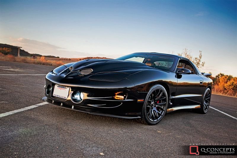

That car is the reason i am buying those wheels.. I was just able to find the diameter for the hubcentric rings, would I not want aluminum rings?
Im about to place an order on these after those pictures.

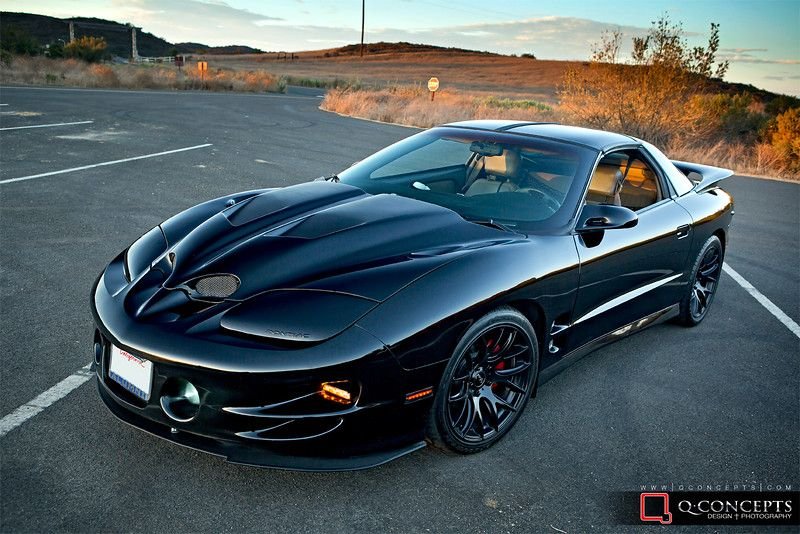

Vikingramair, always enjoy seeing your car.
Here's a couple more shots with Miro 111 wheels.

Qcon, this goes both ways! You inspired me with the look of your car.
