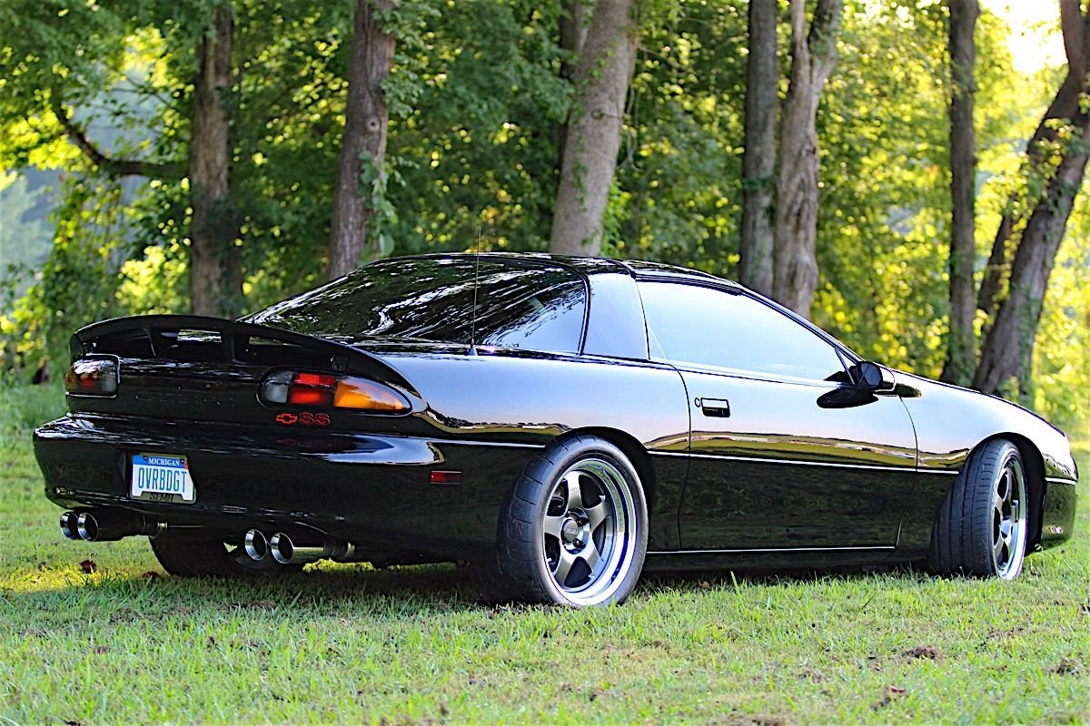

Had the same issue, but went with 315/35 Toyo TQs and 275/35 T1 Sports up front. Nothing looks out of place. Selling the tires if you're interested, PM me. Only 800 miles.

Those look great! Wish I had the $800 but I'm tapped out for now. I just dropped $1100 on Strano springs and Koni shocks plus my car goes in the shop for a whole bunch of other stuff 1st of the month so I'll have to pass on them.
