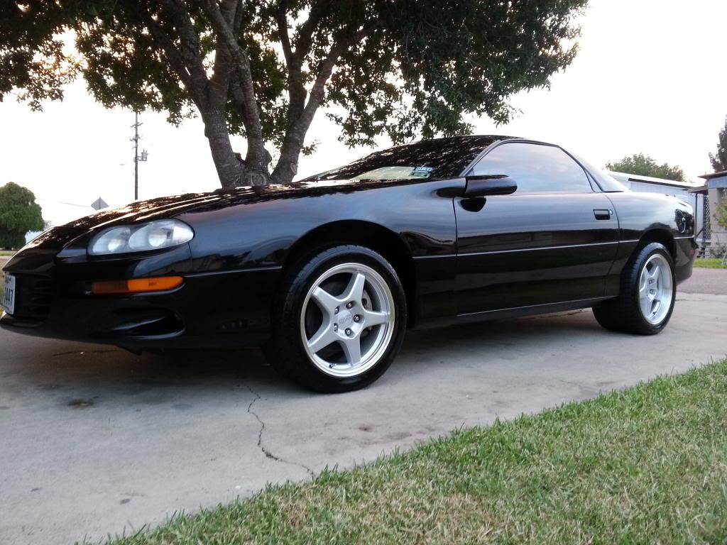

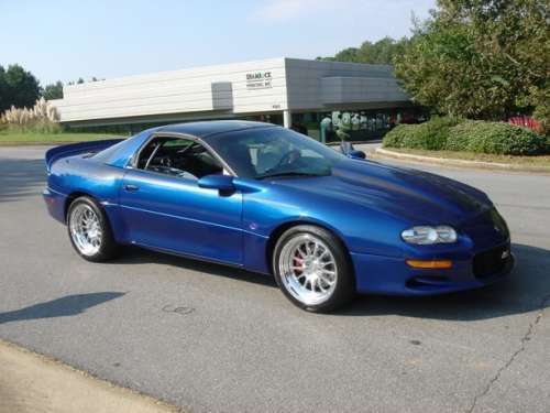

So I've been looking around trying to decide the look that I'd like to go for with my 02 Z/28. It's my DD, and every so often I make the trip from California to Washington and back. Not knowing much about tire sizing in general, I'd like to hear any suggestions on what I should do to make my tires and wheels look like the pictures below? I want that aggressive/muscle look while maintaining practicality (taking into consideration the rain that we get in Washington). Is it recommended to offset the sizing between the front and rear so the rear is slightly larger? As in, wider and taller? And if so would that affect the rim size as well? Any help or to be pointed in the right direction would be appreciated!

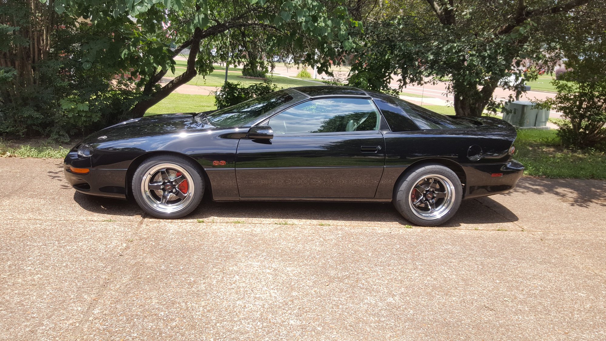

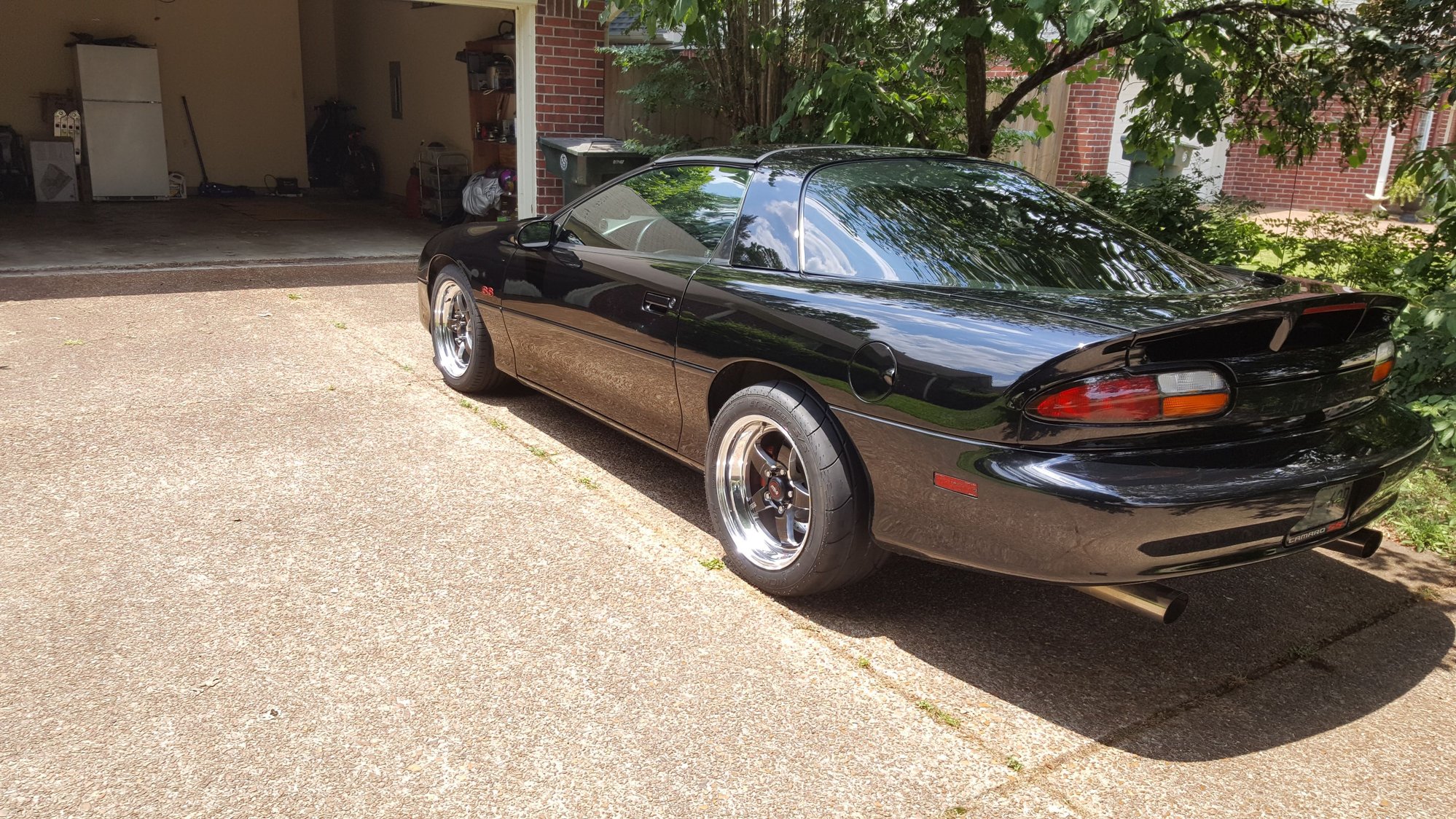

This is mine. Could easily do this minus the drag radials.

Thanks I appreciate it. They are 17 x 8 in front and 17 x 11 in rear with the typical f body offset, I don't remember I called Weld and told them what I was doing and they sent me what I needed.
