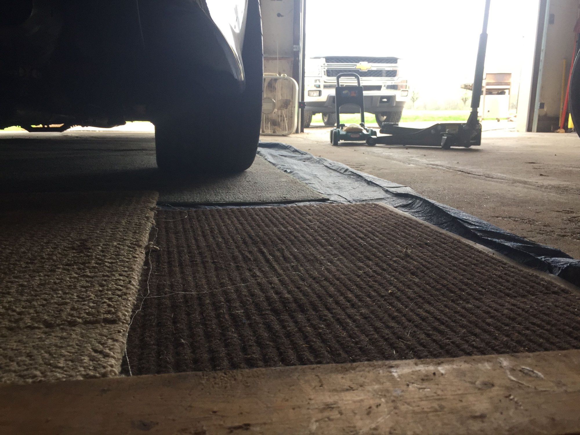

Well i borrowed a 315/35/17 mickey thompson off of my tire guy to see if it would fit. He has the same tire on his ws6 and told me me it would fit so he mounted it on my spare ws6 rim and put it on my car and it fits just fine i have about an inch of clearance all the way around. The tire mounted just fine on my factory 17"x9" ws6 rim very little tire bulge. Needless to say ill b ordering 2 of theese for my car

315? on STOCK wheels??? Holy crap!!! I have C6 wheels already btw.

Well you can run Nitto 555R that are 315's on a 17x9 wheel all day because they aren't a true 315.
As for MT 3471 which is a 315/35/17 ET S/S.... you need a 17x11 wheel for that.
No one should be putting a MT 3471 on a 17x9 wheel.

The left 315 the right nitto 275/40/17 extreme drag radial
My 315 fit just fi e
Old May 10, 2018 | 08:40 PM
one sweet ws6's Avatar
Joined: Jul 2012
Posts: 283
That was putting a 315 on my ws6 rim and on my car
