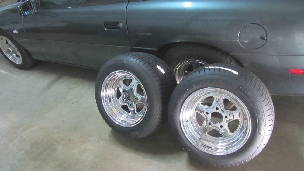

275/50 QT Hoosier. Just put them on 15x12's and they measure only 25" diameter. Too low profile for best traction but I had them for another car never used em so i'll use them up.

I had same problem with braking after putting drag wheels on my Hoss. I pulled the 40 amp abs fuse problem solved . No more death pull to the right under hard braking. When I put the stock wheels and tires back on abs fuse will go back in. Back to normal abs function
