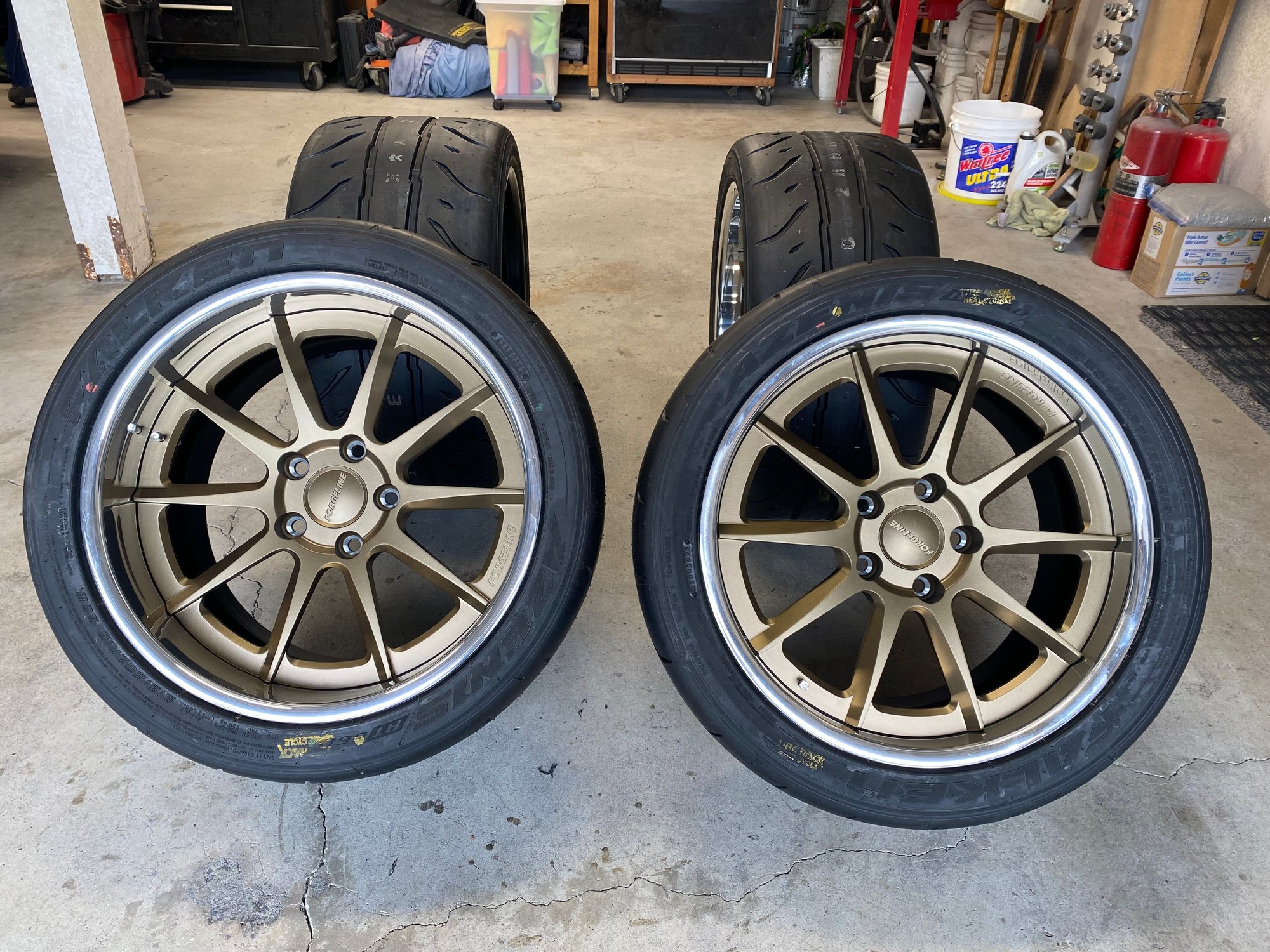

Forgeline RB3C / Fulken Azenis RT660
18 X 9.5 / 275/35-18 front
18 X 11 / 315/30-18 rear
Those are gorgeous. Got a pic on a car?

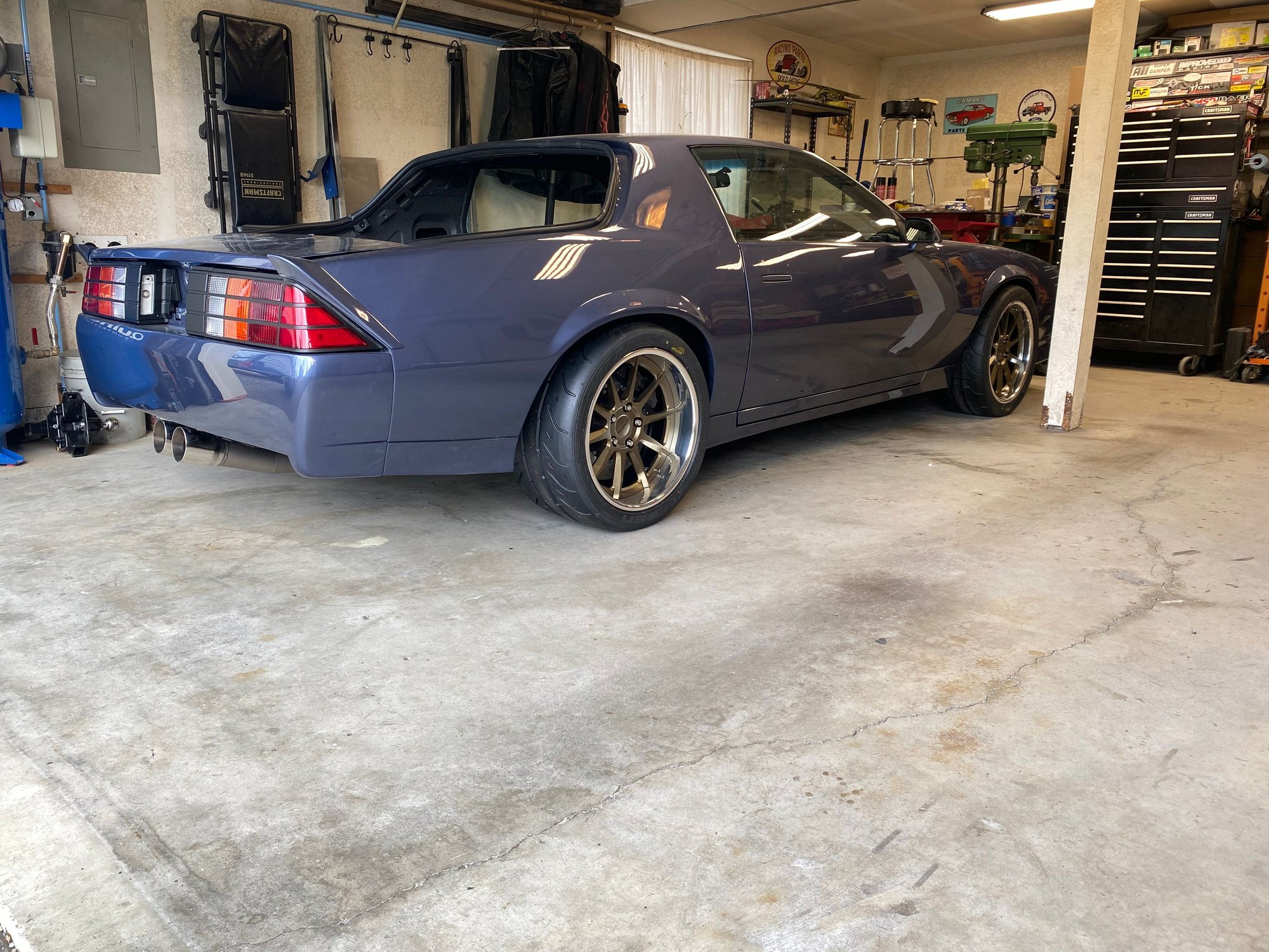

The car is still under construction, but close to being finished.

That's sharp. The 3rd gens are really growing on me lately.

those wheels are amazing . how did you do that rear bumper .

Originally Posted by RGSS
Looks incredible! Great choice.
What Backspace did you specify and is your rear stock width?
I am about to begin a project with a third gen.
The wheels are custom ordered, the front are 18" X 9.5", 6.5" BS, and the rear are 18" X 11", 7" BS to fit the C4 Corvette suspension that is in this car. The track width is 2" wider than stock, 4th gen track width in the front, and C4 track width in the rear. The rear fender lips were rolled for additional clearance.
It is fiberglass. I made a mold from a foam buck and laid up the bumper in the mold. Unfortunately the mold had to be destroyed in order to get the part out. I intended keep the mold in order to cast more parts, but it didn't work out. There are detailed pictures in my thread in the Camaro projects forum.
