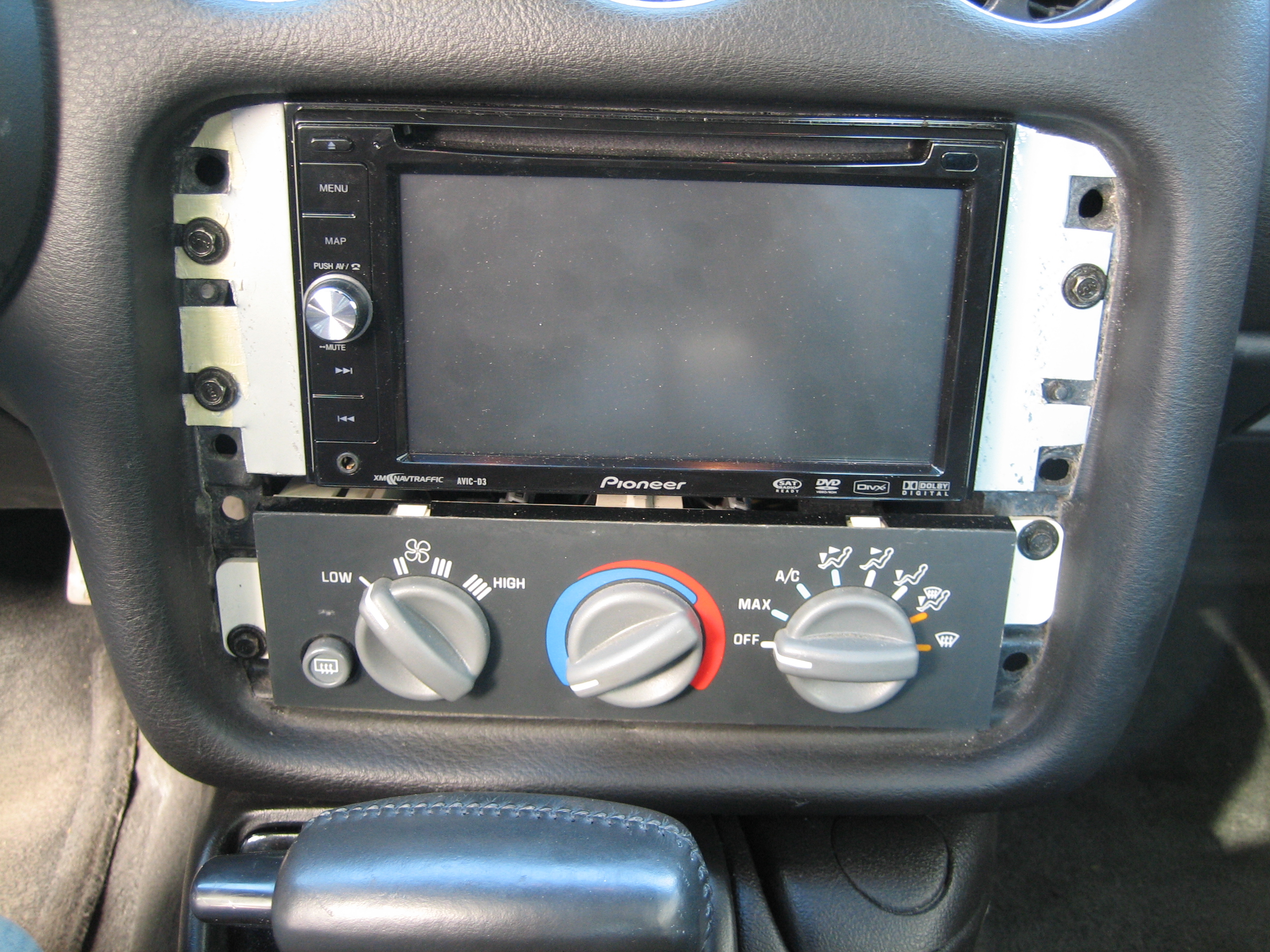

You can make your own brackets out of spare sheet metal and it will be more secure than most aftermarket kits. That's what I did.

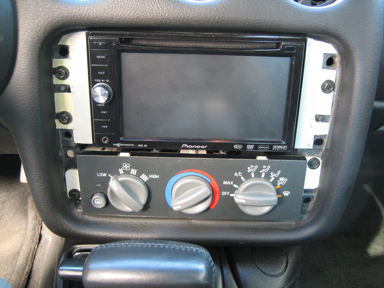

I ordered a complete metra double din mounting kit and trim piece. I used the mounting pieces to actually mount my radio. I modded the trim piece to fit into the Camaro bezel. It was then bondoed over and painted.
The parts identified in the pictures are the posts from the actual bezel and the screw holes for the mounting kit. If you align the mounting kit properly, you can make it so the posts slide right through the screw holes. It holds the radio very securely. The second picture shows the best example of this. The other 2 shots show the unit pulled back a bit.
Here is the finished stuff. I had the vents both painted to match the center piece. Sorry for the finger prints and smudges. The main piece has a silver pinstripe around the back for added detail
