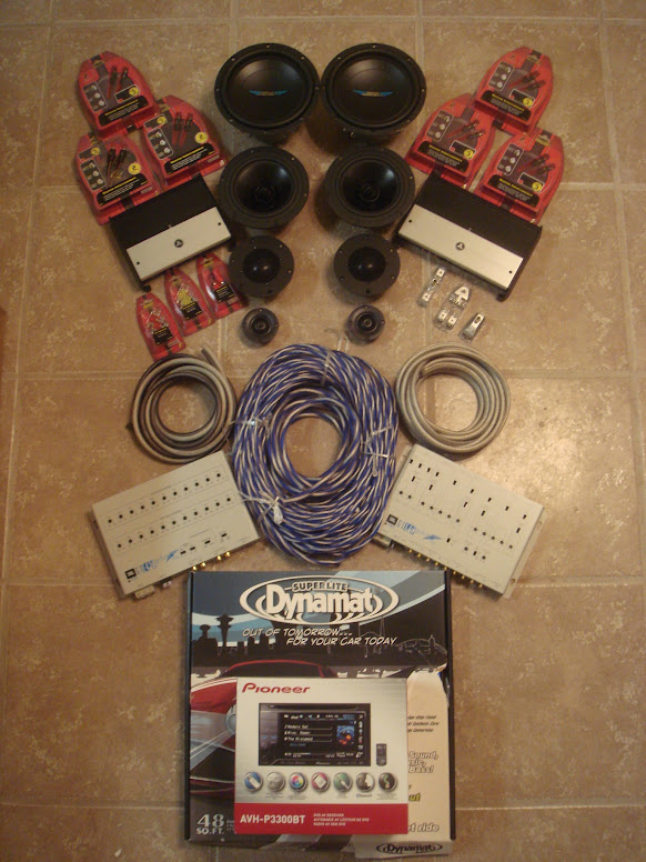

EQUIPMENT
SPEAKER DRIVERS

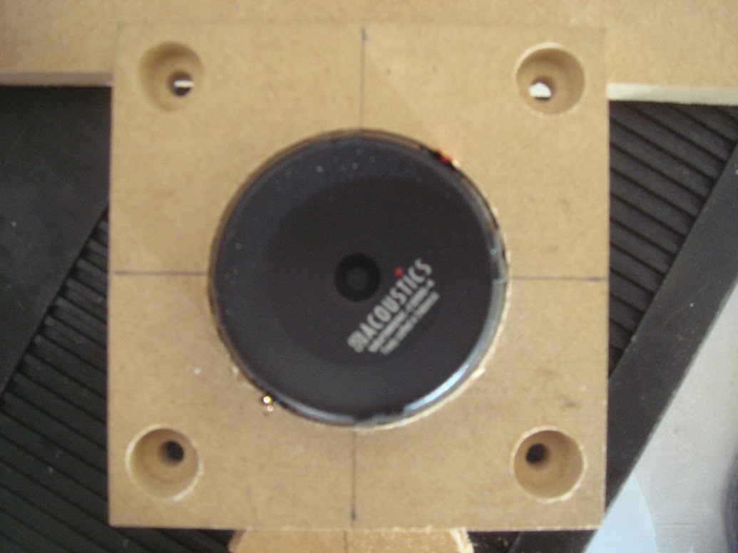

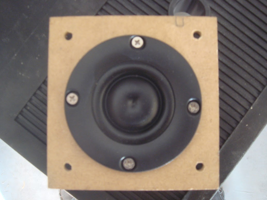

Tweeters: SB Acoustics Ring Radiators SB29RDCN

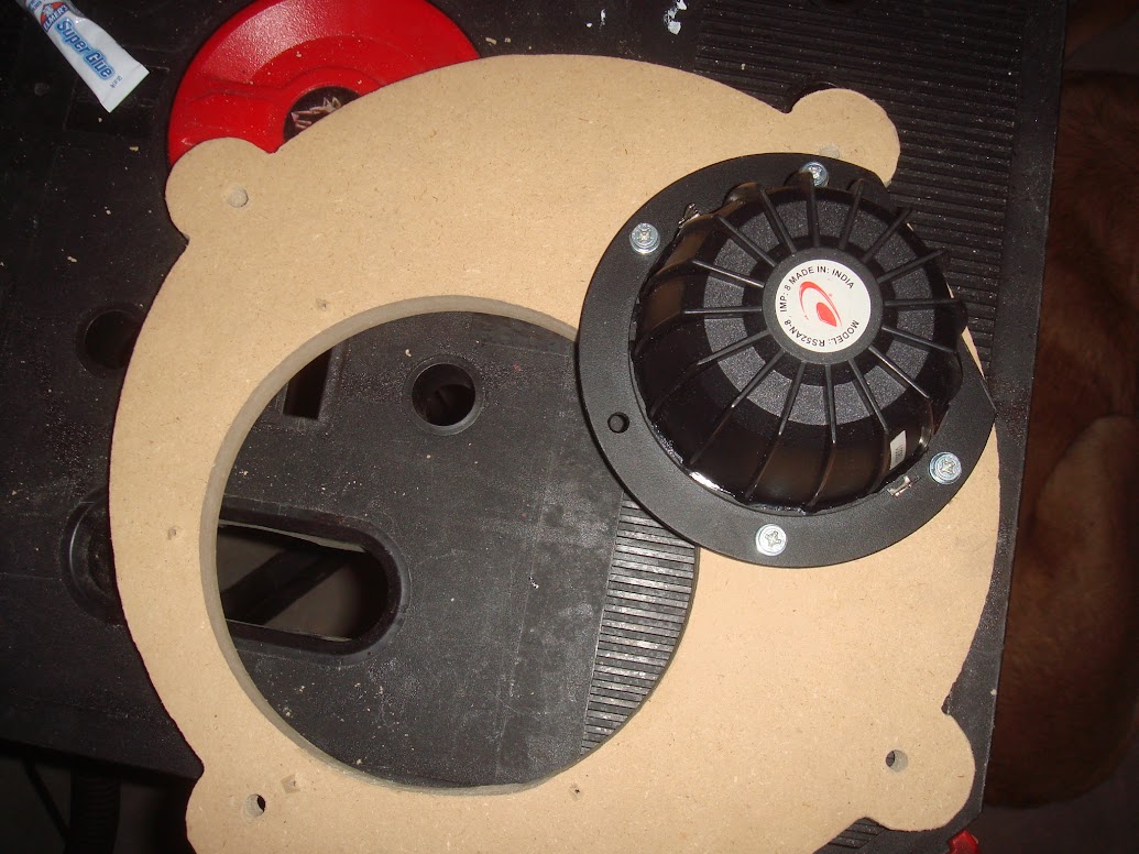

Midranges: Dayton 2" domes RS52AN
Woofers: Dayton Audio 7" RS180
Subwoofers: Image Dynamics 8" ID8V.3 (Have been replaced by Sundown Audio E-8 V.2)
ELECTRONICS
Head Unit: Pioneer AVH-P3300BT (Has been replaced by Samsung Galaxy Tab2 7.0 tablet)
Speaker Amplifier: JL Audio XD600/6
Subwoofer Amplifier: JL Audio XD600/1
Line Driver: AudioControl Epicenter
4-way active crossover network: JBL GTX47
INSTALLATION EQUIPMENT
SubThump partition subwoofer box
Metra double din dash kit
PAC interface unit to retain OnStar
Dynamat Superlite
Stinger electronics for all wiring and signal distribution

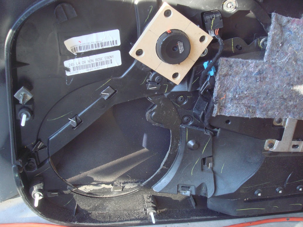

Did the speaker install require heavy modification of the doors?
Nope. I had to make the 4 screw holes larger to support larger bolts, but that’s all. Since I used all my own wiring, the factory speaker connections are still in tact, should I ever need to revert the speakers back to stock.
