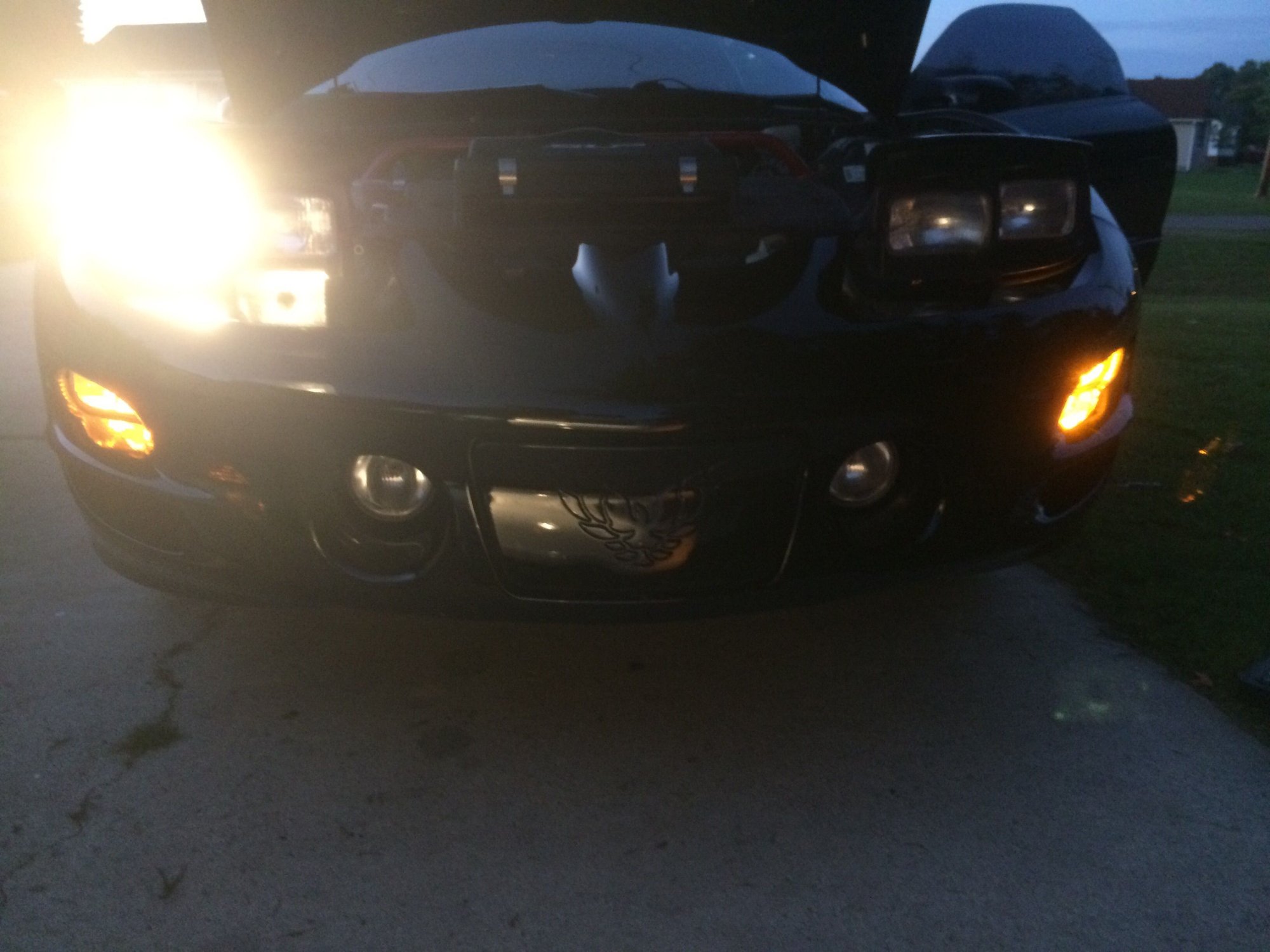

Ok so I tried to re ground that turn signal, this was the outcome..
Headlight/brights won't work now and now the passanger side t/s is a lil dimmer than the driver side... <br/>So now I'm thinking I don't know what to think lol..<br/>And idk if this is suppose to happen but the front driver side marker blinks with turn signal while the other side doesn't..

Ok, so thank you all for the help!! White bird, you're my hero lol. Problem solved, my splice wasn't good enough I suppose. But now the headlight won't work as mentioned before... And I tested the bulbs, they work.

Did you end up fixing the original ground to the signal lamps or did you splice in another ground wire? The headlights share the same ground on the radiator support so if you didn't fix that factory ground, it could still be the source of your problem with the left headlight. Also, check that you didn't dislodge the 5-pin connector for the left headlight while you were working on the signals lamp.
