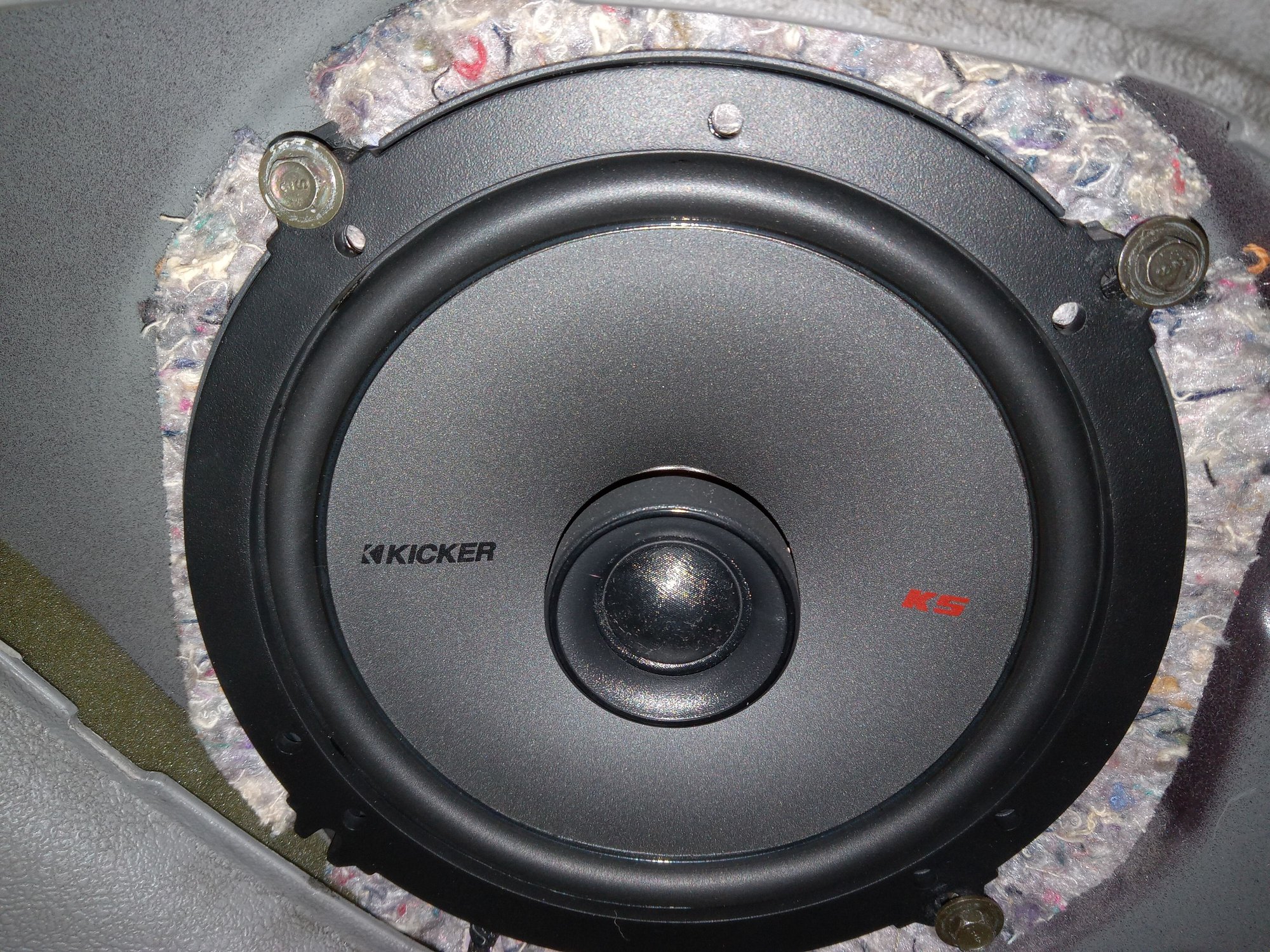

Kicker ks. Is this telling?

Those are decent speakers at a reasonable price but they're not what should be in the sail panels. They are coaxial, full range speakers designed for treble, mid-range, and some mid-bass but they don't produce a lot of bass like a subwoofer does. Also, they are single voice coil (SVC) whereas the the factory subs are dual voice coil (DVC) so you are giving up power from the amp, which is probably part of the reason they don't sound full. Bear in mind that the 10-speaker system's amp provides low frequency signal only so you're not getting the full capabilities of those speakers either.
Kicker make 6.75" CompRT subs that are a popular choice but they're about twice as expensive at $120 each. A very popular choice is the Bazooka 6.5" 4-ohm DVC sub from Kee Audio for $110 a pair or they're also available on Amazon (listed as a 6" but are actually 6.5") for a little more ($60 each). Install a pair of those in the sail panels and move your Kicker KS speakers to the doors and I think you'll be quite satisfied with the sound.

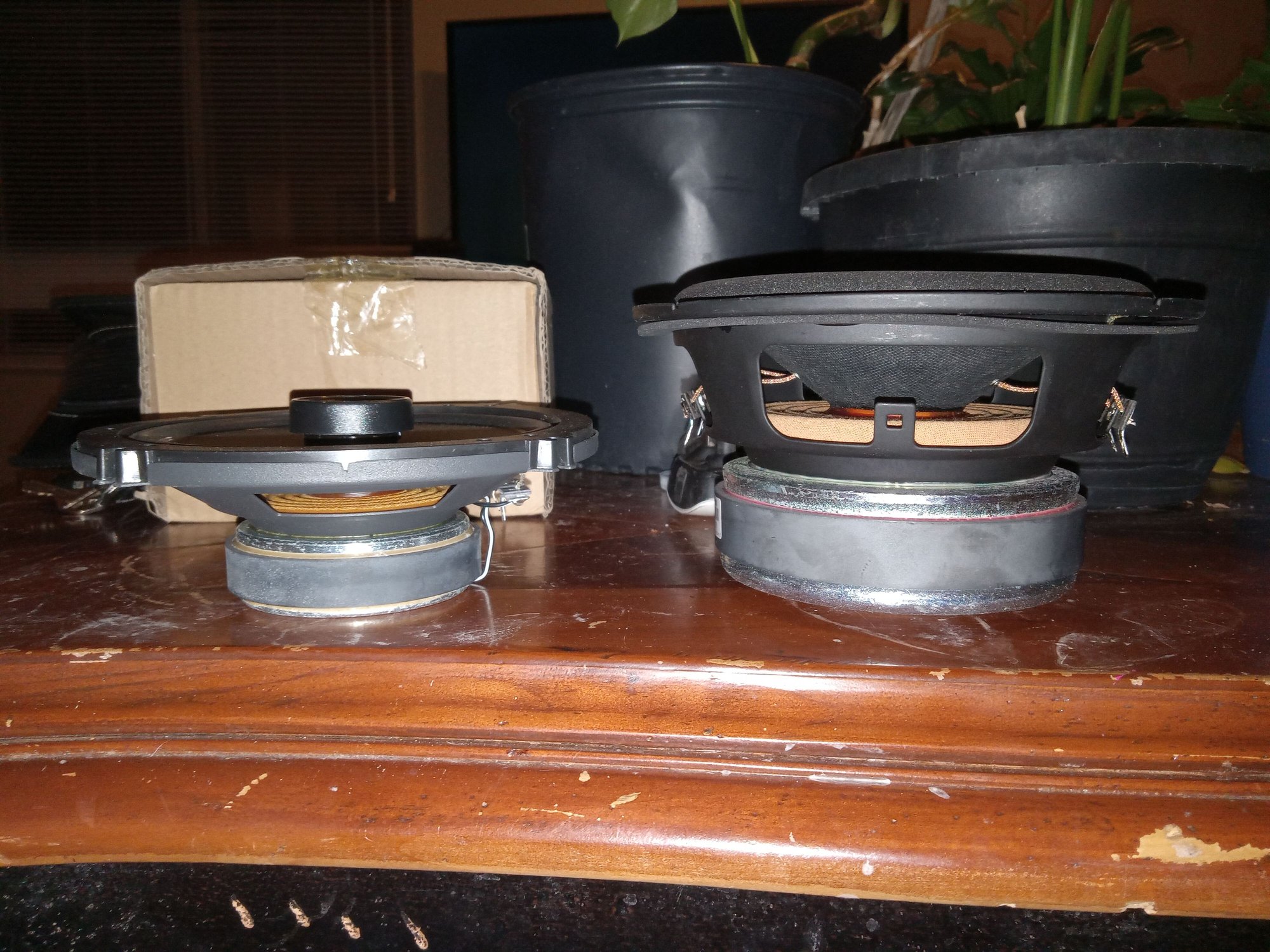

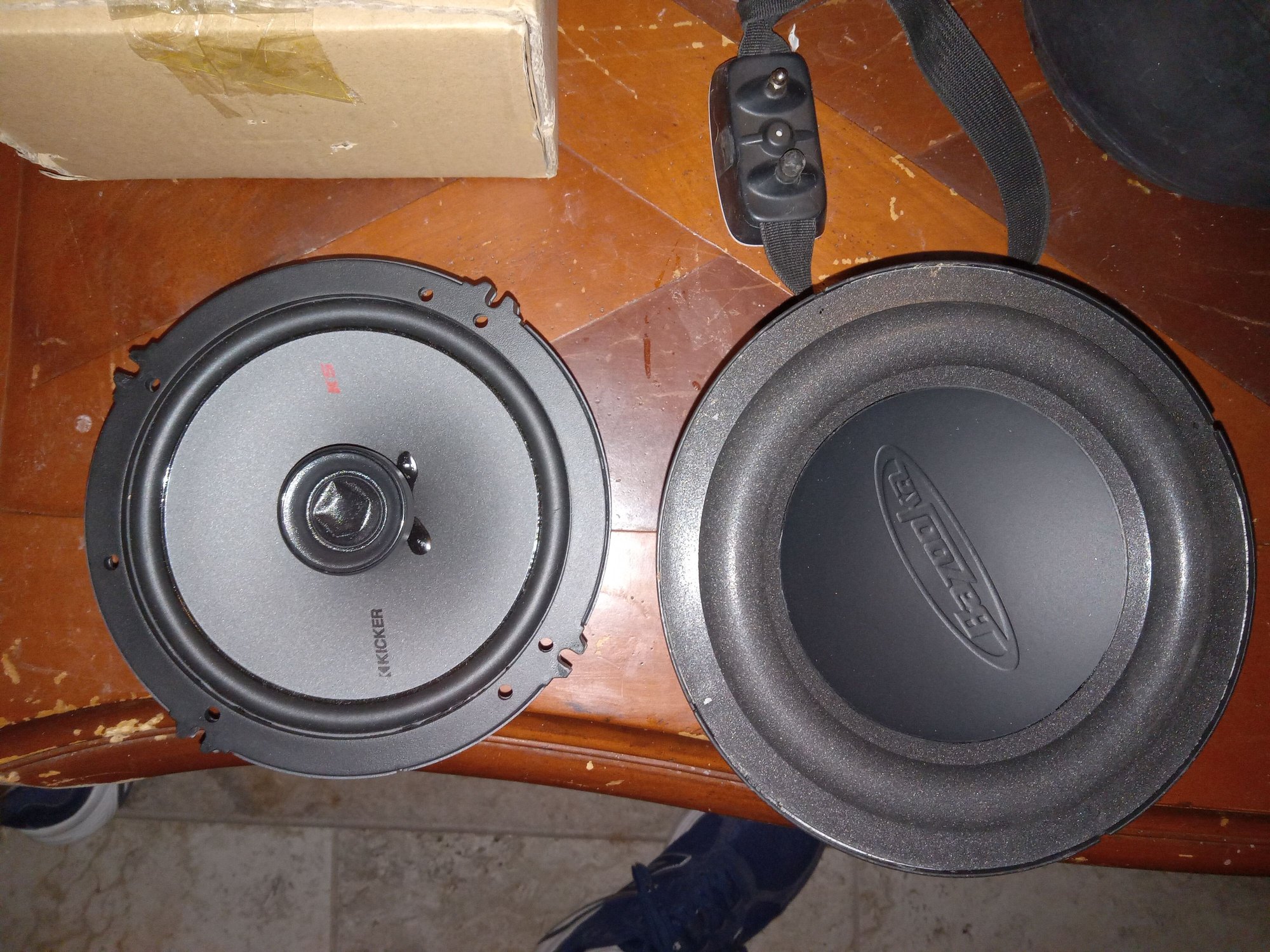

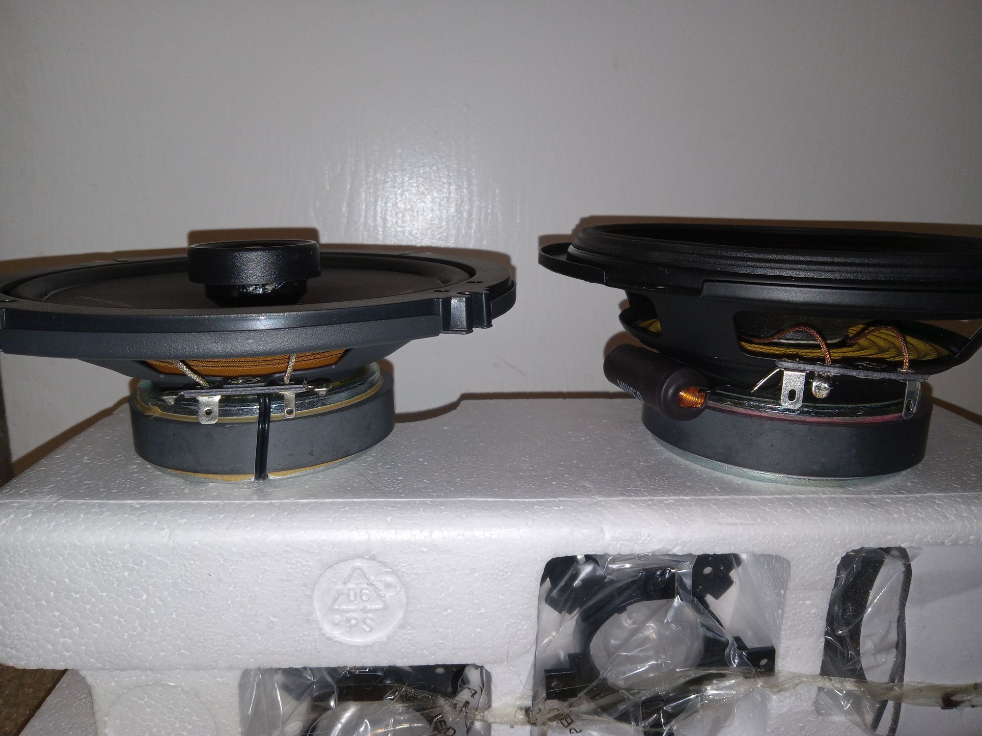

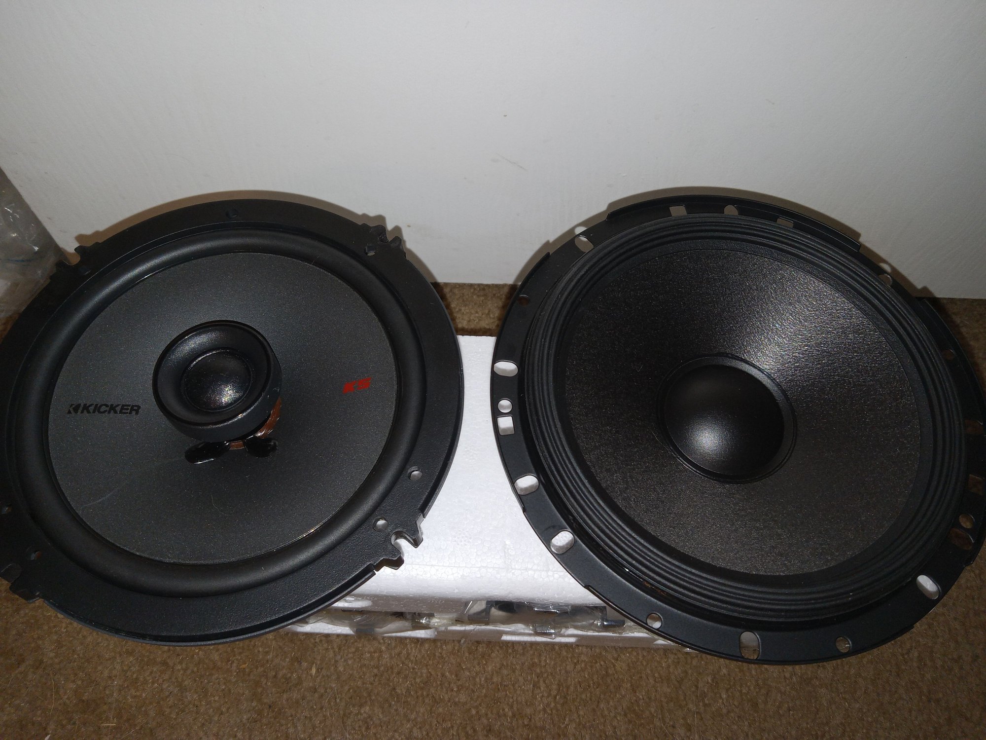

Just to be clear, this is a sub woofer in name only? Then my last question is what makes a sub an actual subwoofer? Here's a couple pics I snapped of the alpines next to my kickers. Connections are definitely different and that battery thing on the Alpine, and the alpine having double connections, assuming needing to be connected to the tweeters to function, correct?

The definition of a subwoofer is somewhat fluid. Most people refer to any speaker designed to produce low frequencies as a subwoofer and this is not entirely wrong for general discussion of audio frequencies... bass, midbass, midrange, and treble. Most lump bass and midbass together as frequencies played by subwoofers but technically midbass is output through a woofer or specialized midbass speaker. They don't get quite as far into the low frequencies as a true subwoofer but they can add a bass punch without requiring as much power.
In f-bodies, the sail panel speakers are midbass which provides plenty of low frequency sound for the average user (remember, we're talking about mass produced car audio systems - the average buyer isn't an audiophile and just wants decent overall sound). Adding a subwoofer in the back will give you bass frequencies below the range of the midbass, adding that "feel it as much as hear it" sound. I'm way too old to want rattling windows so I never did that, but lots of people really like it.
The Bazookas are midbass so they match the factory configuration very nicely and will give you a nice full sound with good bass even if you don't add a true subwoofer. Adding a subwoofer with its own amp can make the sound quite impressive.
As far as the difference between your Kickers and the Alpines... the Kickers are coaxial whereas the Alpines are components. Coaxial speakers are basic full range speakers with a built-in tweeter to handle treble (high frequency) sound. They are a single speaker but with the high and mid/low frequencies split into two speaker elements. Components consist of woofers and tweeters that are actually separate speakers powered by separate channels of the system. In this case they don't really look different because the tweeter is mounted in the middle like in a coaxial speaker. But they don't have to be mounted that way... since they are separate speakers, the can be mounted in different places, like they are in the doors of a Firebird.
The Kickers have only one pair of terminals because of being coaxial - it's one speaker so only one channel and one pair of wires. The Alpines have two pairs of terminals because each component (woofer and tweeter) are separate speakers and each needs its own channel and pair of wires.

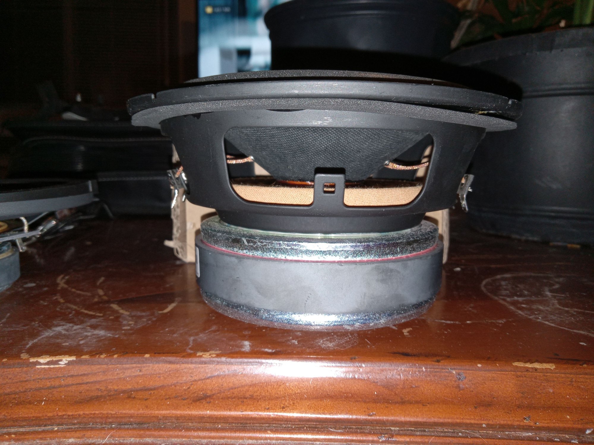

Does it matter which side I choose? And damn, bigger than I thought <twss!

No, it doesn't matter which side you install each speaker. The bigger magnet is a typical feature of subs when compared to other speakers.

Sorry, I meant to hook the wires up. Each bazooka has connections on both sides. Without telling a difference I just wired picked a side. I can tell a difference already with just a Steve Miller song that was on the radio.

Oh sorry. But the answer is still the same - it doesn't matter which pair of terminals on the speaker get which pair of wires as long as you do them in pairs (i.e. the positive and negative from the same pair on each pair of terminals).
