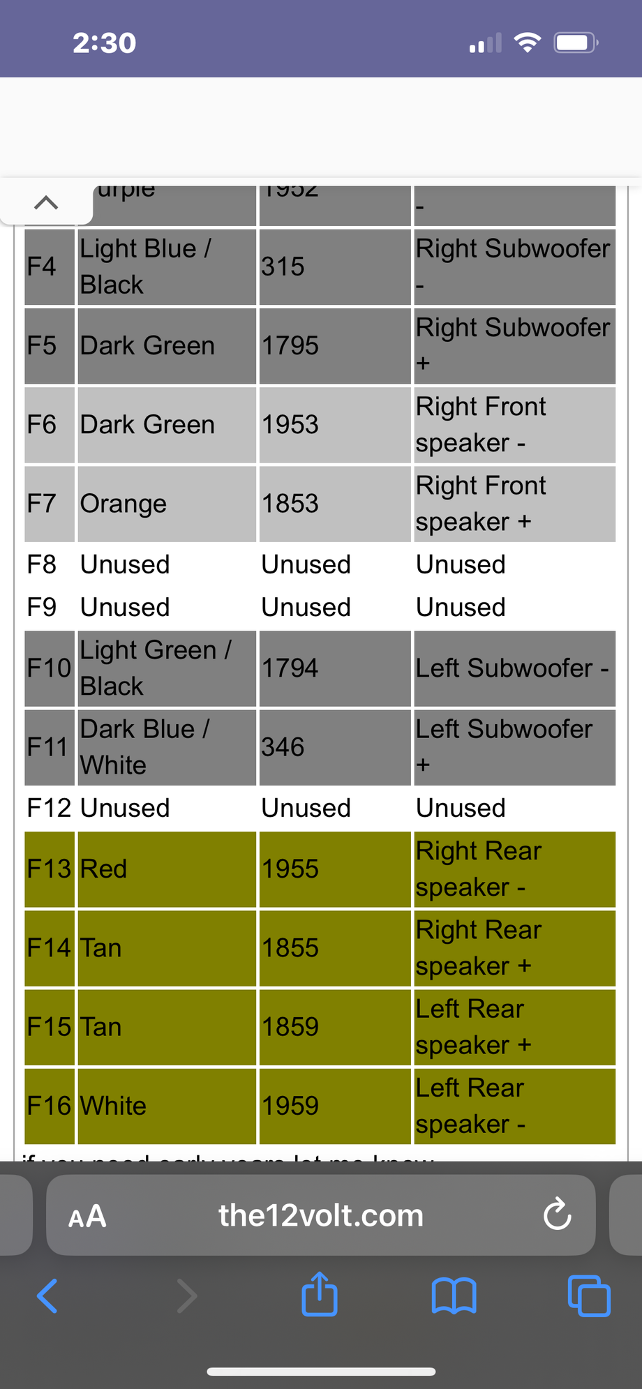

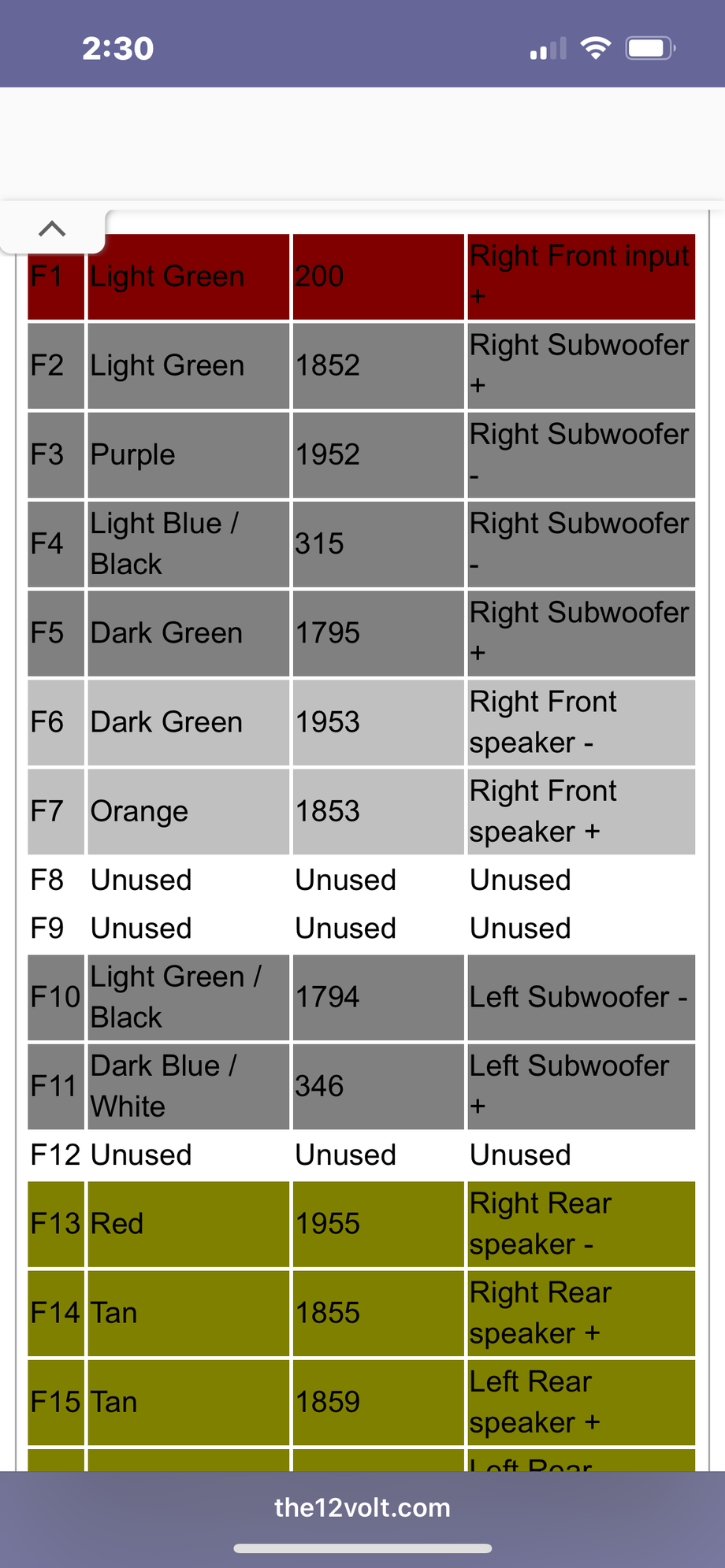

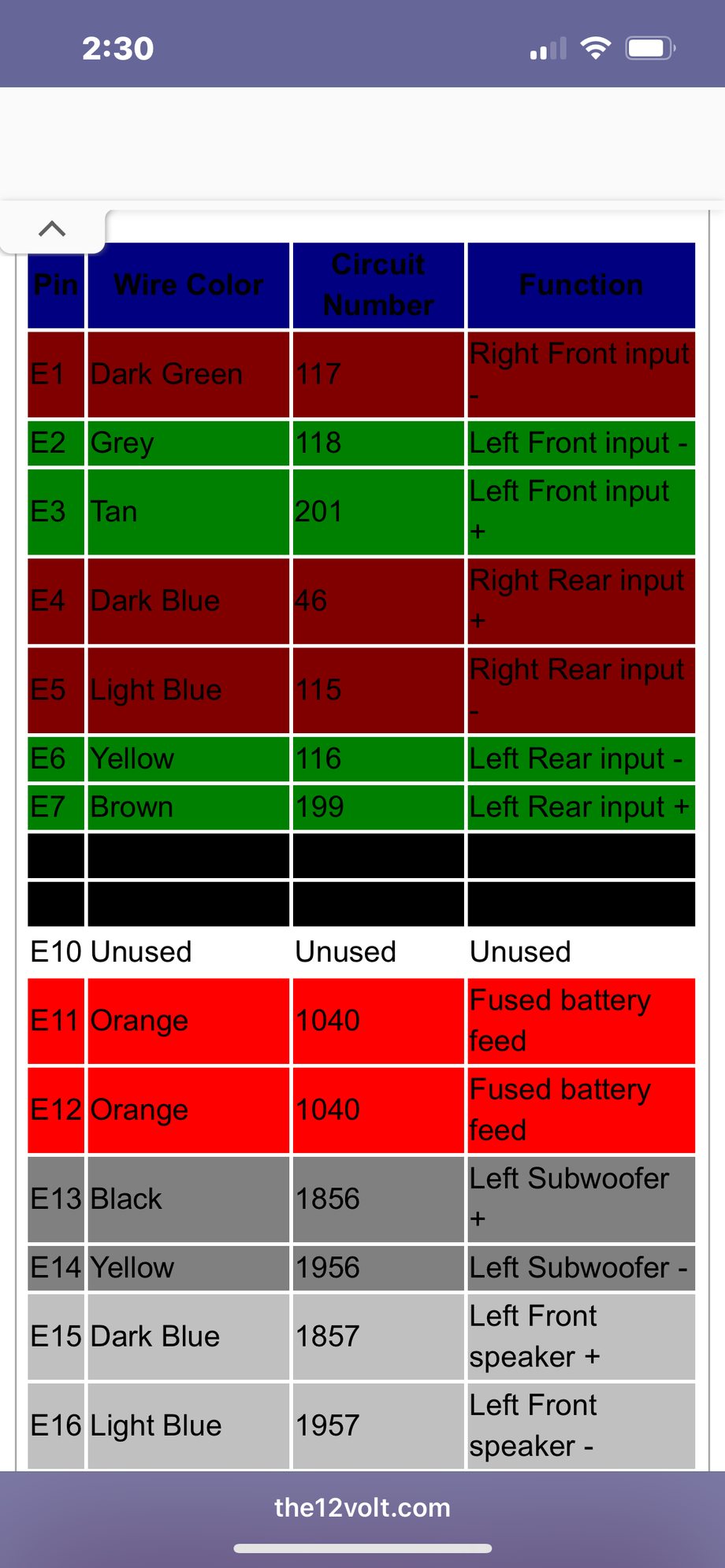

I have a 98 z28 I’m trying to find the amp pin out as I replaced speakers and radio so I’m bypassing the amp but all I see is pin out for 00 and up and I tried to follow them but only got my two door speakers to work and the sail panel speakers my pins are different colors than what I’m seeing people posting anyone have a pin out on a 98 Camaro

Found it for Camaro
