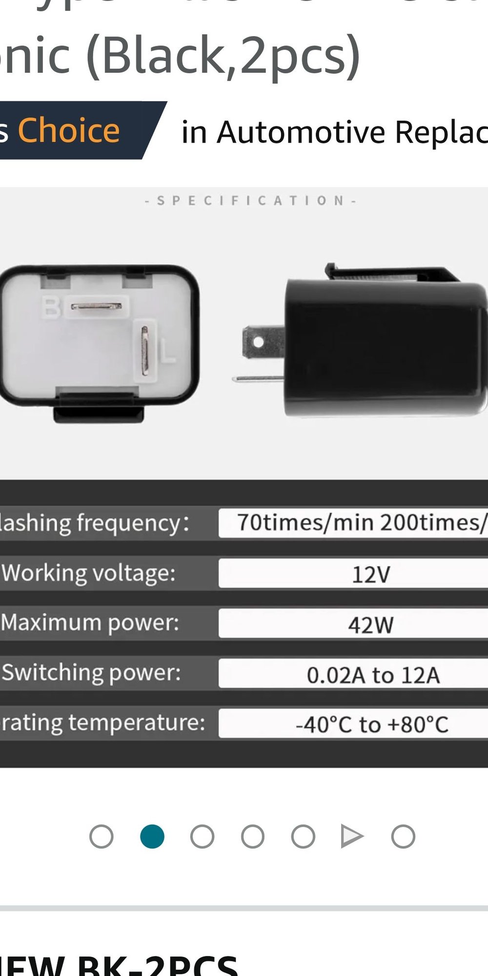

I'm not supposed to do this because forum rules prohibit posting links to non-sponsors, but I doubt anyone will object to an Amazon link in this case. This is an adjustable LED flasher that will allow slowing flash rate to as low as 50 flashes per minute...
Amazon Amazon
... $11 for a pair so that you can slow your hazard flashers as well as your turn signals. Setting them to 60 FPS or slower should take care of the problem nicely. They are simple plug and play although the shape is wrong to fit the factory mount - you can always just zip tie them in place.

Do you think they updated it and changed it to 70?
Old Mar 24, 2024 | 01:24 PM
WhiteBird00's Avatar
Ungrounded Moderator
Joined: Nov 2003
Posts: 11,332
Likes: 347
Not according to the text of the listing. It says 50-200 times/minute. But you're right - I don't know whether to trust the text or the images (it also says 70-200 right on the side of the flasher). This is the "new” version... I linked it because it has the adjustment **** on top. It might be safer to get the old version that requires a screwdriver to turn the adjuster located between the terminals on the bottom... not as convenient but how often would you need to adjust once you've got it the way you want? It clearly says 50-200 in both the text and images.

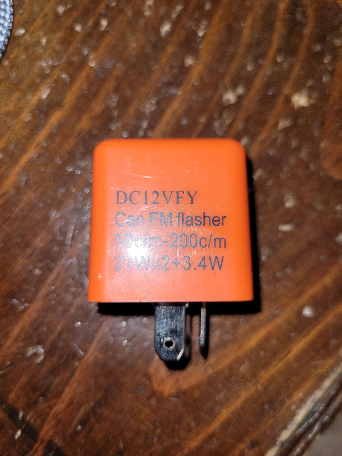

I found this one which I tried a while ago. I'll try it again just to see if it was adjusted wrong but I think it's still too fast. What's weird is my friend has the same car and unit witch is definitely slower.

Note that the speed control is counterintuitive - turn clockwise to slow and counterclockwise to speed up.
