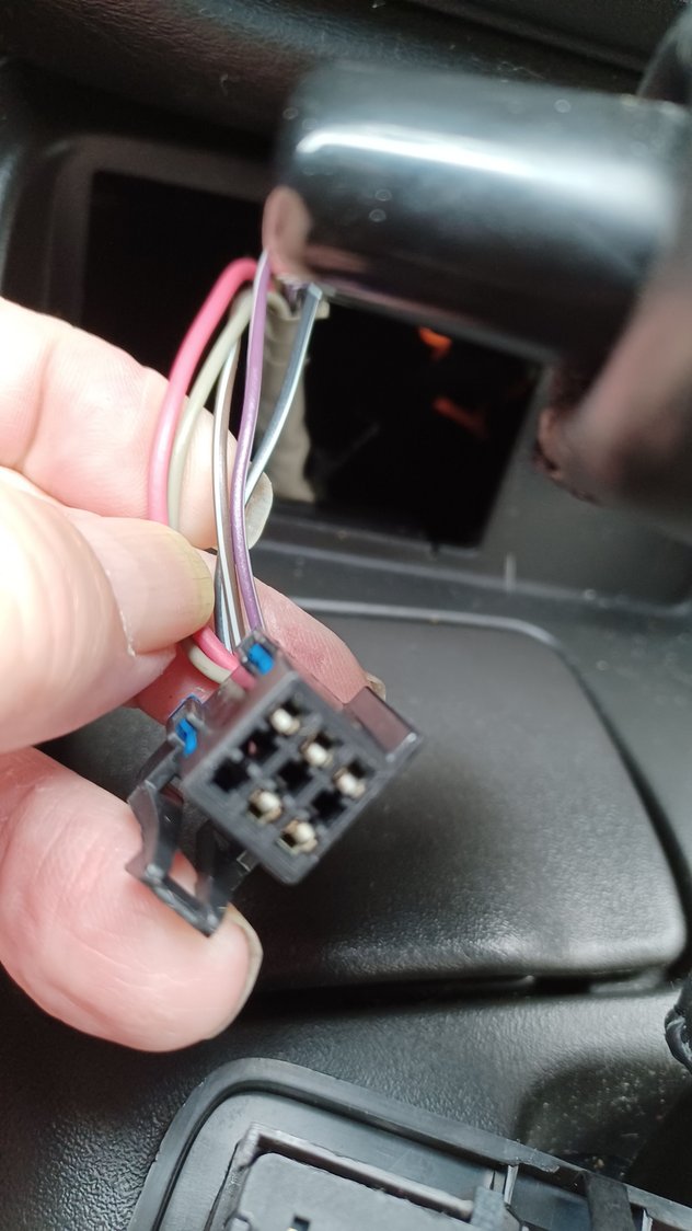

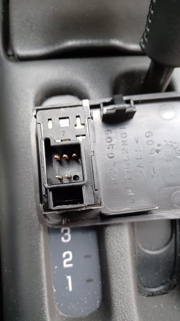

Took these pics of the switch and wire harness in my 2002 trans am. It's different than what you posted, but maybe the difference could be an Automatic vs Manual trans? I need a wire diagram.

The extra wires are merely for the indicator light and switch illumination. The functional part is a momentary switch connecting the brown/white wire from electronic brake control module (EBCM) to the black/white wire which goes to a chassis ground. Connecting those two wires together should achieve what you're looking for although I don't know if the EBCM might freak at a constant ground on what is expected to be a momentary ground signal (I doubt it would be a problem but it is possible).

For a quick test just run a jumper wire between those mentioned wires on the connector and see if that dosen't solve it for you.
Will try that before cutting and soldering new wire. Thanks. It would still be nice to have a wire diagram.
