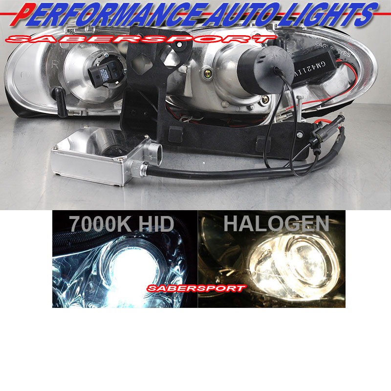

Hear me out. this is the back of the ebay projector headlights:
Is it possible to cut these open, and cut open my stock headlights make a hybrid of the two that utilizes the projectors but without the funky halos and LEDs and black bezel? I basically want stock headlights and projectors. I am thinking of doing it, but am wondering if it has been done before. Nothing came up on search, but then again i really didn't know what to search. Thanks

Sounds possible and may make for some sweet headlights... but without having one of each in my hands and looking at them up close, I can't tell if it's possible. Gonna keep an eye on this though.

first off, no you can't do that. The projector bowl is built into the housing. Second, those projectors aren't that great for light output anyway, you'd do better to get some tsx projectors or something like that to use to retrofit your stock housings with.

some better searching yielded a good thread:
https://ls1tech.com/forums/appearanc...r-project.html
Cliff notes:
-ebay projectors suck. they are no better than stock headlights
-the ebay projectors are small, so simply swapping out other projectors isn't easy
-the guy who made that thread gave up on the project.
I think I may do this:
https://ls1tech.com/forums/western-m...ave-again.html
minus all the fiberglassing. It won't be pretty, but I really just want better lighting. Basically I will need a spare set of headlights to cut up, and some projectors. I have now, until summer when I have time to be adventurous to find cheap projectors. Just figured I'd pass along the info.

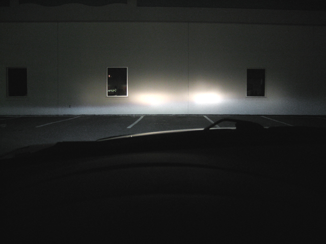

You're welcome. Have fun with the project. Check out the install threads at the Forums at HID Planet. You'll see how people have installed these and other projectors. Some people used the shrouds in that kit some people used other shrouds or made their own.
One thing to remember that some people forget... in addition to making sure the projectors are installed straight and not rotated, also compare them to the stock high beams to make sure everything is aimed properly since the high beams can't be aimed separately. What I mean is turn everything on and look at the beams aimed at the wall at least 20ft away. The projectors should produce level lines and aimed straight forward. The high beams should be slightly higher with an slight overlap at the upper edge.
Something like this (not perfect, but its easy for me to change since on the Firebird the high and low beams are separate):

Good info. Thanks man. I hate aiming headlights. I've never been good at it. I checked out those install pics during my earlier research and I have a general idea of how I want to do it. There is actually a tutorial posted on aiming headlights too if anyone else is interested. It may sound childish, but I am so excited for this mod. I love good lighting. VIP, I'm gonna link you up with picture of the final product when its done next summer. I have some cool ideas in store Thanks again for all your help!
link to headlight aiming FAQ: http://faqlight.carpassion.info/hl-aiming.htm
