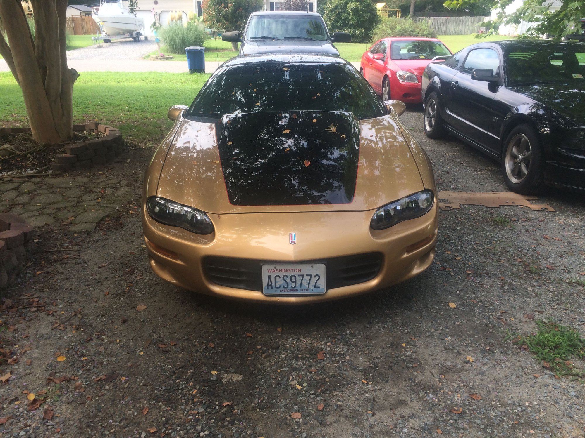

Depots from Amazon, happy customer here.
