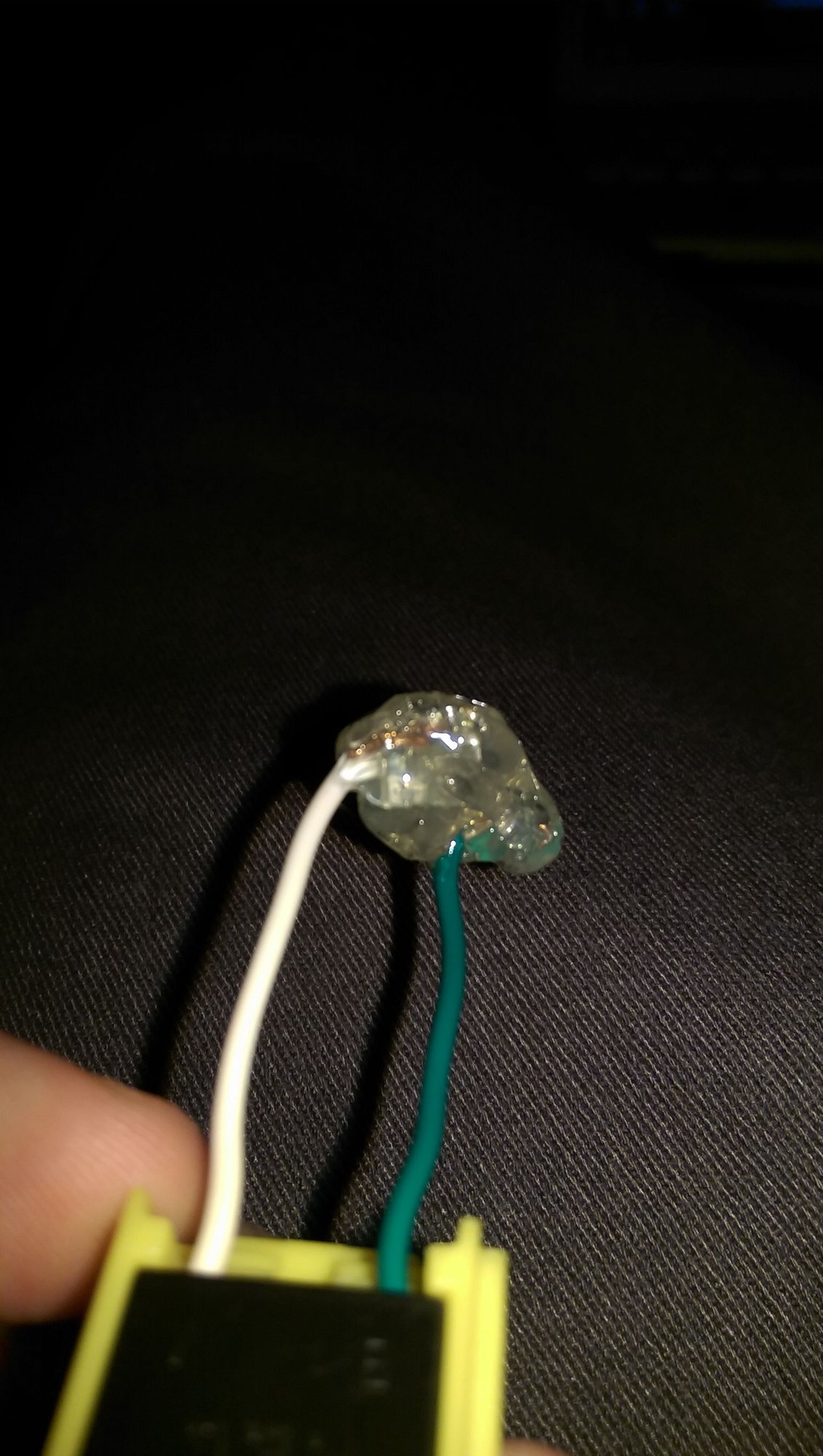

I just checked my resistors. I don't have a 2.2 ohm unless I'm looking in the wrong spot. I have a 220 ohm one though. Can anyone confirm which resistor it is for the air bag?
Look at how I got glued it together

Resesistor istin plugged in
Resistor soldered and hot glue insulation
