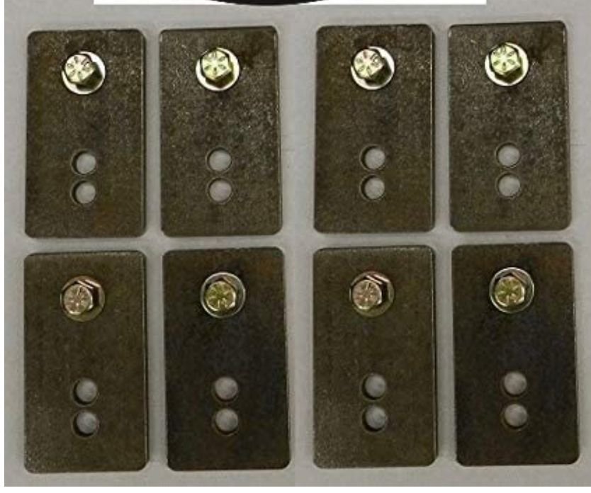

I too am 6’3” but don’t have a height problem but a legroom problem. Have you ever noticed how much more room there is behind the front seats when they are all the way back?
I just ordered these for both front buckets and hope the extra 2” of legroom will do the trick.
Amazon, $53 plus tax

sure, sorry I didn’t include a link in my first post.
it says they are for old cars but I think I remember a thread on here about someone installing them on a 4th Generation
Amazon Amazon

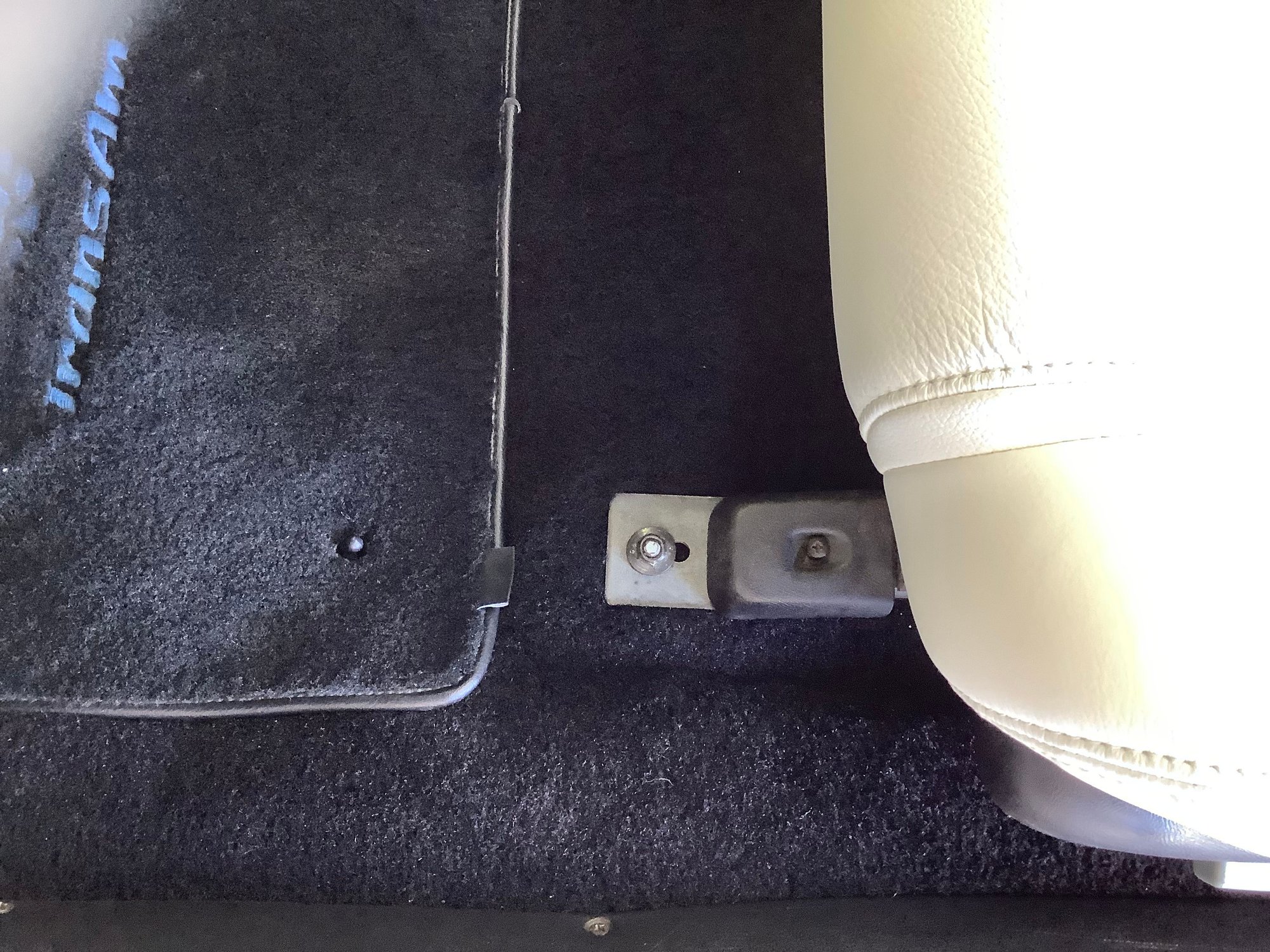

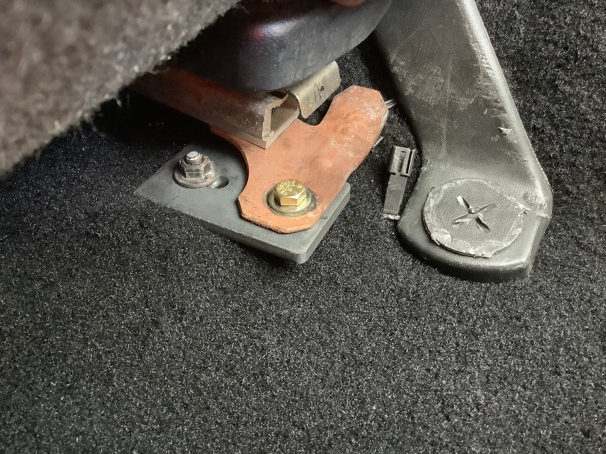

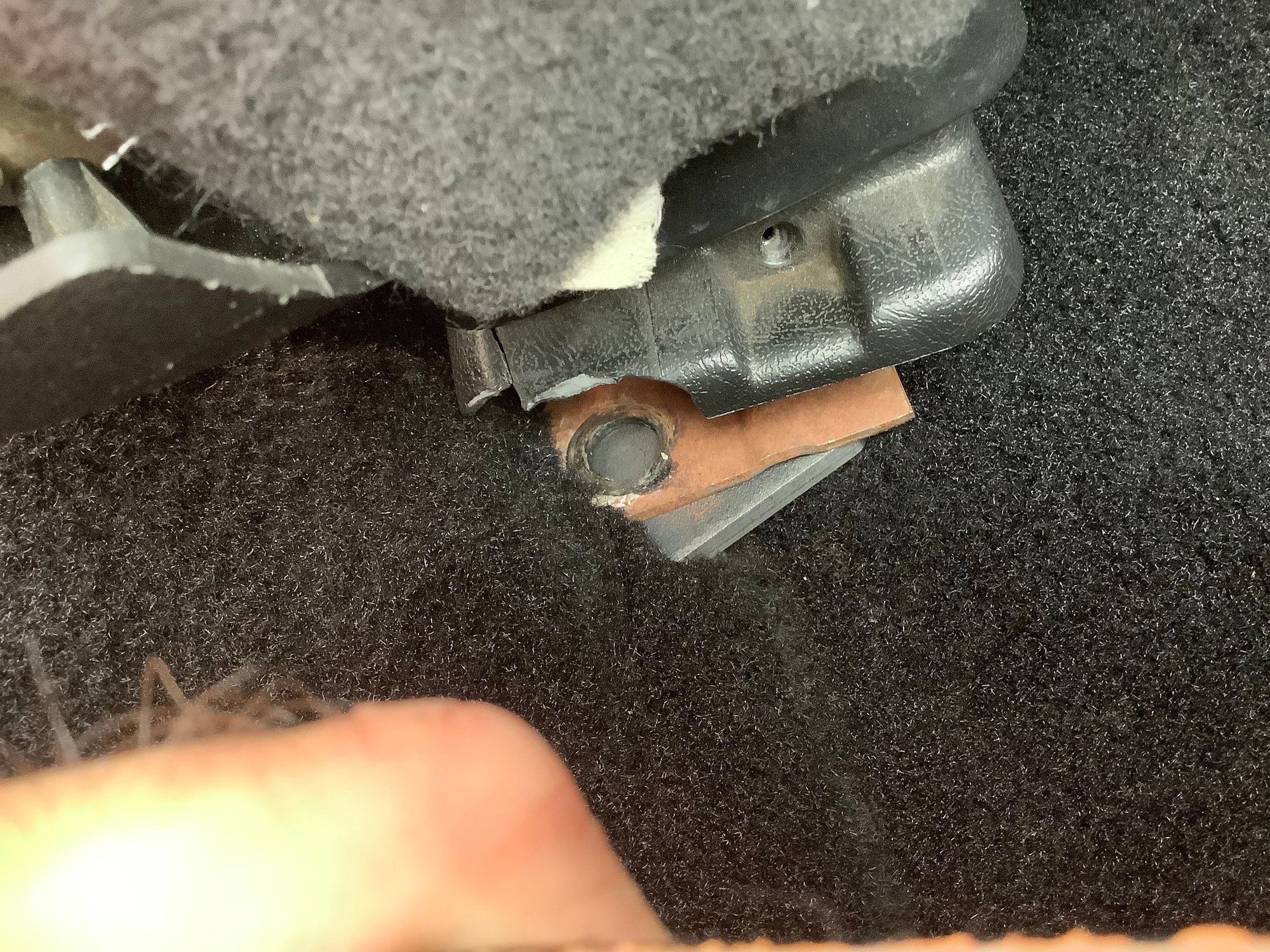

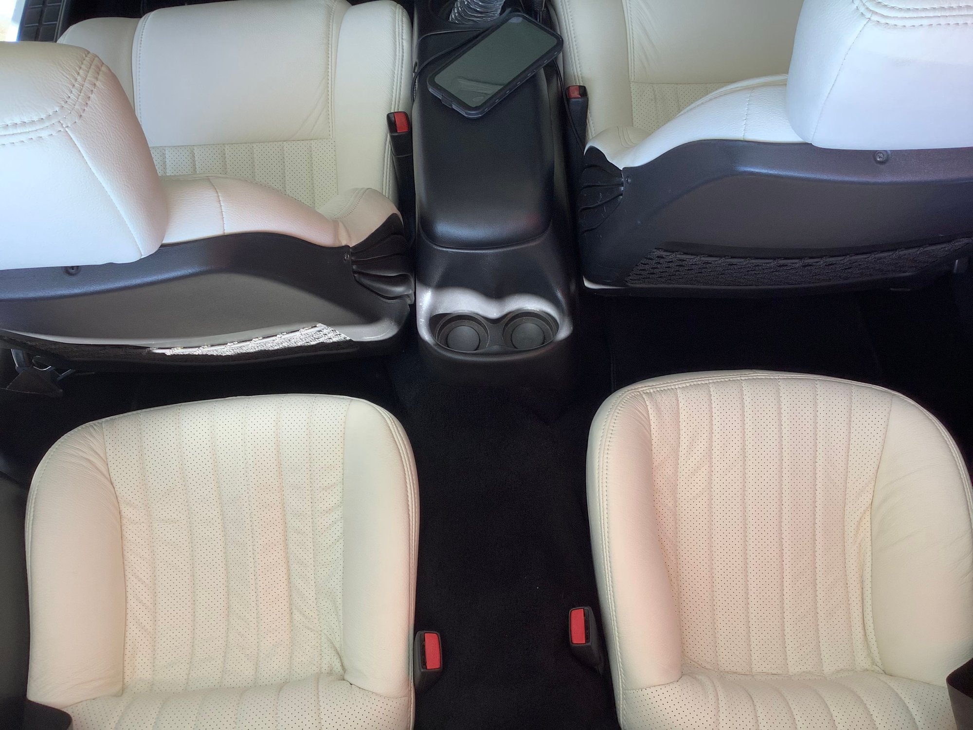

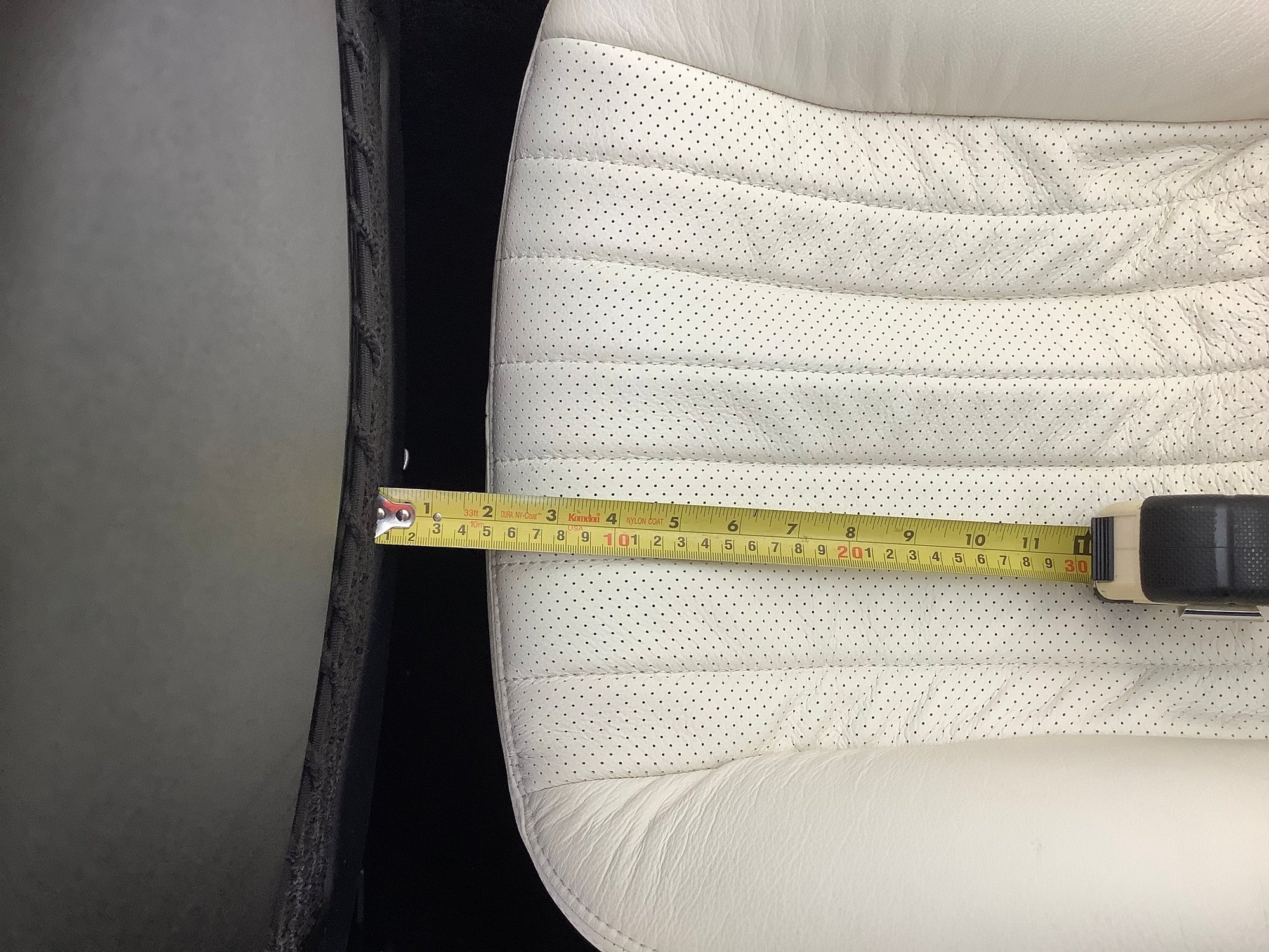

@2000dreambird
I received the extenders today, three bolted up fine, the rear door will either need to be ground to fit or I can drill a new hole and tap it.
i am leaning toward the later.
with that said, I like the additional leg room, I can tell the difference when I get in and out.
the brackets are about 1/4” thick so they raise the seat that much…not good for us tall guys.
Before
After
Need to move the cover
Won’t line up, I think I will drill a hole and tap it.
You can certainly see the difference between the modded drivers vs the UN-modded passenger
