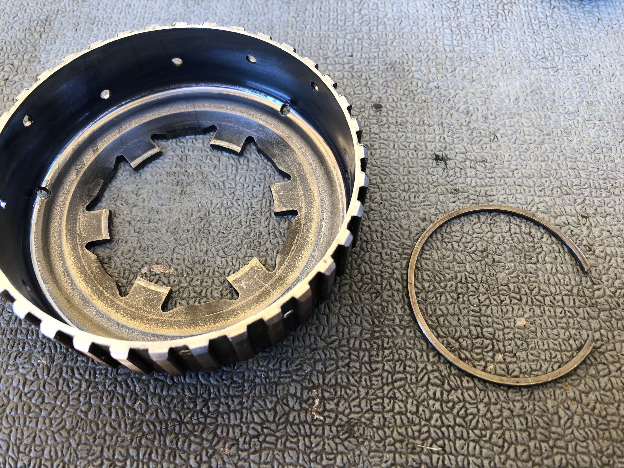

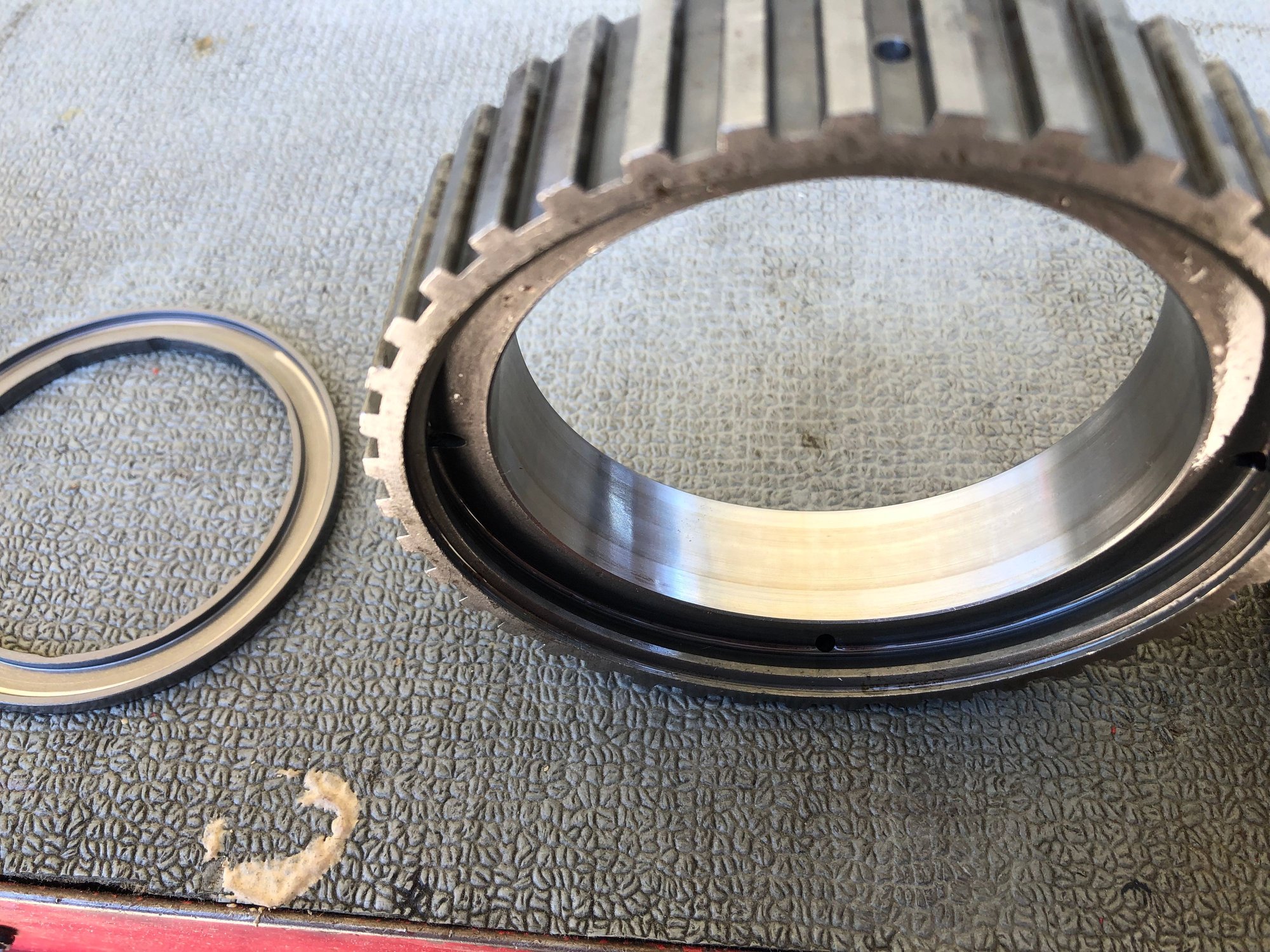

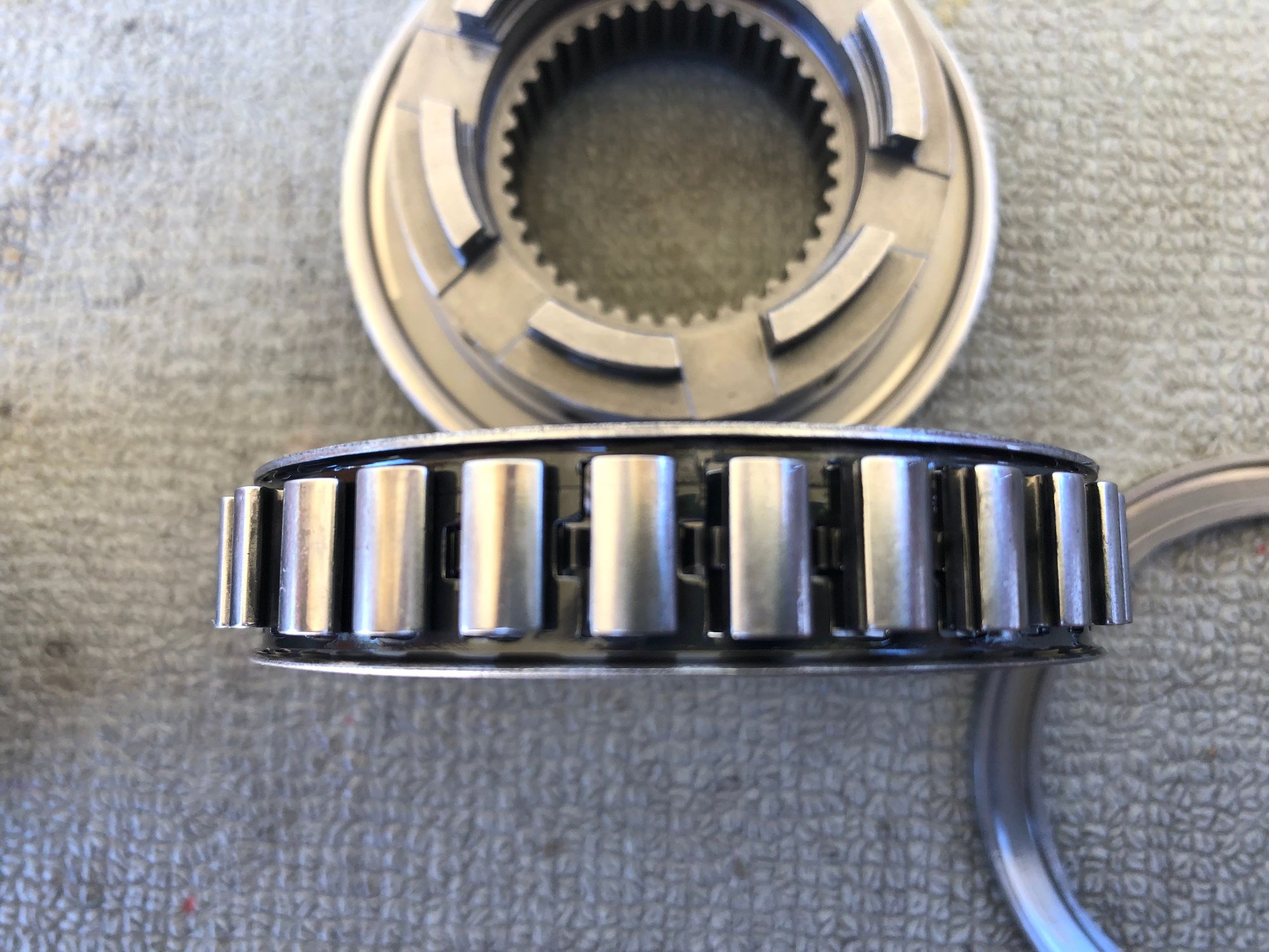

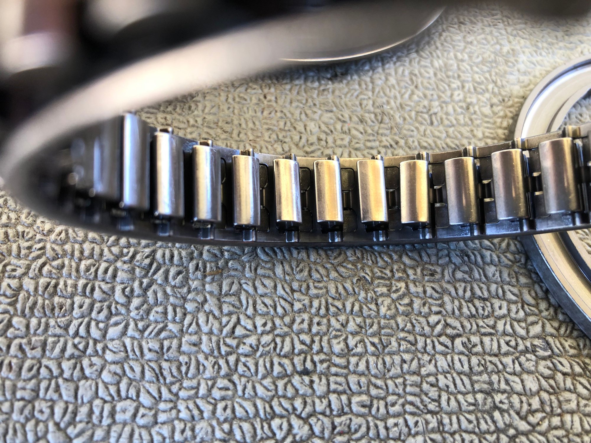

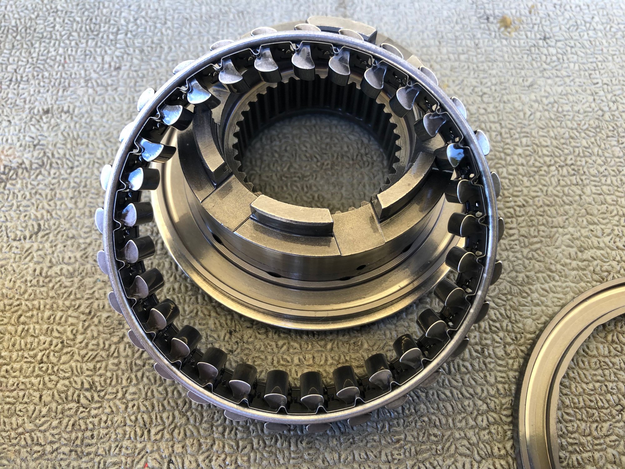

Is the sprag wiped?
They can be in the right direction and not hold at all.
Post pictures if you can
Old Jul 5, 2019 | 03:16 PM
airsick's Avatar
Joined: Jul 2019
Posts: 7
Old Jul 5, 2019 | 04:38 PM
airsick's Avatar
Joined: Jul 2019
Posts: 7
Bummer... looks like the 3-4 clutch pack clearance is about 0.135 100% now assuming that this is the issue?
