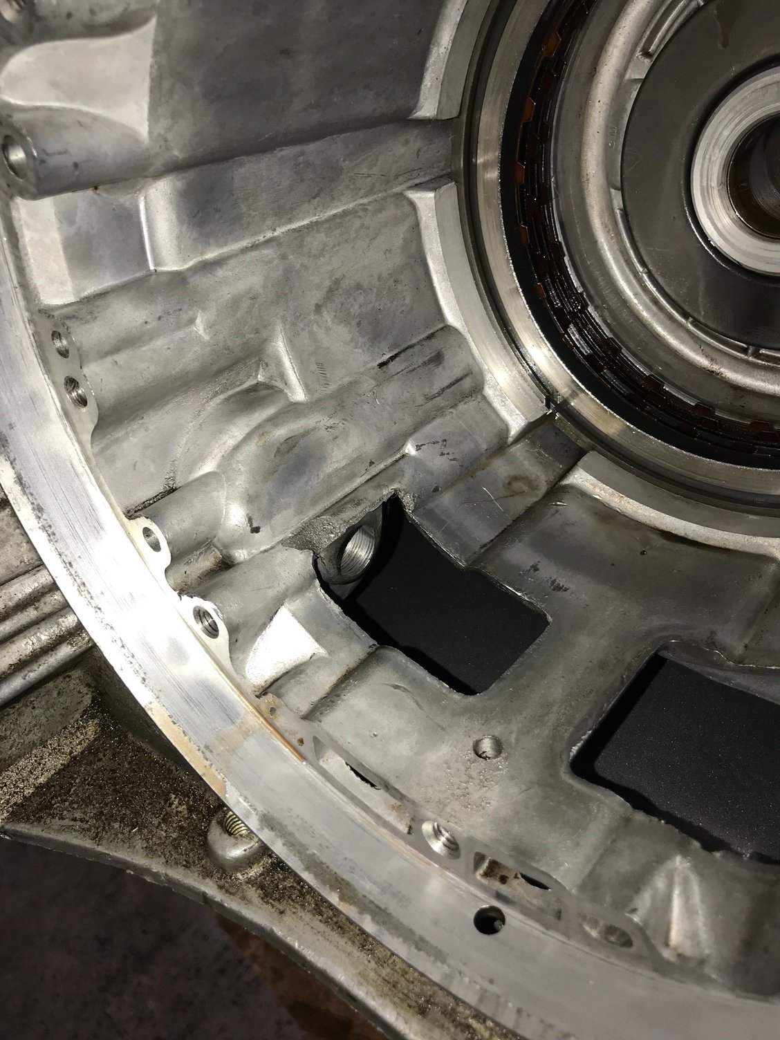

Started disassembling a powerglide I purchased for $200, I was told it was mint and no issues (yeah ok)
I pulled the pan and found some metal so I started to dig deeper, pulled the pump and found a chip on the case on the servo side. This is my first automatic I've only dealt with manuals before this. So my question is, is it worth rebuilding/repairing?

not really a great picture...looks like the servo pin or adjuster pin area? What's actually broken, just the small piece we can see, or something more major?

What is pictured is the servo pin area, that's the only broken part that I have discovered I don't know what would cause it. I was thinking I can clean it up and weld it to strengthen it and reuse the case .

if it hasn't gotten into anything structural, I wouldn't even weld it. probably do more harm than good.
Sounds good, I'll inspect further for damage but that's looking like it. Thank you for your input!

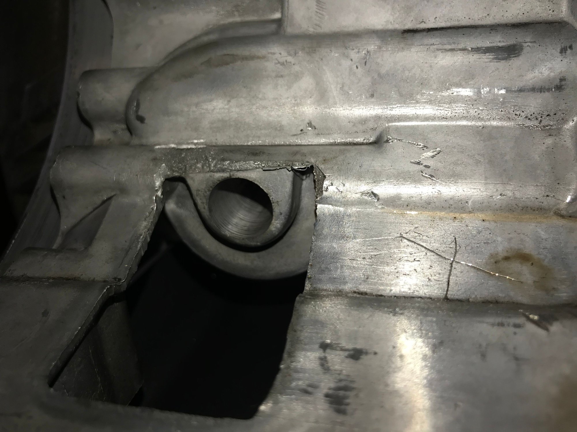

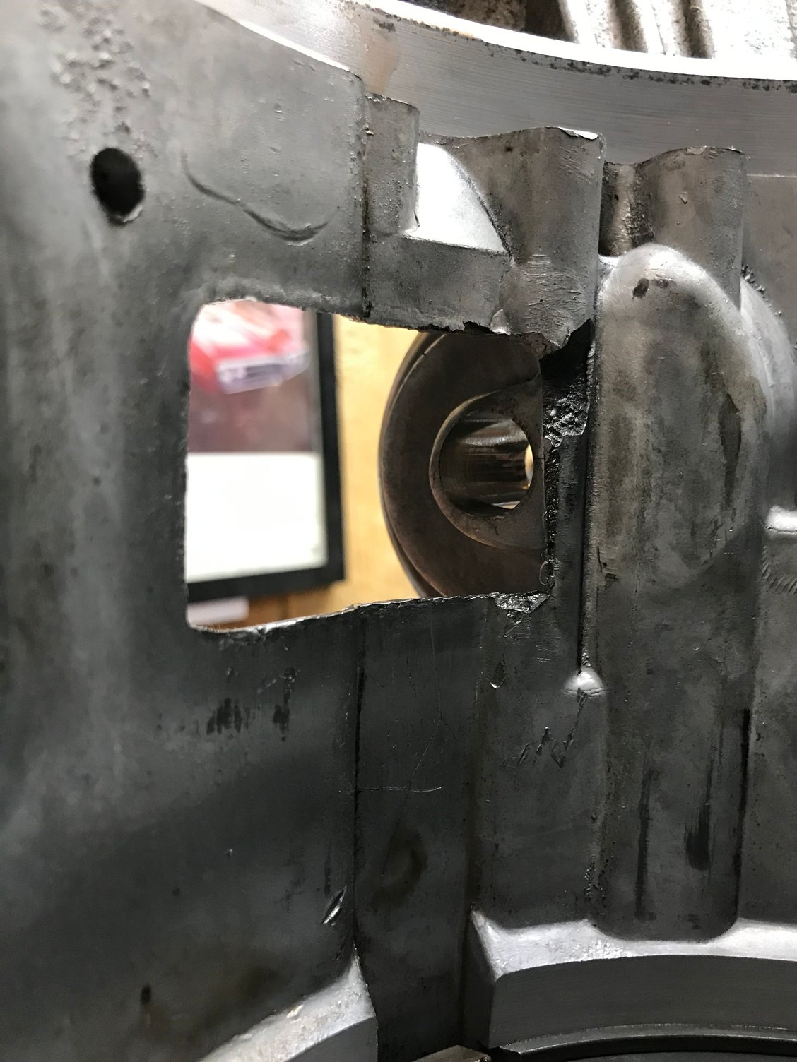

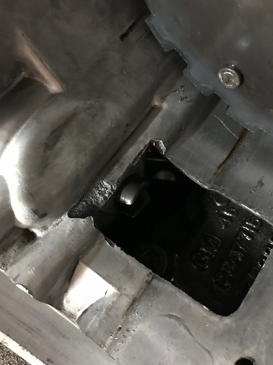

He
re are a few more photos

yea...it's a damn near 60 year old case...it's gonna have some wear and tear.
That wouldn't scare me a bit
on a side note...if you're trying to make some serious power...I know aftermarket cases are expensive...but at least look into them...if you don't want to swing the budget, then get a shield at the minimum. That 60 year old case was designed for about 2000 rpm from about 100 hp...not 8000 rpm from 1000 hp...your safety should be taken into account on this one

Looks like you got lucky...
