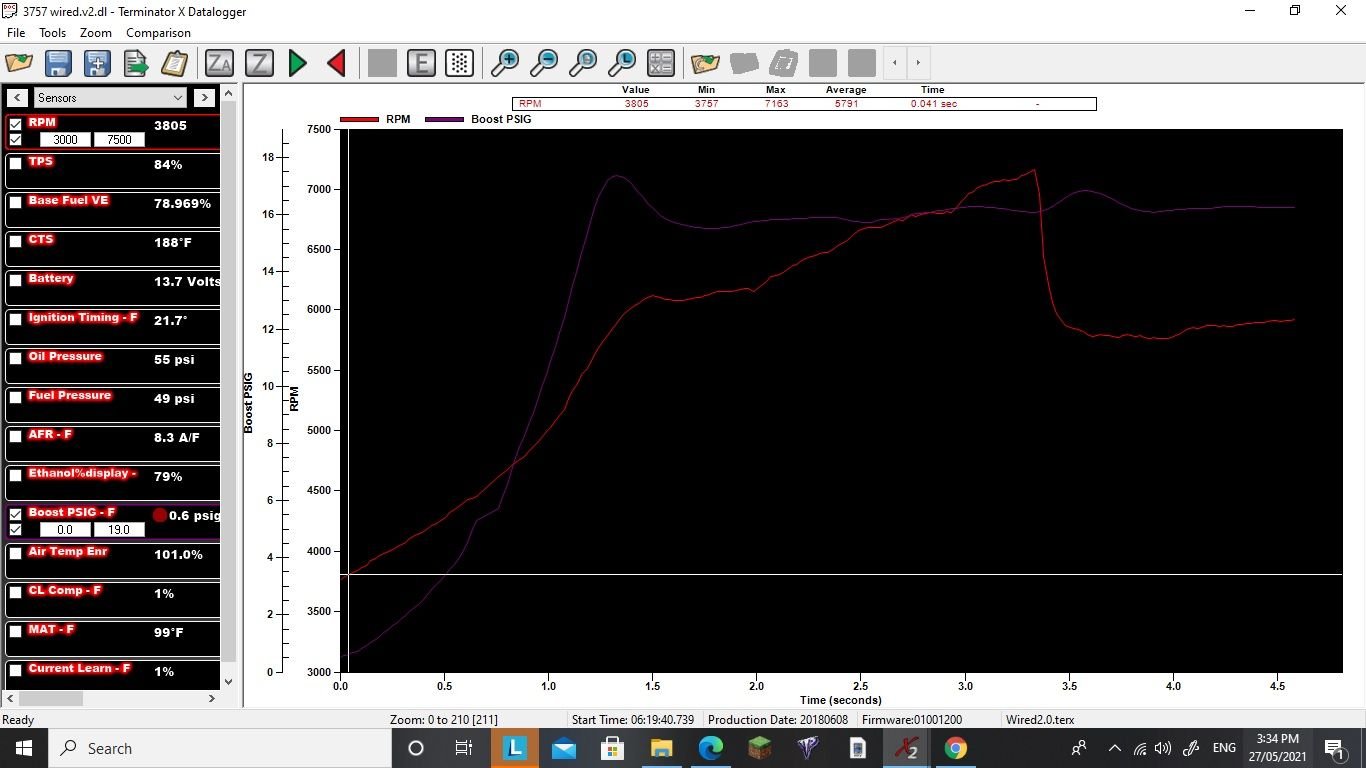

Ill get a data log later today, basically shows straight up to 2800 then rpm curves in same as boost 1 second upto 17psi and 6000rpm. Then take another 2.5seconds to 7200 and shift point.
2nd gear I only get out to 6200 on these runs.

Old May 27, 2021 | 01:09 AM
lscamaro234's Avatar
Joined: Feb 2019
Posts: 157
dropped my converter off to the place where it was built today , i figured cant hurt to cut it open and have a look at this one first . He thought from the colour , definitely has been way overheated probably from a lack of fluid flow. Has suggested finding a trans shop that has a flow machine that can test it ?
any merit to this ?
this is the trans im running
Coan Racing COA-11128 - INSTANT REACTION 28" W/PRO TREE 5 BRAKE, STEEL HUB, 300M ALLOY SHAFT (TH SPLINE), "EXTREME DUTY" PLANETARY, 8 CLUTCHES, BILLET SERVO, DEEP ALUM PAN - Powerglide - Transmissions
finding it hard to believe the trans is the problem .
any help ?
