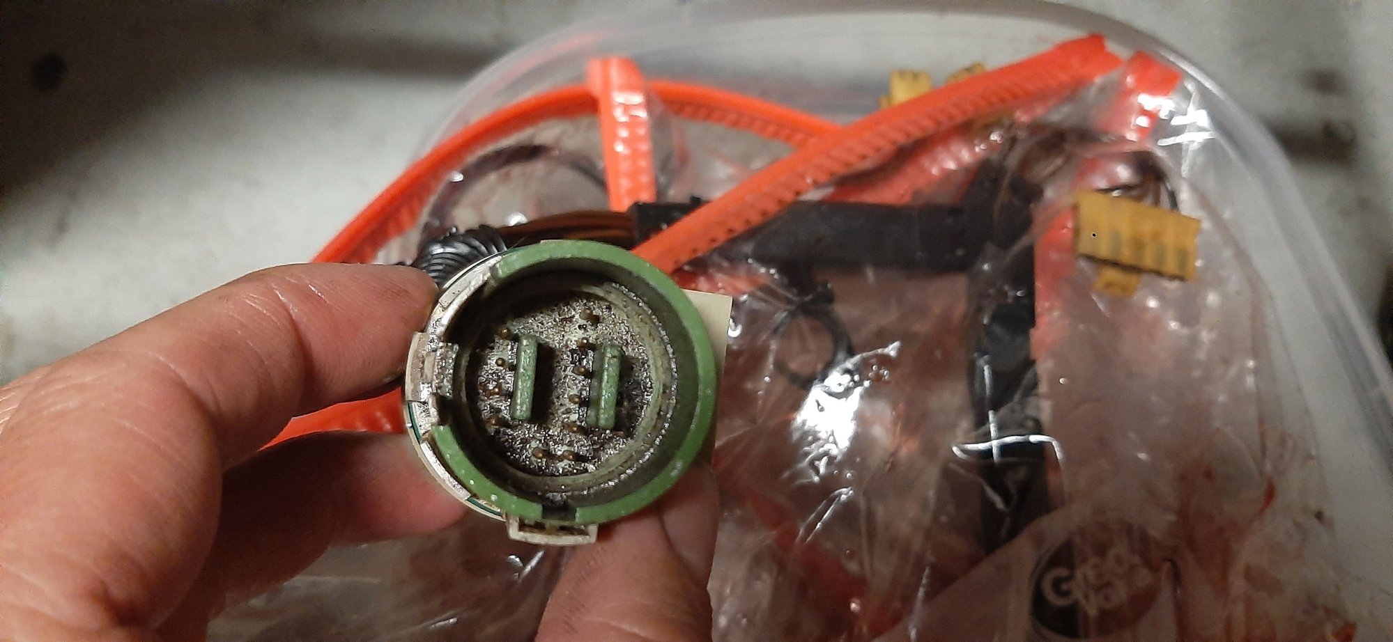

Curious, the donor transmission is from 2005. Harness is green circular version. This is going into a 2001 Chevy Tahoe with my original P01 PCM.
Will this harness / connector be compatible?
Found a post HERE slowly trying to digest it so I can figure out if female (PCM) side of harness is compatible / pinout is same or reverse compatible.
13 Pin 2005 4l60E connector from donor transmission

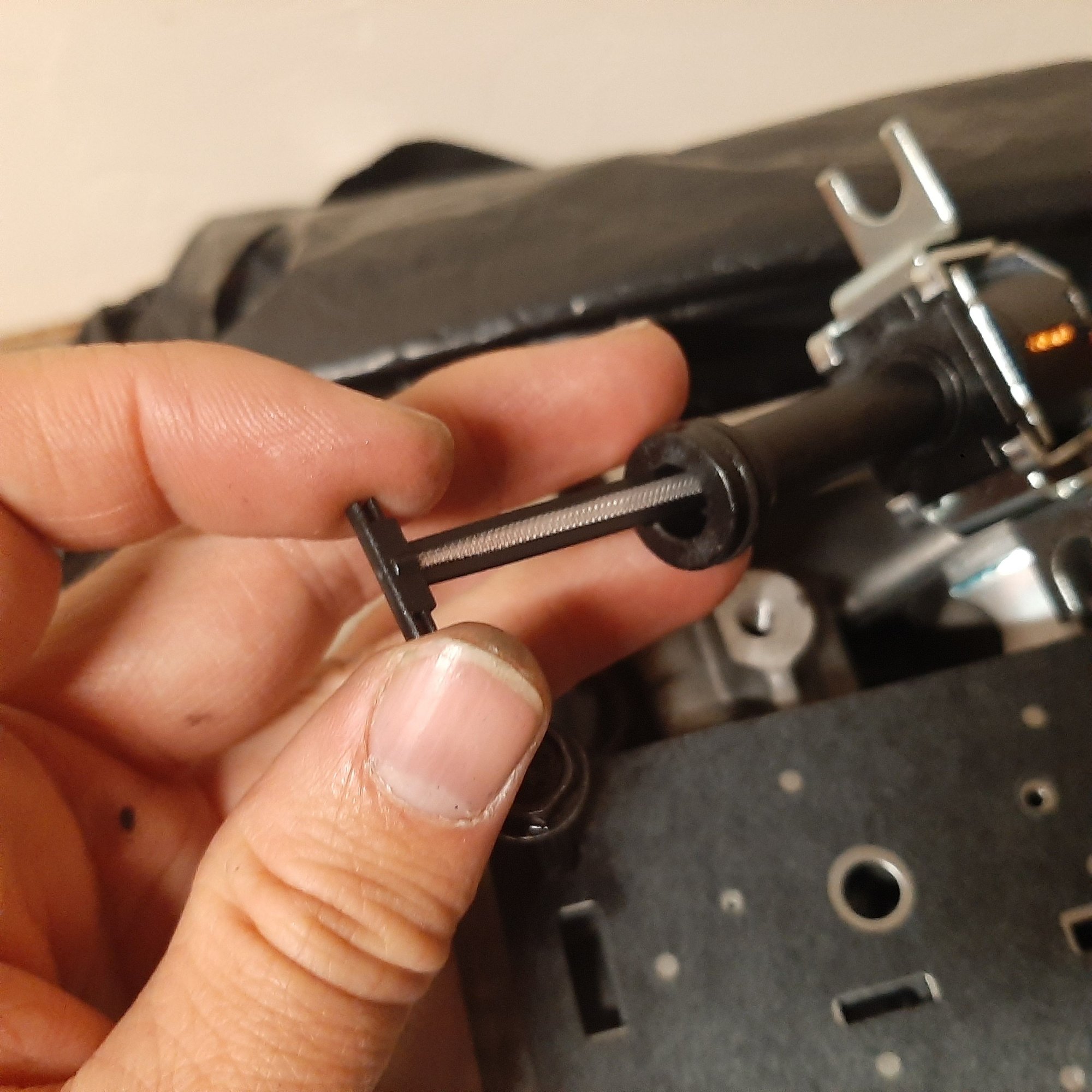

Awesome, I ordered a harness. It's Rostra 350-0061. Linked here: Manufacturer's Webpage & instructions
The TCC lockup solenoid doesn't have a provision to lock in the filter screen. It's a different style from factory. Anybody know where I can get a filter screen for solenoid?
No provision to lock in the filter screen / doesn't fit all the way in.
TCC Solenoid filter screen from kit
Old Apr 1, 2022 | 10:41 PM
  #348
bbond105's Avatar
Joined: May 2012
Posts: 3,047
Likes: 714
From: Poplarville, MS
I it didn't come with a screen I wouldn't worry about it. I run them all of the time without it.
If I ever have a problem do I risk metal shavings going through the rest of the transmission?
I looked quite a bit and seems they are all making earlier style solenoid that has screen filter in case. Or does this have a screen built into it somewhere?
Old Apr 2, 2022 | 07:54 PM
  #350
tayto's Avatar
Joined: Jan 2013
Posts: 463
Likes: 179
the screen protects the solenoid, not the transmission. the 700 tcc solenoids never had a screen FWIW.

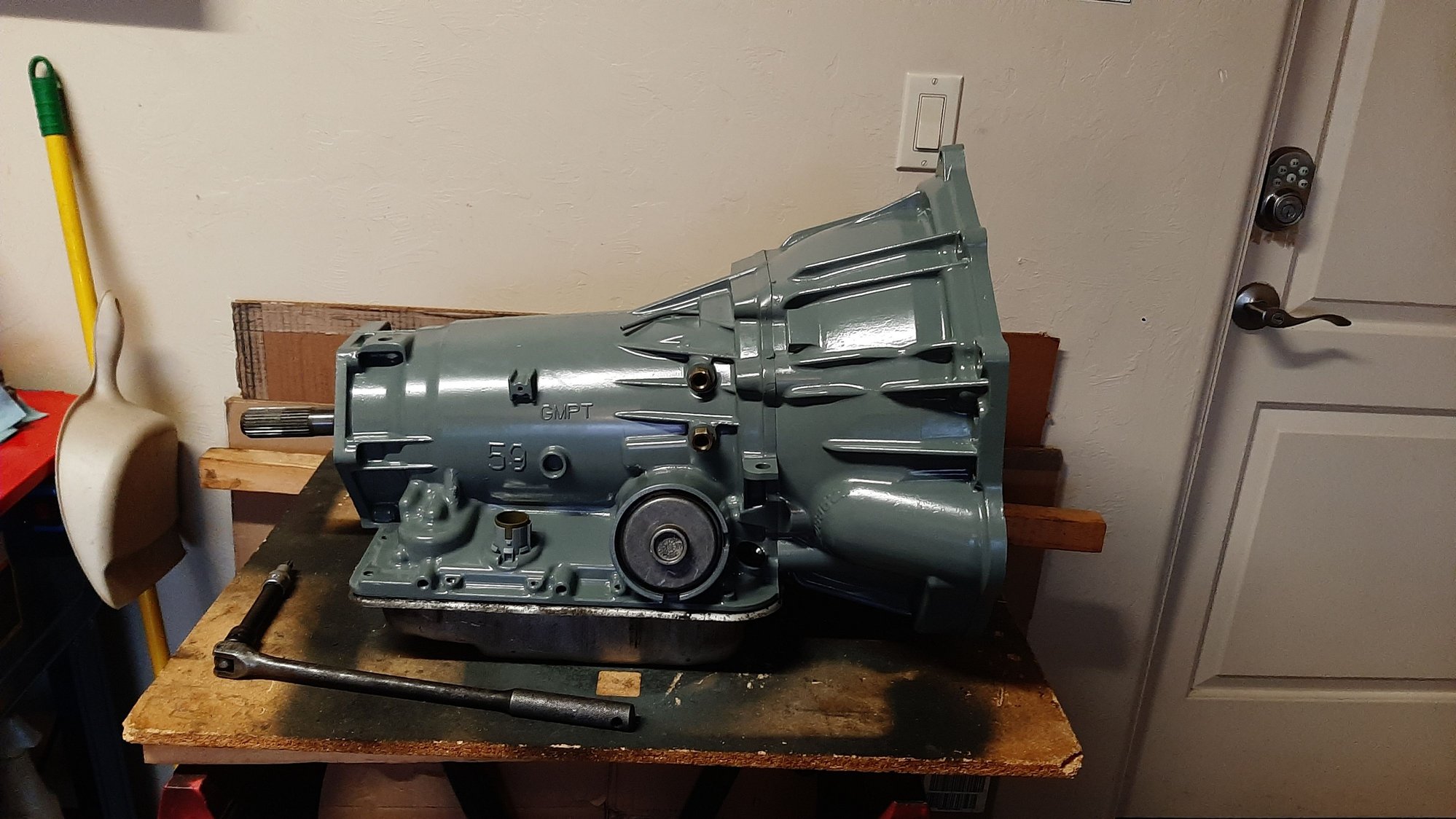

All the pieces are put together! Minus haha a pan gasket and the filter. Curious, my pan is missing the magnet. Is there somewhere to get pan magnets from?
Also there's no dipstick limit bracket. I'm assuming this newer pan style doesn't need that?

Got caught up in work again. Just now able to resume my project. I'm getting ready to swap the transmission into my truck. Curious if there's any little last minute checks I can do with it assembled.
I was double checking the sprags were installed correctly... Which way should I be able to spin the input and the output? And in which gears?
1,2,3 forward sprag?
not sure how output sprag works from perspective of case. facing rear of case I can spin the output shaft counter clockwise.
Any other sanity checks as it will be in truck hopefully by end of next week.

Transmission is in the truck. Each week I get a few hours where I can work on it... Hopefully will be spinning it soon! I just need to reinstall exhaust, driveshafts, hookup and torque down transfer case, put fluid in it, and lastly a little tuning before I can run down the road.

Well it's in and works like a champ. Between work (I'm self employed, two businesses, and three jobs) and ordering parts took WAY longer than I'd ever hoped.
In full disclosure, I didn't modify the valve body. I know we had a heated debate on that here but had my reasons, and is simple enough to change mind on / build another valve body. I'm glad I didn't modify the valve body. It shifts like it means it, quickly and firmly. Maybe a bit too firmly but I think I can dial that down in the computer / tune.
Pulls a bit differently off the line. I assume because of torque converter. I got a Circle D 278.
Anyways, some closure to this really long post. Thanks everybody for the tips, conversation, and participating.
