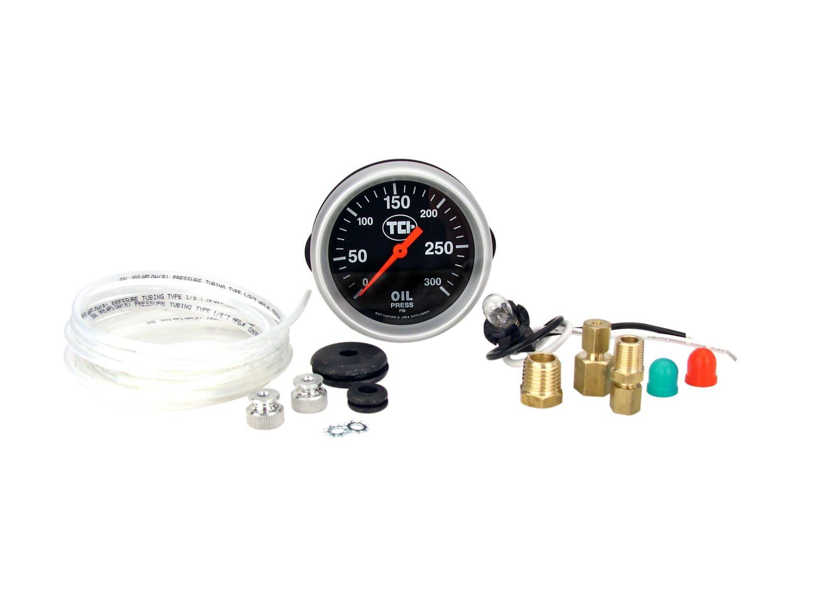

TCI (actually AutoMeter) has both sizes in Black or White-Face (300 Psi):
Stewart Warner, and VDO also have multiple options.

Thanks everybody... when I remove "electric" and "transmission" from the searches I'm finding much more choices--the big brand names are a fortune ($100-$175) but no-names and commercial brands and applications are coming in cheap for brand new 1/8"NPT & 1/4"NPT--some without illumination in the $5-$10 range. I think the best are 0-300PSI, they aren't as hard to read--less marks close & bunched up--and most of those are 20PSI each graduation mark (tick?) I'd like to go with a rear fitting. I am not sure how much room is in the tunnel on an XUV and if there's enough space for an electrical sender.

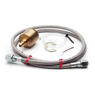

The only way to safely run a Mech. Instrument in the Passenger Compartment (safely, the way NHRA permits) is with a Fluid Isolator.
Oil acts on the Isolator outside the Cabin...
A Hose filled with a Non-Flamable Fluid, enters the Cabin and acts on the Instrument.
Autometer 5282.

OUCH!!! $158 + tax!
Plus the gauge... plus the tubing... Looks like I better find an electric gauge & sender or a $10 mechanical gauge & some floor mats!
