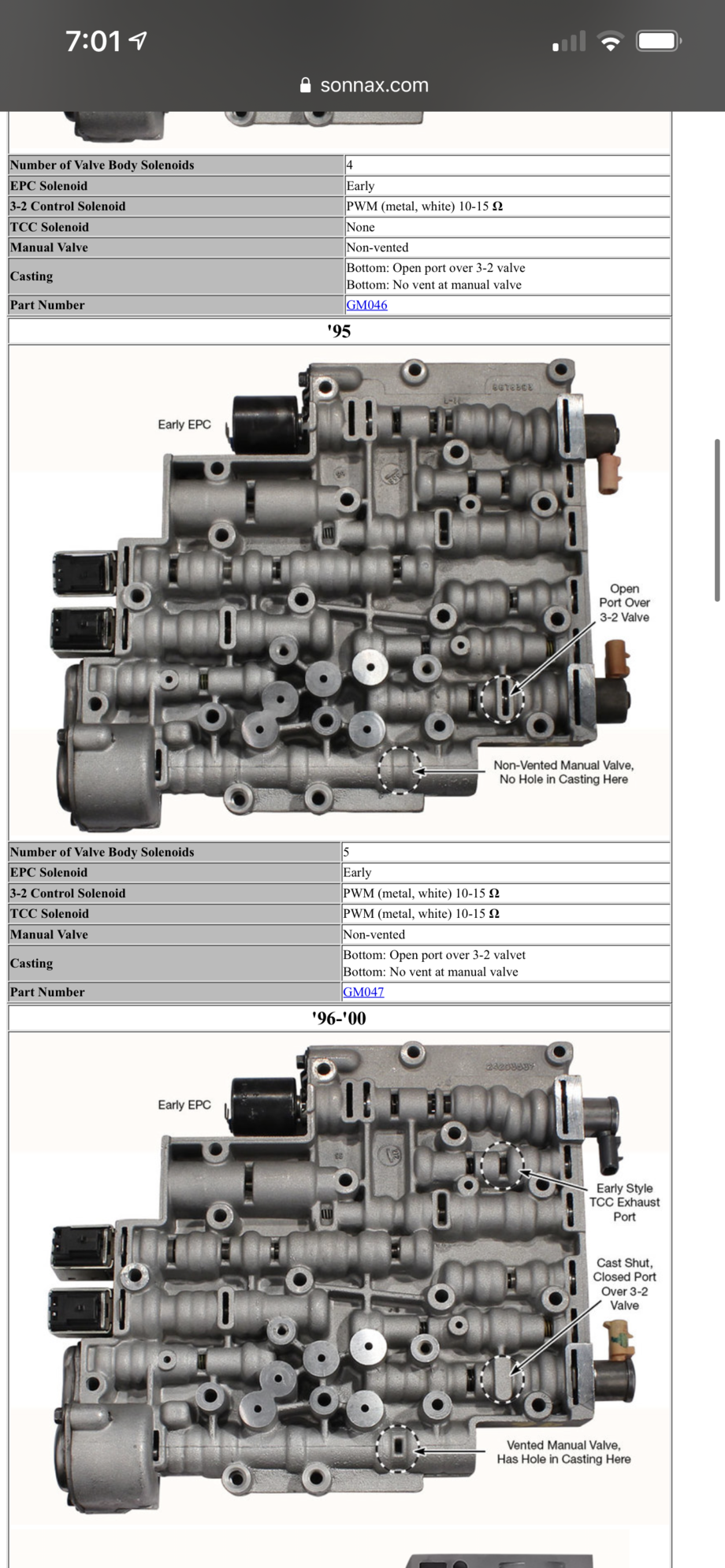

The valve body I bought is older and has one difference that I can see. And Sonnax has it listed on their site as well. The screen shot I am attaching to this shows the differences between them. If you think I can swap the VBs out and test the older one, let me know.
I have the bottom one installed (original) and the top one is the older one I just bought.

1995 is a one year only VB, not sure if it would work or not but I would just fix your VB. You are really shooting in the dark here without vac or pressure testing. your VB could be worn beyond a drop in fix. do you have access to another PCM? Might be a thought to rule out it out.

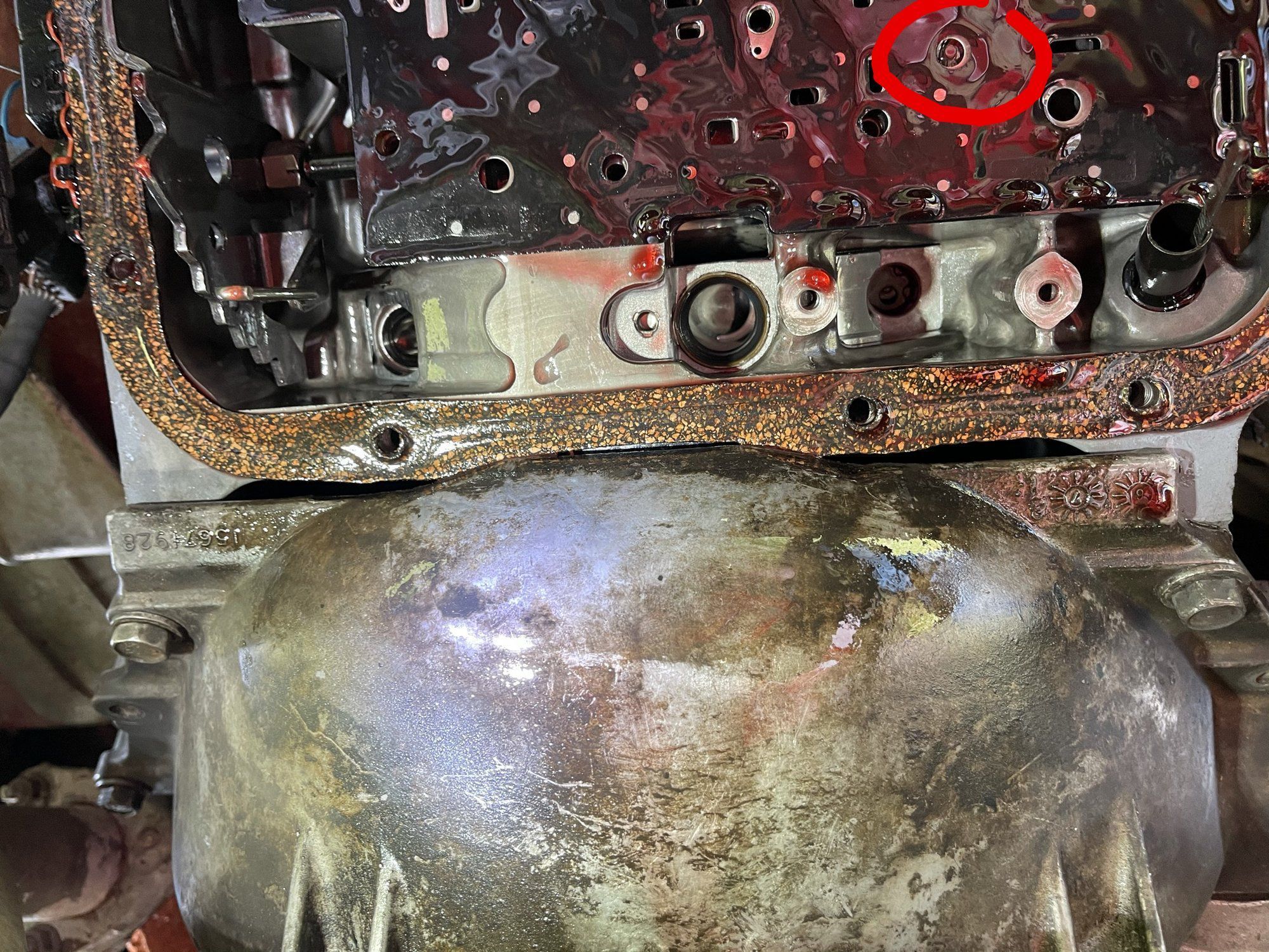

looks like it has the correct lower valve body gasket (round hole not square). not sure if you peeled the gaskets back, but they should not have a white stripe on them.
