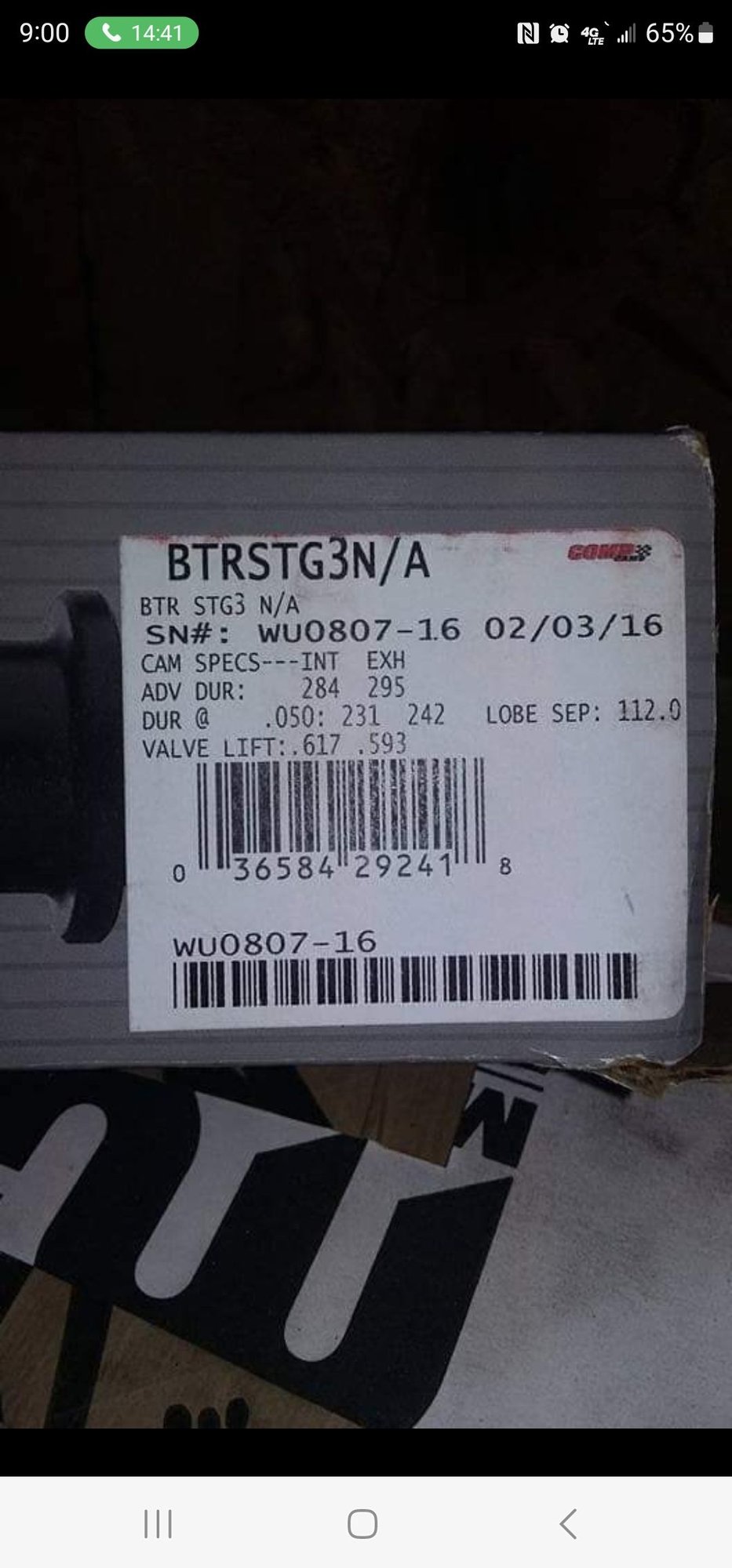

Gonna be running a 6.0 LQ4 with TEA stage 2.5 heads and a BTR stage 3. Swapping from a buddies 6 speed car to my auto. Ran great in his 98 SS car. Mines an 01 Z28. 3.42 rear. Full weight car. If I post this right I'll include a photo of the cam card. But long story short, what's a ideal stall to run with this setup?

Simple solution man call one of the better companies who make stall converters and tell them your setup and they will get you right. You will have a thousand different opinions on here

4000 +

^^^ agree, 3600 absolute minimum. Contact Yank and FTI.

Agreed on the minimum but honestly 4000+ is the better route. My SS3600 left a lot to be desired when I had a cam similar in size to the BTR3.
4-4400 would be what I’d go with. Gears will help it feel tighter too if the OP doesn’t have them already.

The reason I posted 3600 absolute minimum is because many 'newbies' to the torque convertor stall realm are terrified/frightened of high stall numbers. Yes, 4000-4400 would be optimal.

Datalogs, or better yet, a dyno run graph would show where the torque comes in on this motor and make this a very easy decision. Especially since it was in a 6 speed car. Do you have access to any such data?
