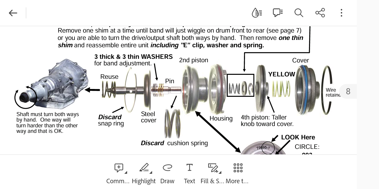

With that small of a stall unless you live in a hot climate, I wouldn't worry about adding a cooler, but it wouldn't hurt. Did you check the servo pin travel during the rebuild?
File Type: pdf

Well the last bit of the servo will not come out with the trans in the car, I even had it completely hanging and it's very close but no cigar. I'm going to slightly dent in the floor pan. So I had bought the extra servo because I anticipated finding a junk yard replacement so I'm not sure at this point which one is in the car and which is lying on the floor. What I did notice though is the one in the car has rubber seals, the one out of the car has scarf cut hard(ish) seals. The new seal kit I ordered looks like the hard ones, and I just found a bag of the same scarf cut seals from the rebuild kit. So does the one in the car have the wrong ones and if so could that be my problem?

I did not check it no because I didn't see a need (stupid I know) because I assumed (I know the saying) that since the servo was fine before and it's not a performance band or anything that nothing should change with the servo pin.

If I've learned anything about these transmissions over the last few years, is that clearances make all the difference.
The band clearance was probably way out of specifications before you even tore into this thing, but now, with all the changes, you are seeing the results.
Measure the servo pin clearance, if possible (I know it can be hard on an F-body). It's totally possible to make a "worn" band/ drum assembly work if you just tighten the clearance by either using the long Sonnax pin (and grinding it to fit) or welding the tip of the servo pin, and grinding it to fit.

To remove the servo from a trans in a F-Body you will have to remove the crossmember and let the trans hang down in the back. Then remove the servo one piece at a time, cover, 4th piston, pin, and so on. Which 2nd apply servo is installed in the trans? Different brand servos use different types of sealing rings.

That's exactly what I did and it's very close but the pin still catches just enough to not let it come out. So it's either oem in it or Phoenix transmission. I was watching build videos last night and they all used teflon seals and the one in the car is definitely rubber. Also to add to the list of mix ups I'm pretty sure the one that gets the red seal has the blue seal on it.

If you have 4th servo out, remove the eclip from the 2nd servo and then washer and spring, Then puch pin in and pull second servo out should then clear the you can remove pin by itself

i don't think anyone said it's not the seals. the servo needs to removed completely and inspect the seals. i would use the time waiting for the seals to see what your band travel is. as i said earlier seals and springs are not required for this procedure.

You should have measured your servo pin travel before you put the new sealing rings on. Then you could have ruled that out as the issue, saved time and possible some money. Now this will be eating at the back of your mind until you do check it.
By the way the Sonnax pin will not fit right out of the package, you will have to grind it to the proper length. So, you will have to check the pin travel.
