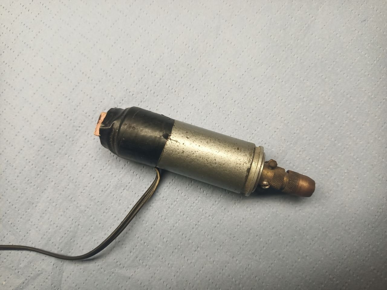

1-I would not block the hole in the rev piston but would down size it by whatever the amount your corner hole is. - I am assuming you must plan extreme high rpm and doing this to avoid centrifugal apply ?
2 - 3-4 I would keep release check valve but block the little orifice bleed plug in drum and drill the corner is possible to no more than that size. That way the expected fluid loss would remain factory but accomplish your goal.
Curious see pics of this and how accomplished as I have had no luck at drilling either of those in holes that small . Though never did the rev drum as didn't see as issue with exception of tranbrakes as I think the spin up on released and resulting wall climb is what I have noted causes the rev frictions to have burnish on them when used with brakes. Just could not figure a way to drill/
The 3-4 also is a great Idea i wanted to do but could not geta clean drill on it as to me my drilled wont fit inside drum and figuring out the position to drill from outside and land in the right place from outside i had no success with. Either landed in wrong spot or broke tiny bit before coming through When I tried multiple times with an old drum I had .
I then decided larger hole with cup plug orifice put in from outside of drum would be easier . But then got busy and never followed up.
THE DOWN SIDE OF WORKING FOR SOMEONE AS I WAS AT THE TIME, THEY DONT WANT TO GIVE TIME FOR SUCH THINGS AND WHEN YOU WORK FOR YOURSELF LIKE I DO NOW , FINDING THE TIME BECOMES THE ISSUE.
Right tool for every job ) It can use drill bit from 0.01

I tried using my Dremel took it was taking forever and kept over heating , I see you have some custom made device and for .010 a really steady hand lol
It was bought for DIY electronic plates when I was at high school decades ago ) And still helps a lot if I need to make small hole in difficult to reach place
