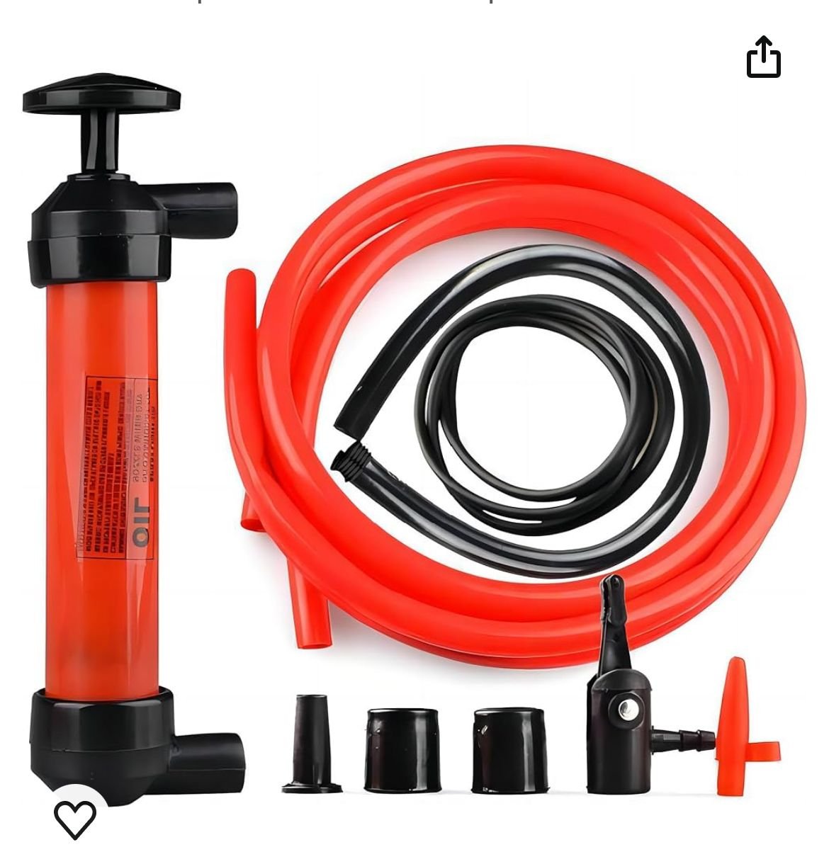

But off topic. Just another suggestion, If you do pump fluids trans or other out through tube on any regular basis this little guy works real well and is handy to have , It and some clear 5/16 or 3/8 plastic tubing(cold not hot) from hardware store makes quick work of it.
Amazon Amazon
I use one of them to pump used fluid through a large desiel fuel filter to clean it so can mix with kerosine and heat my garage, saves me a small fortune in heating cost and lets me get rid of the oil collected from cores and carry in units to be built. I mix 25 trans to 75 kero works well with little odor and burns alot hotter again sorry off topic tangent I am bad for that.
