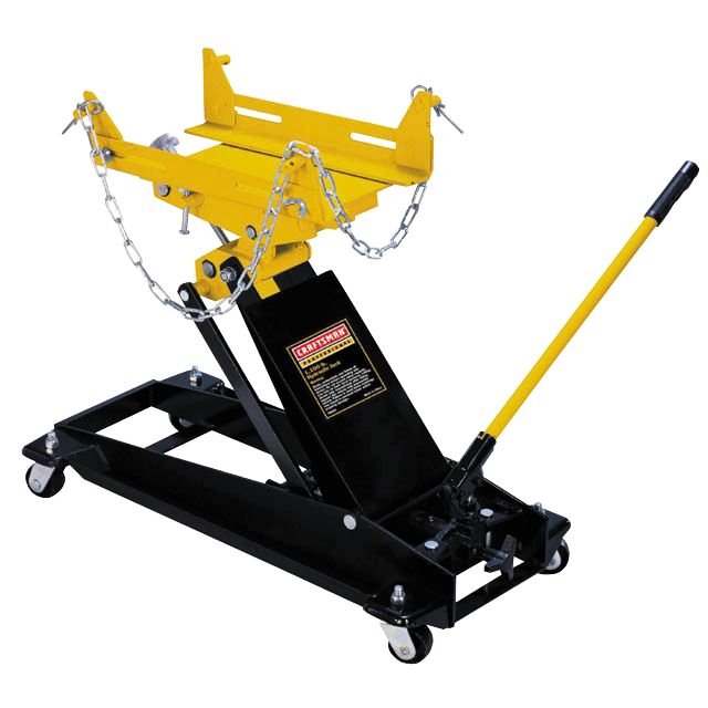

Originally Posted by King James
If your doing it on the ground I wouldn't recommend doing it without at least getting the attachment for your floor jack that will allow you to raise and lower the trans.
Where can you get one of these...?
Old May 4, 2006 | 08:22 AM
King James's Avatar
Joined: Feb 2004
Posts: 838
From: Terre Haute, IN
Here is what it looks like. I've never looked into buying one because I have a regular tranny jack and a lift but I'm certain you can just purchase the attatchment without having to buy the jack to.
