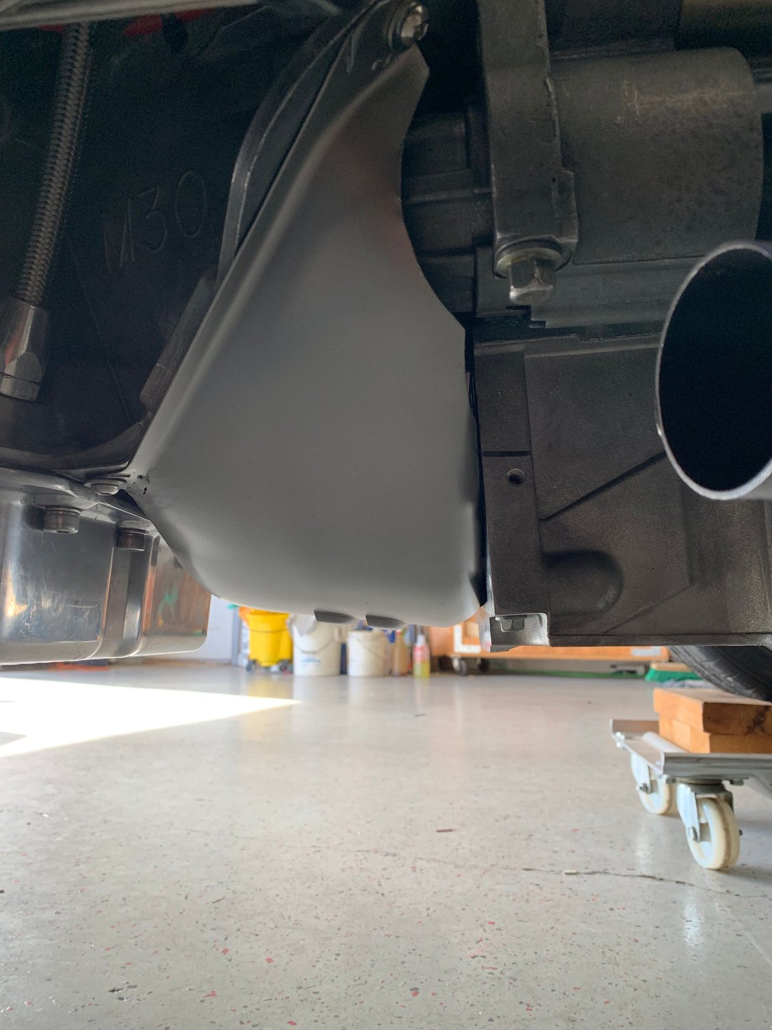

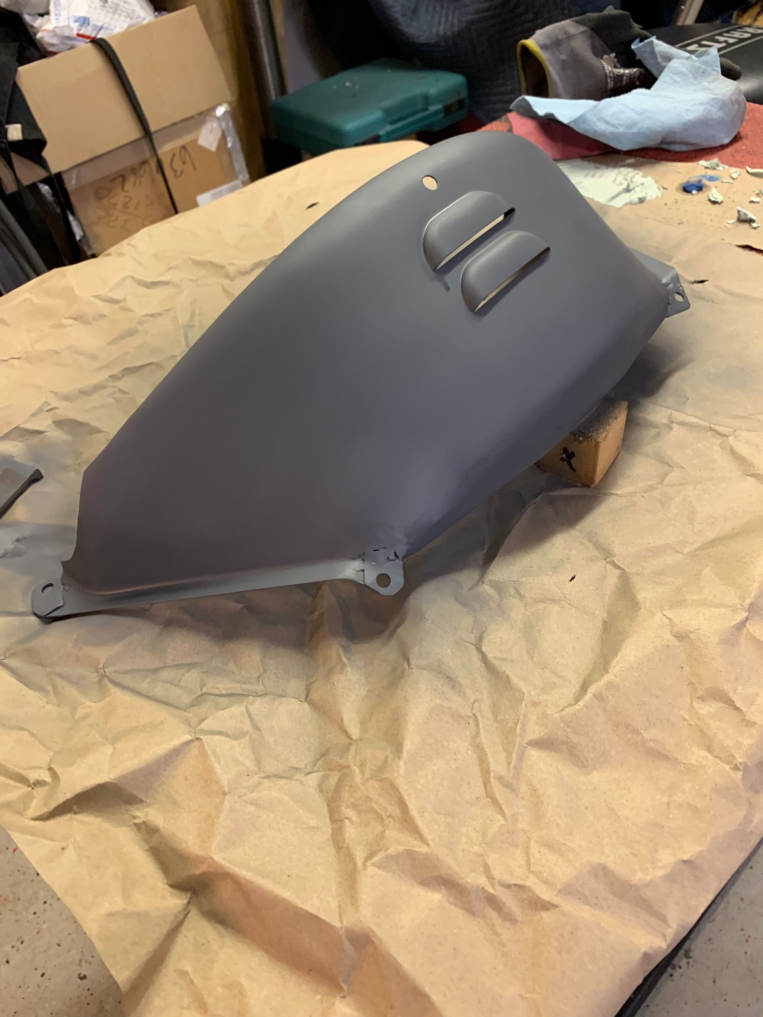

Those that want to run a flexplate cover on their LS engine with a one piece housing transmisson.
Start with a 700R4 metal dust cover from Summit Racing Flexplate Dust Covers SUM-G3883B. The motor side has
to be trimmed around the flexplate to clear crankshaft. The cover tabs that bolts to the transmission will have to modified to match the transmission. The starter cutout of the cover should be modified to clear the LS starter. The transmission cover side will require a sheet metal piece welded to it to completely cover the torque converter.
