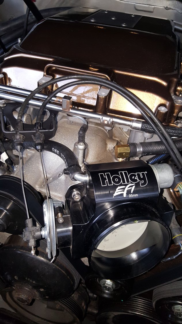

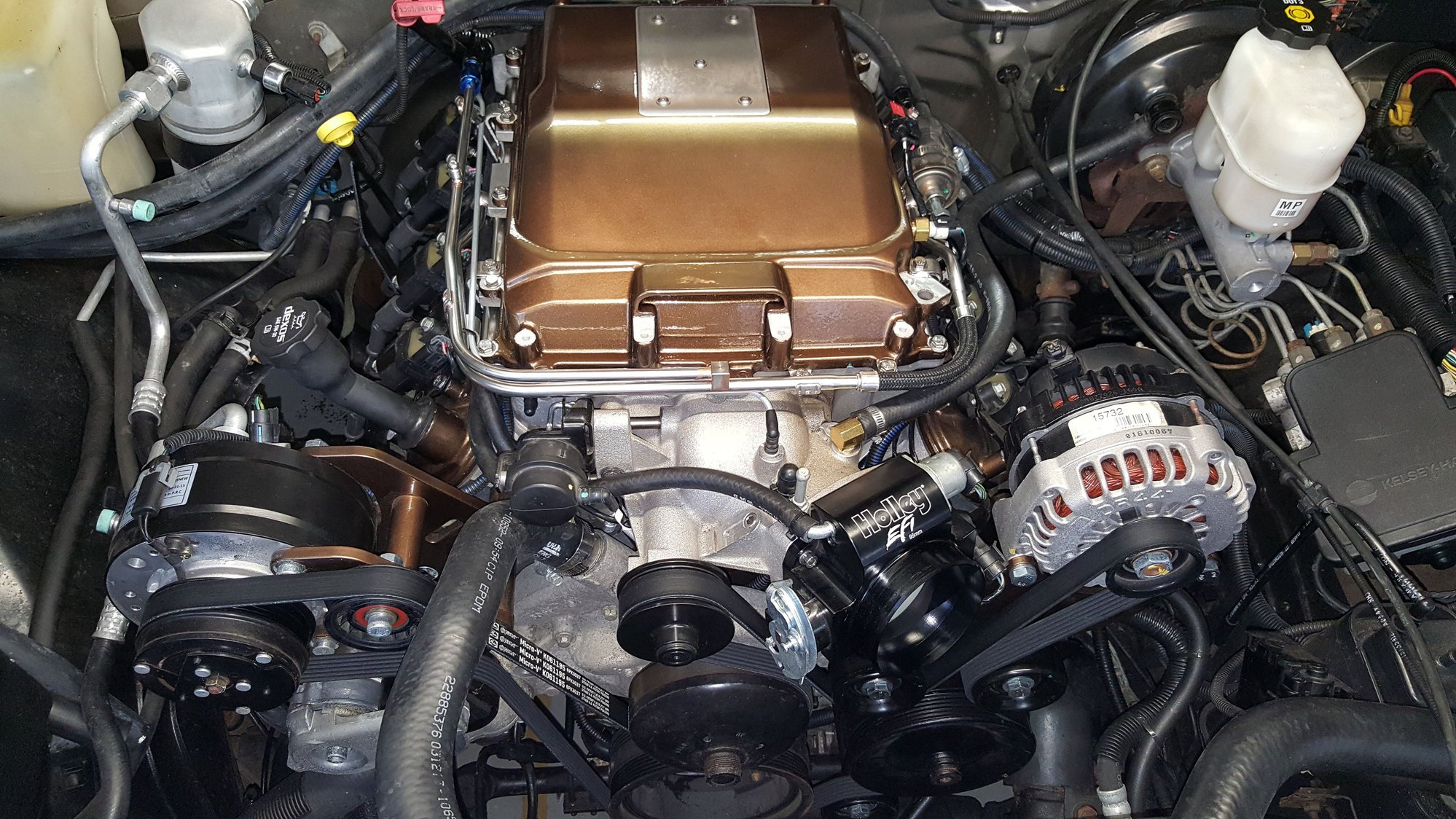

Decided to add some boost to the daily driver. Used Dirty Dingo top mount A/C setup, chosen because of the tensioner used. LSSimple accessory bracket that leans the truck alternator just enough to clear the throttle body. Switched to a SD tune, so far driven the truck around a bit on base tune. Going to dyno it shortly.

I was goiing to try to go down this route. Good to see that it works. I have Corvette accessories on the drivers side, I was going to use the Holley spacer to move them out to the truck belt location. What did you do for pulleys on the AC, PS, & Alt, did you change them to an 8 rib, or just use a 6 rib belt on all?

Trying the 6 rib for now, stock diameter blower pulley. Dyno will tell if there is belt slip, and I'll take it from there. My main goal was keeping top mount a/c setup I already had on the truck, and seeing if this arrangement would work out.

The pulley right below the throttle body, does that bolt to the accessory bracket or to the water pump?

It bolts to the accessory bracket.
