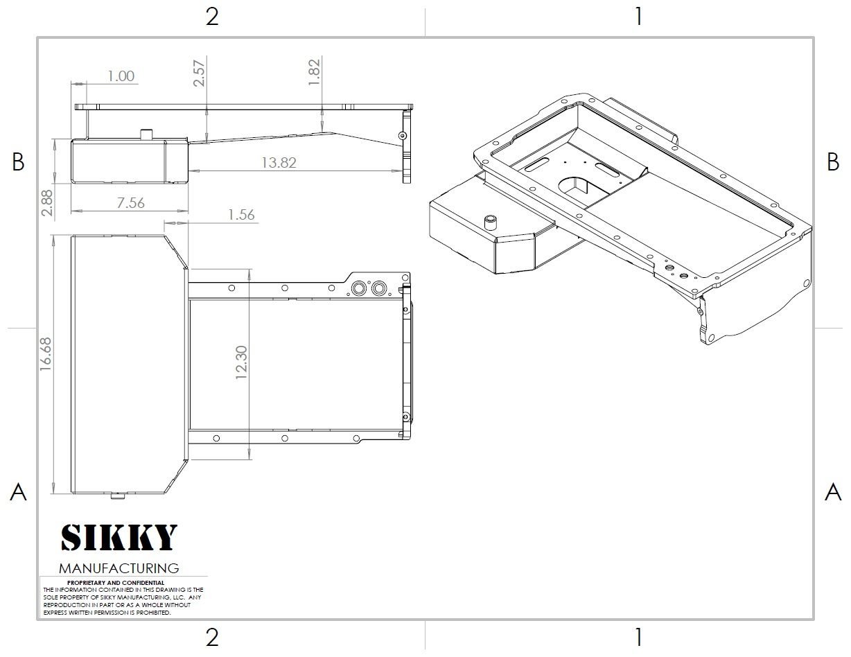

This pan may solve your issue for you. Its one of the pans we manufacture here for our 240's. The only thing is it will require you to relocate your oil filter (we offer kits for this additionally). The pan comes with the proper pickup and dip stick
https://www.sikky.com/product/lsx-oil-pan/
