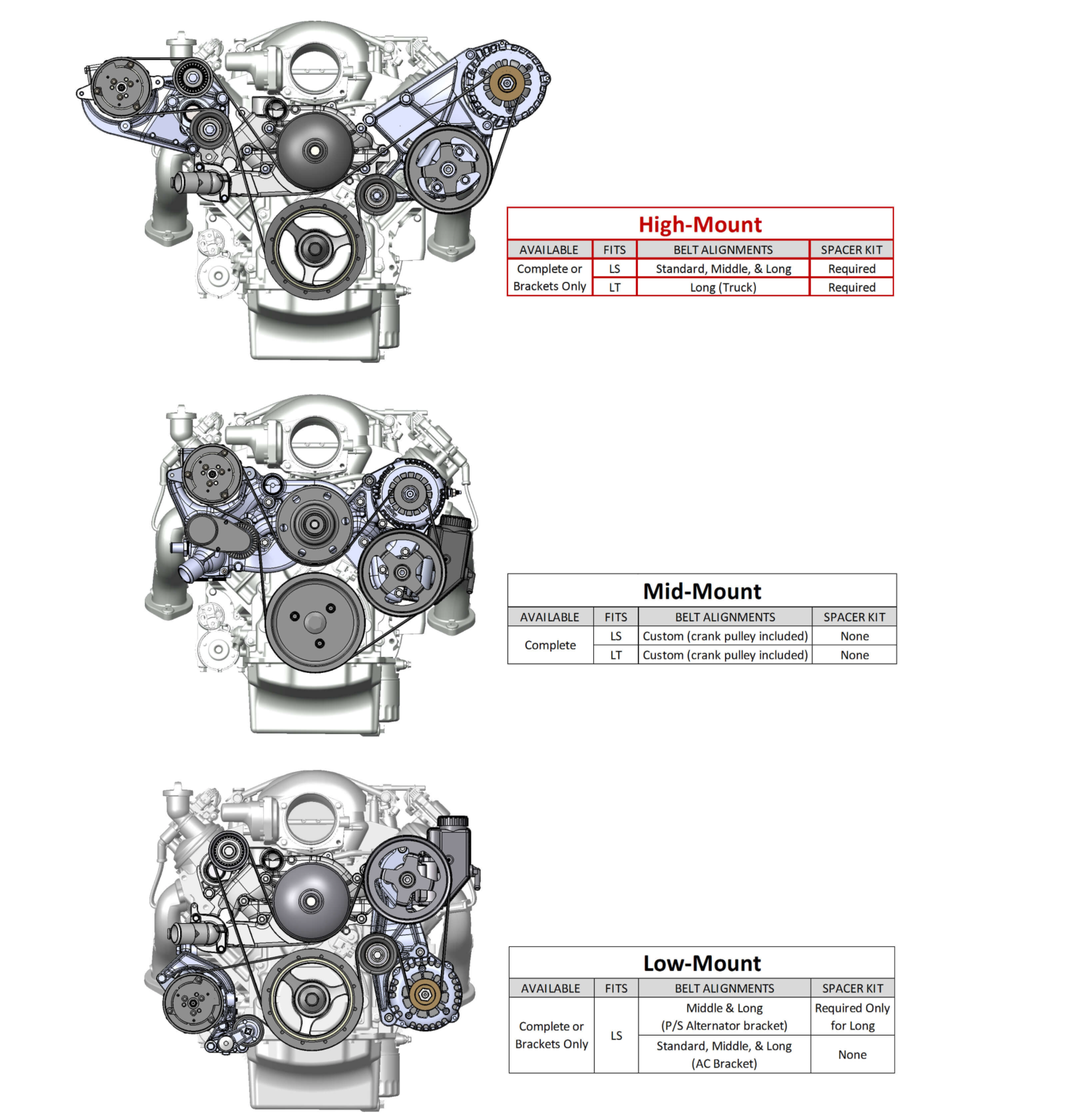

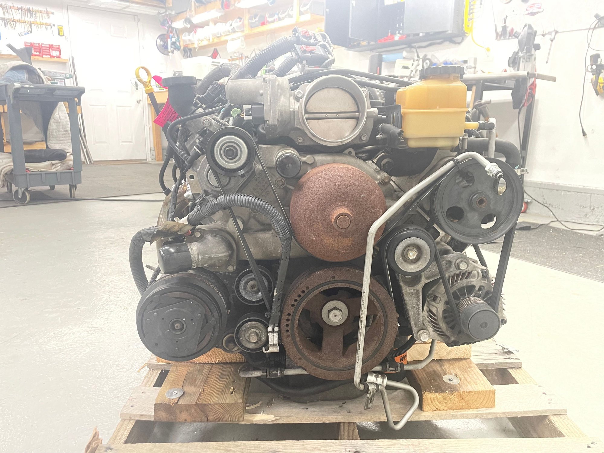

This is an old post, but I have the same questions... From what I can tell the AC compressor may hit the passenger side frame to be notched? Some people use F-Body accessories? Im doing an GTO LS2 into a 72 Chevelle. I'd like to keep the AC. Thank you for any advice-

Get the Holley A/C relocation kit. It puts the compressor higher up on the passenger side. Still uses Corvette spacing.
Use the Holley brackets, if you're going with an aftermarket AC like vintage air, they have a bracket that can mount the ac compressor low on the passenger side. GTO accessories are about the same as F body accessories, you may have to swap out to the smaller f-body alternator as the one from the gto may hit the steering box.

Thanks! So can I do the mid mount? And Lawrence are you saying the factory ALT might hit as well? Thanks for the advice, Im doing a build soon just trying to line everything up before I start. Great build thread by the way, I've checked it out more than once!

The low mount factory AC and alternator will definitely not work in a A body. I'm using the mid mount.

Holley stuff for accessories and motor mounts, cut the **** out of tunnel and get pedal bracket from Silver Sport or Bowler or whoever if you are going manual, get a driveshaft made locally. If you can cut and weld it's not too bad.

The LM7 truck motor with all of it front accessories completely fits inside an A-body as long as you use the Holley forward bias mounts and their Holley 302-2 or -3 oil pan. I'm also running the LM7 low mount AC compressor. No complaints, no snipping of metal required and a vanishingly low price in the junk yards.
