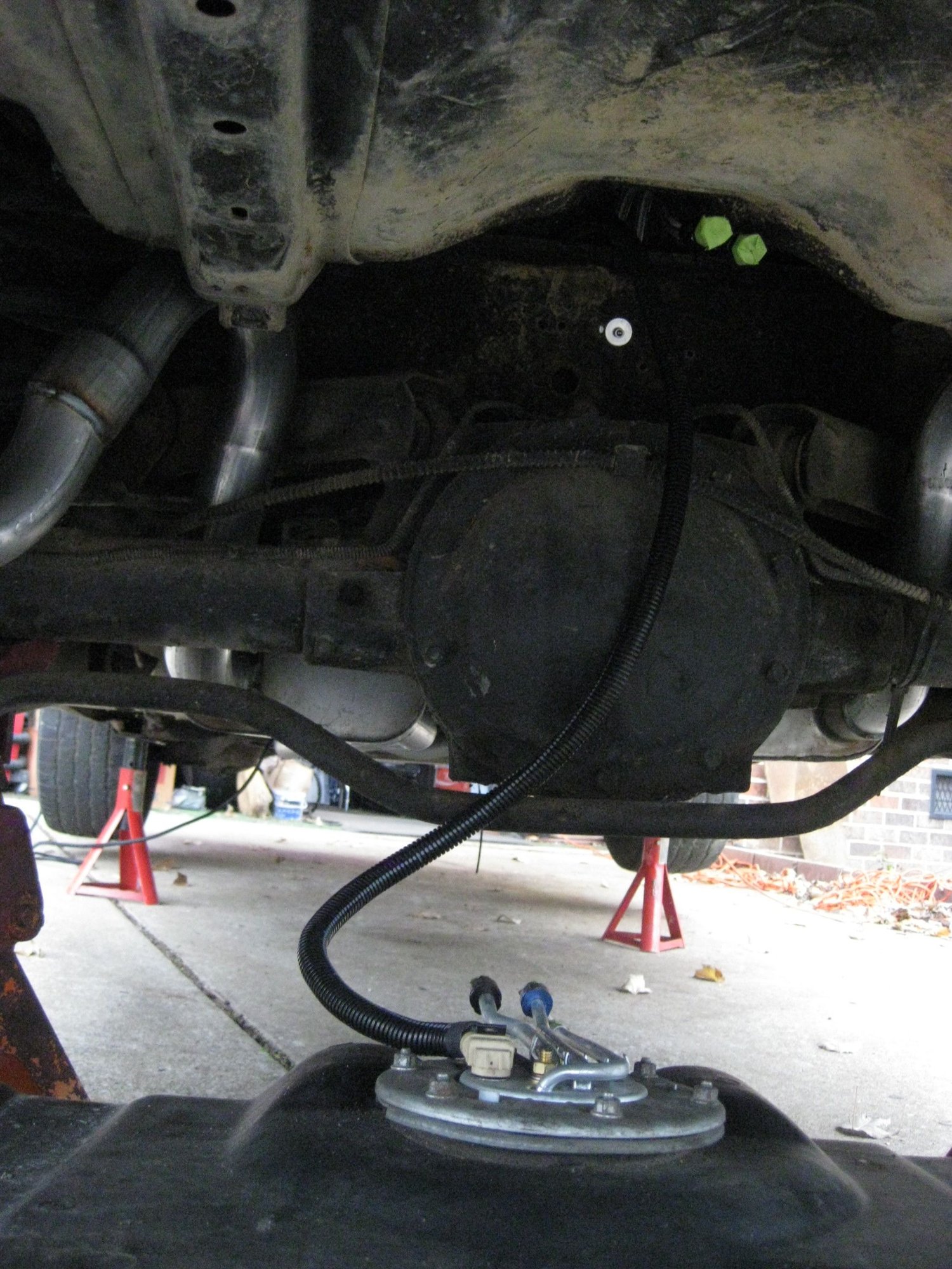

The car has 2:41 gears in it now according to the build sheet. I had thought it was a 7.5 rear end, but according to what I've been looking up it appears to be an 8.5 10 bolt (see pic below).
I know about as little beyond nothing as you can get about rear ends. If I rebuild this (assuming I'm correct and this is an 8.5, and I'll have a reputible shop install it) I can put a new limited-slip differential with gearset of choice and new axles and convert to disc brakes. I'm sure they make a kits to do all of this, but so far I've found there's about a million different types and options for types of differentials and axles. What are opinions on retaining the c-clips or eliminating them?

That is an 8.5". For 400 HP you don't need new axles or C-clip eliminators.
Many years ago I had a rat motored 72 Camaro that ran 10.90's consistently with stock axles, they're plenty strong for what you're doing.
