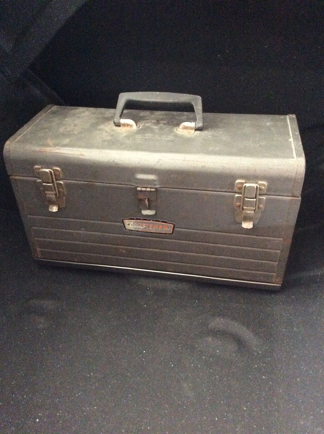

Battery box in the trunk

cool car. i love the battery box. i made one out of a .50 cal ammo can, and a lid modified to go on the side from a .30 cal box for an old honda i had. what is that color of the car? nice color.
